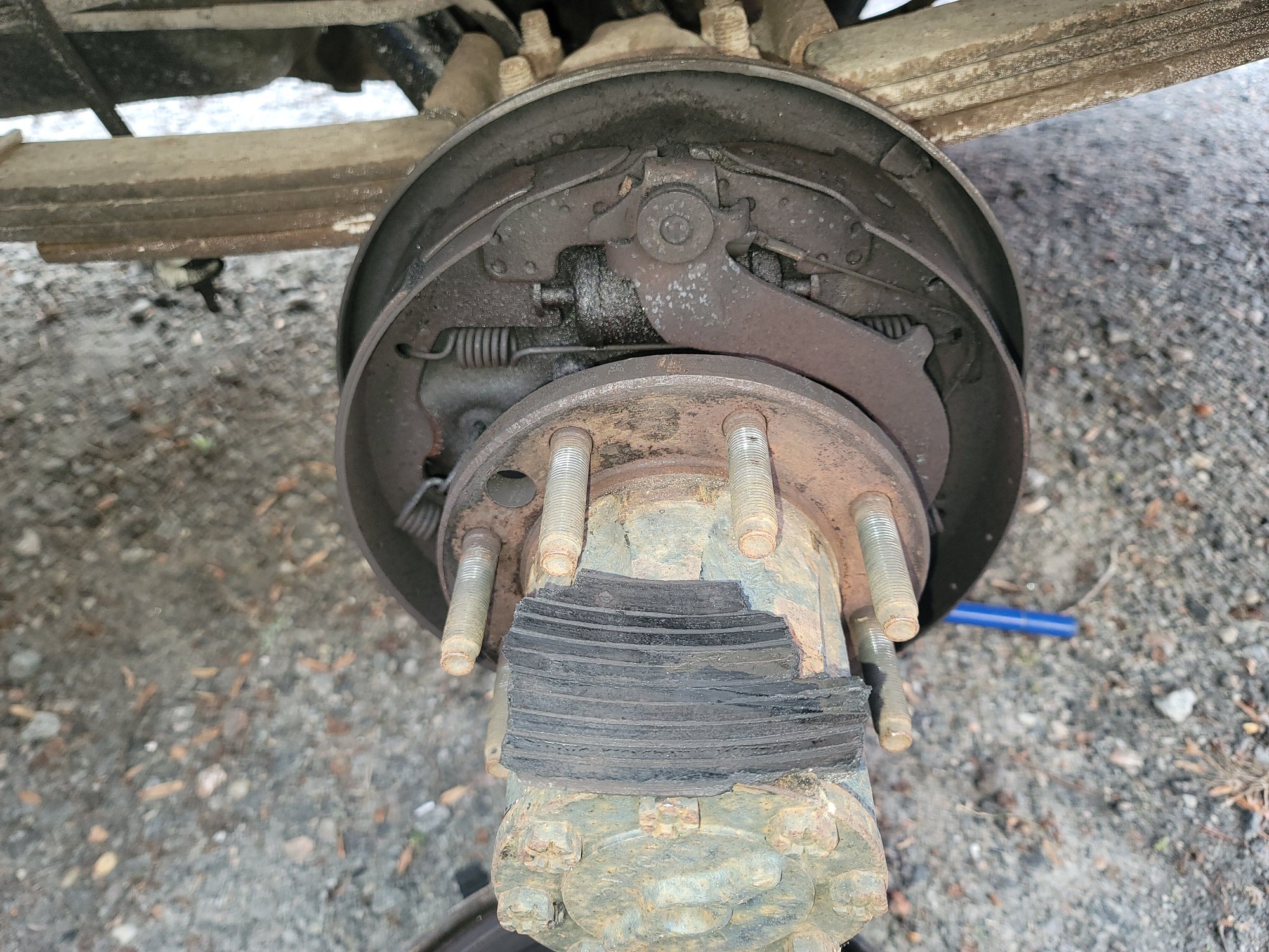

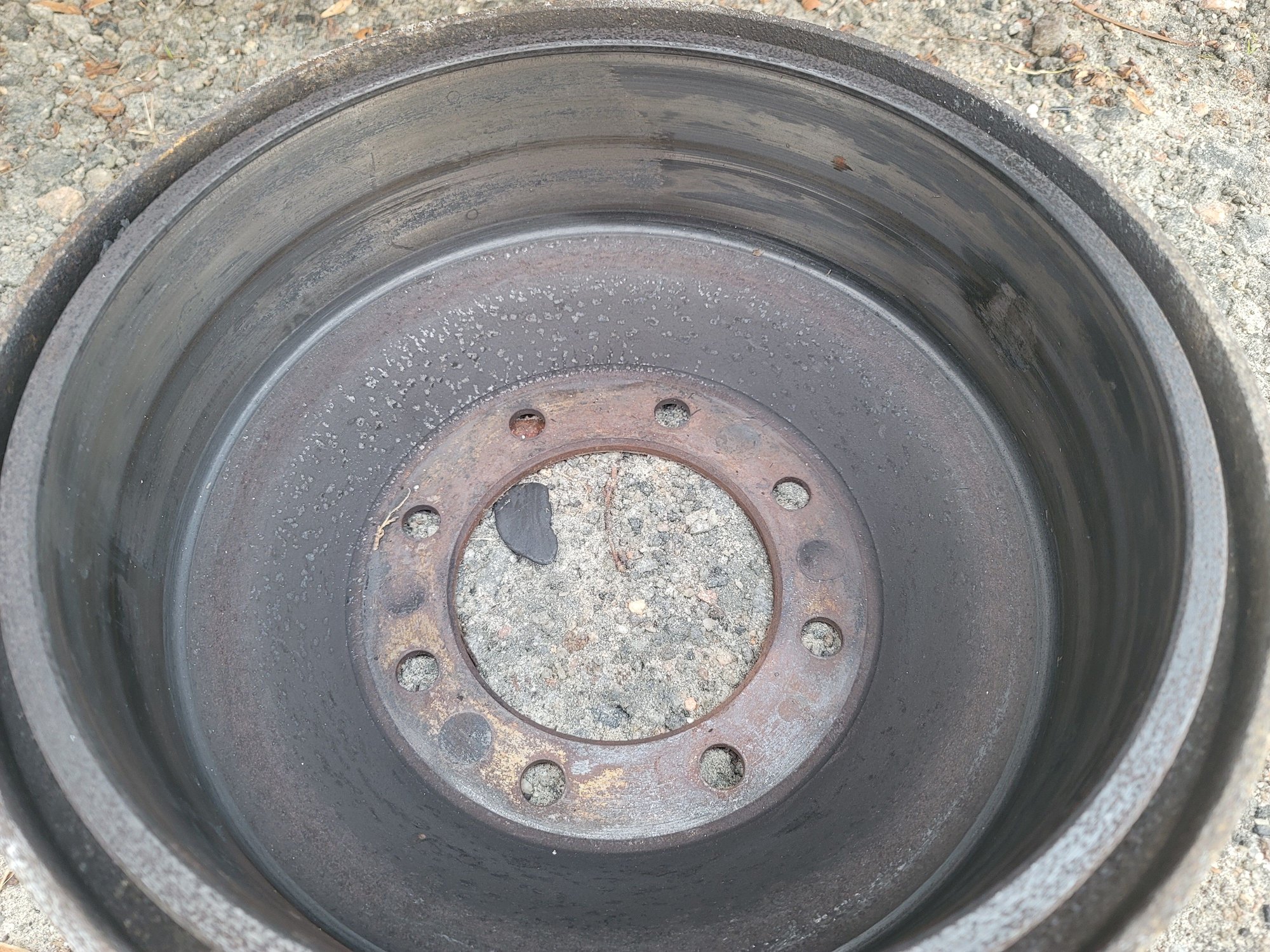

Pulled my driver rear drum today. Yikes. Glad I did, there's no shoe left! Absolutely soaked inside, good call on the wheel cylinder guys. Now. How does this drum look to y'all? Replace, resurface, or it's fine?

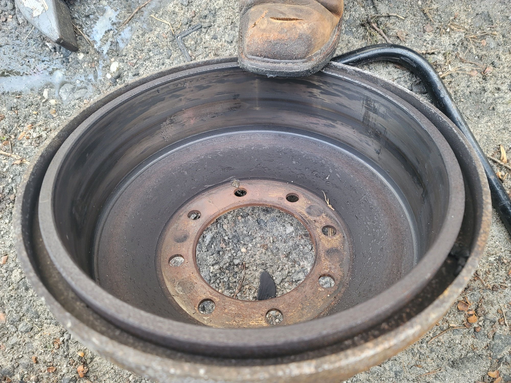

Update. The passenger side was even worse. There was no pad material left and there was a awol spring causing havoc inside, and it destroyed the drum, so new drums it is.
