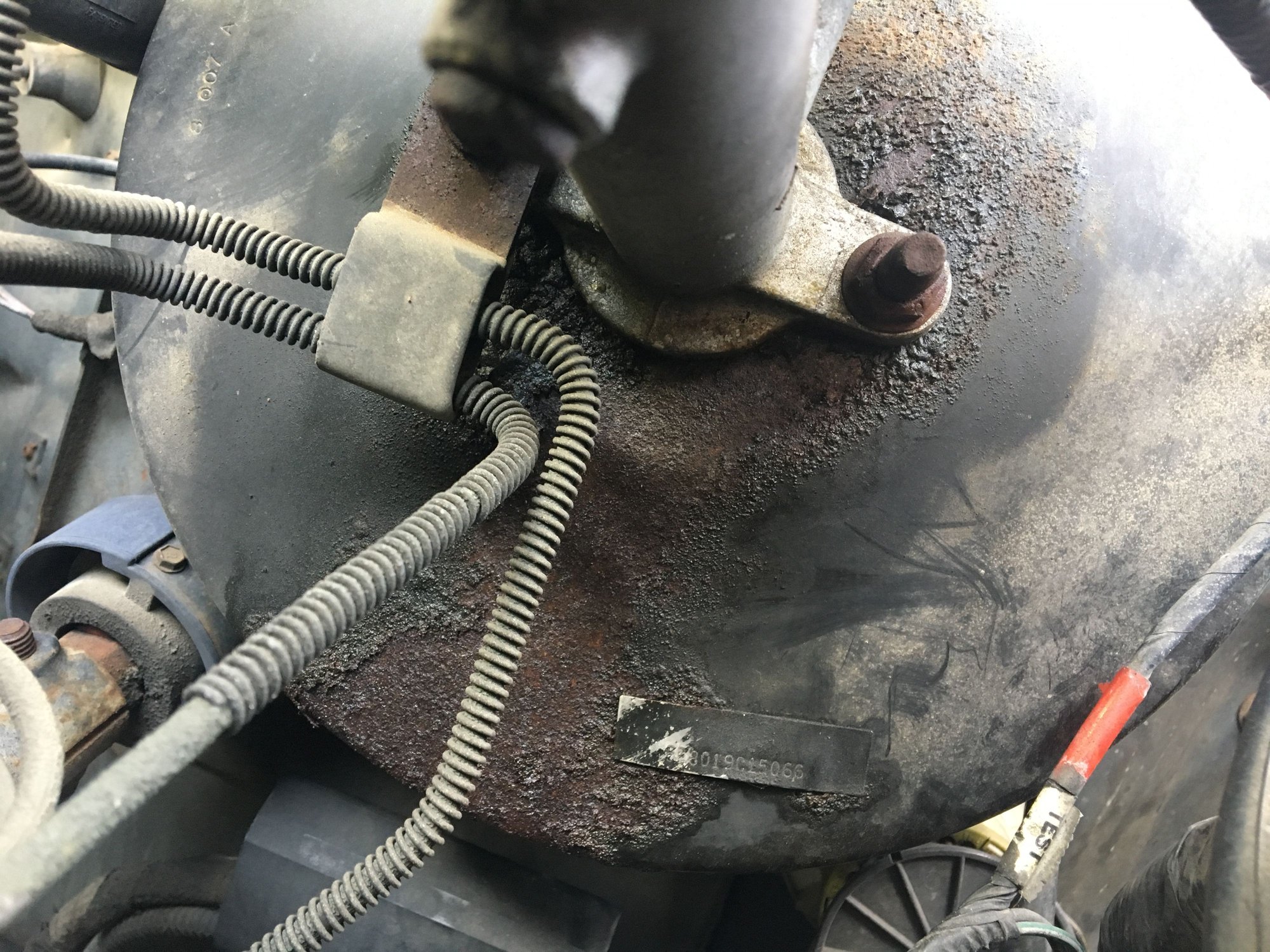

Thanks for the suggestions, glad I'm not the only one who's had these issues. Did some booster diagnostics (pedal pressure tests with engine on and off), checked the check valve and it all seems to be working fine. I also have corrosion on the front of the booster that I previously thought was part of the firewall/clutch pedal leak problem these trucks have, but could be an explanation of the brake issue.
Could the issue be as simple as a new gasket or is it better to just replace the entire master?

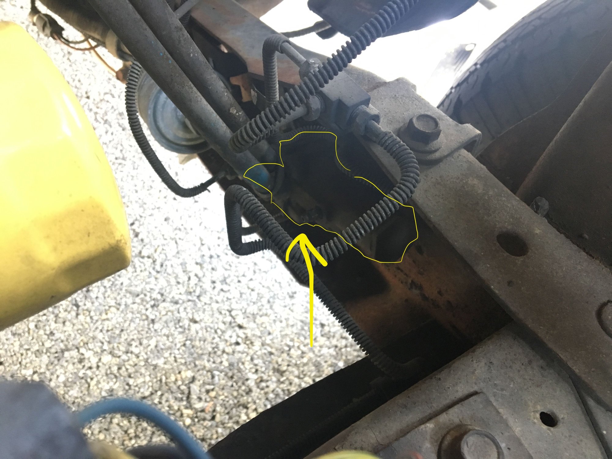

I also noticed another bleeder screw along the lines that I didn't see before. I bled the unit further back in the frame but never this piece:
Could either of these things be causing the anti-lock to quit working?

The brake booster has a diaphragm and they will tear. When that happens fluid goes into the booster and that's the leakage you see. the booster appears to be the problem.

Based on that photo I would say its time. Your Master Cylinder is leaking into your Brake booster causing issues. I just fixed this on the F350 at the beginning of the year. Brakes felt much better when I was done.

Um... That is the RABS module which begs the question: What ABS did you bleed in the first post?
There is no gasket to replace between the master cylinder and the booster. The master cylinder is leaking and either needs to be rebuilt or replaced.
