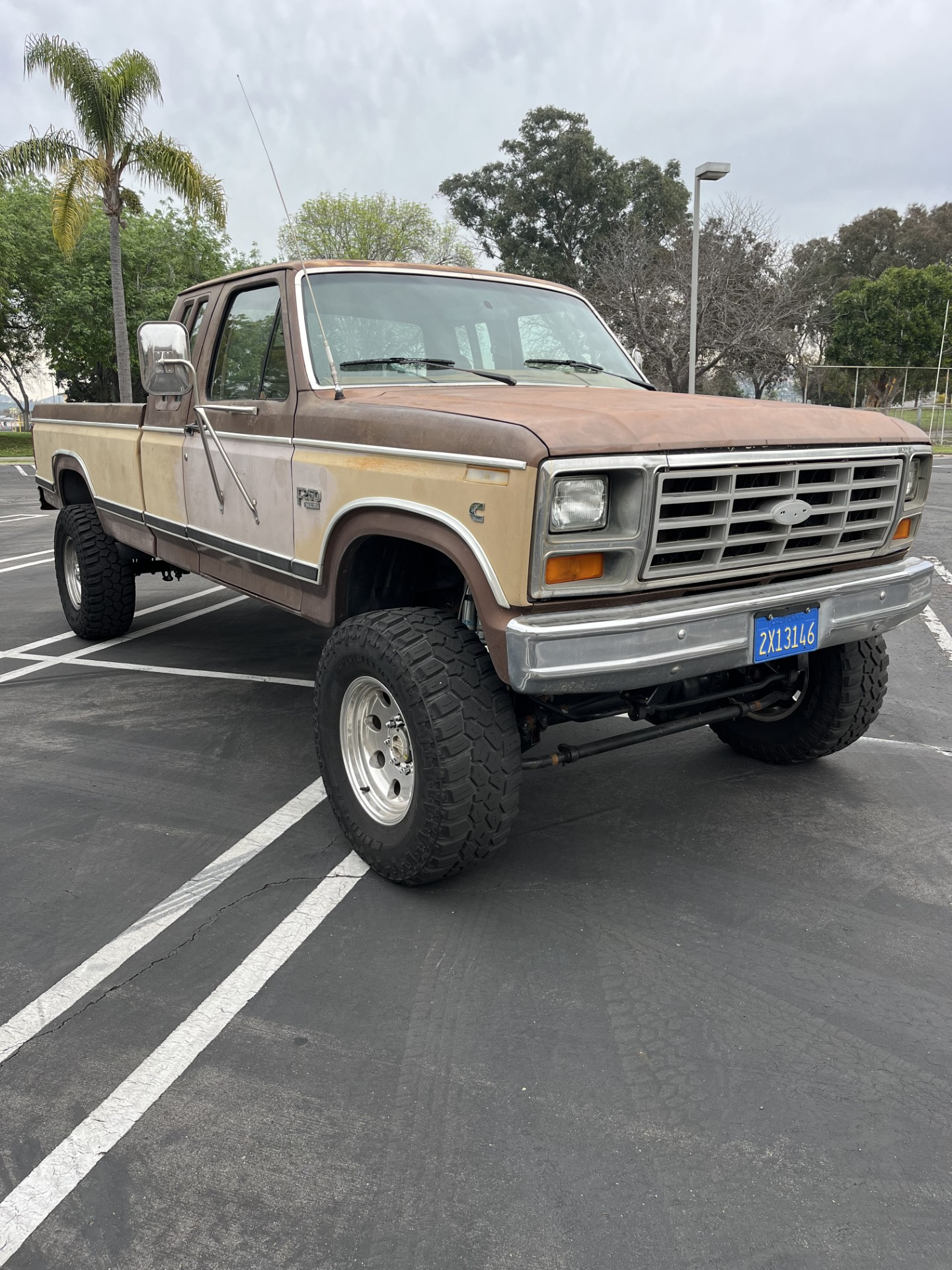

Miss my old Cummins swap, took about a year to complete with lots of frustration but was worth it!
