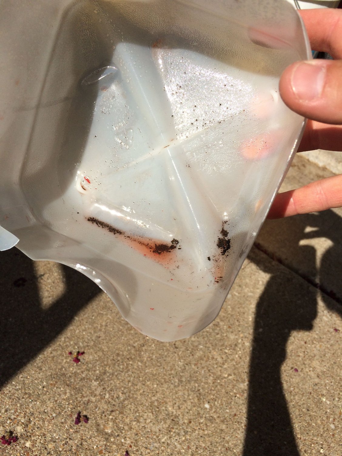

Absolutely, I believe in running a coolant filter. Have them on all of mine. You wouldn't how much crap circulates in the cooling system, even after a proper flush. Here's the kit I useRiffraff Diesel Coolant Filtration System / Filter Kit 99-03 - Riffraff Diesel Performance
This is the kind of debris I remove even after tens of thousands of miles of filtration.
