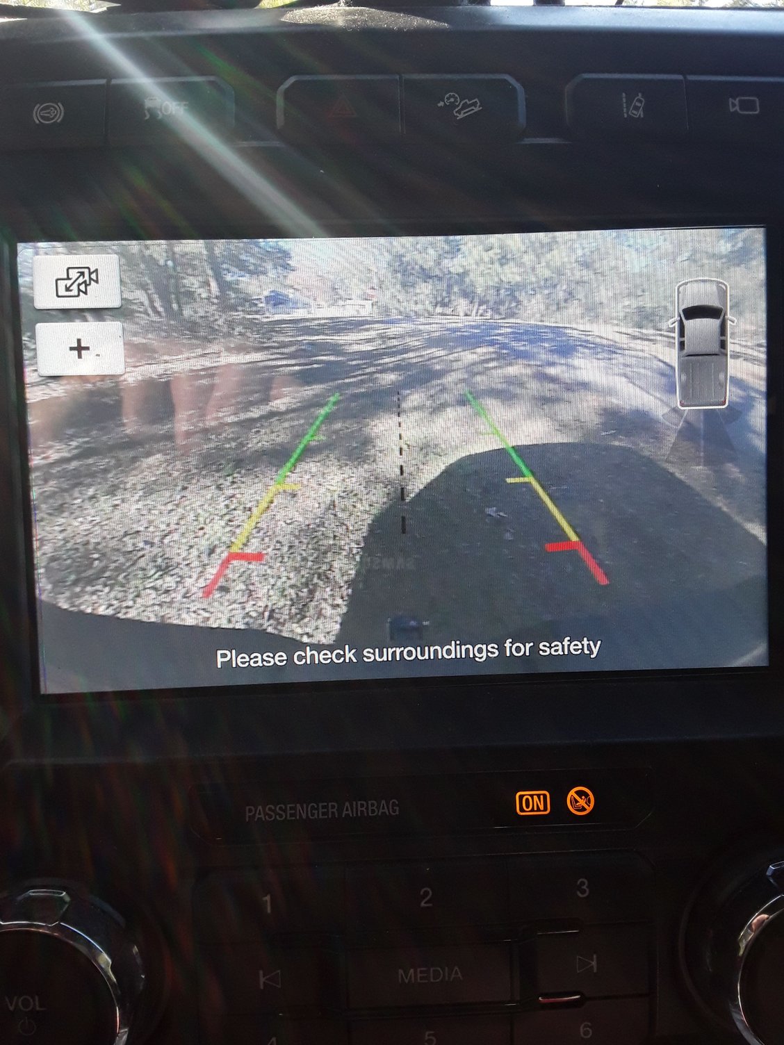

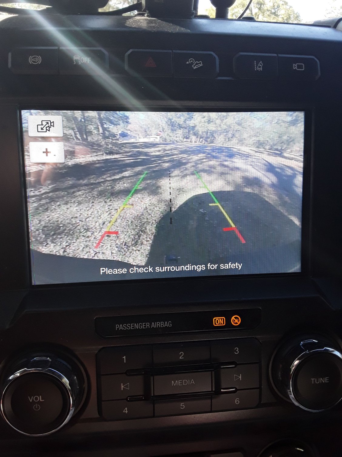

on my '19 model 360 cam i have the nav tv cod 53, just to see, i put in reverse, and got split screen, i changed it to single view, the 360 split view went away, but the ghost image of the truck remained in upper right, imposed on a full screen single view. back up lines were present. when in forward the ghost image of truck gone i turned off cameras, then went to reverse, still same ghost image of truck on a full view screen.
Old Jan 11, 2022 | 01:15 PM
Ford Fx4's Avatar
Ford Fx4
Joined: May 2006
Posts: 1,209
Likes: 69
From: land of 10,000 lakes
Originally Posted by Beerleg
on my '19 model 360 cam i have the nav tv cod 53, just to see, i put in reverse, and got split screen, i changed it to single view, the 360 split view went away, but the ghost image of the truck remained in upper right, imposed on a full screen single view. back up lines were present. when in forward the ghost image of truck remained. i turned off cameras, then went to reverse, still same ghost image of truck on a full view screen.
So you still had a ghost image of the 360 view even with full rear view camera ?
can you get a picture of it?
Old Jan 11, 2022 | 01:42 PM
Beerleg's Avatar
Beerleg
Joined: Oct 2019
Posts: 368
Likes: 47
From: In a F 350 by the river

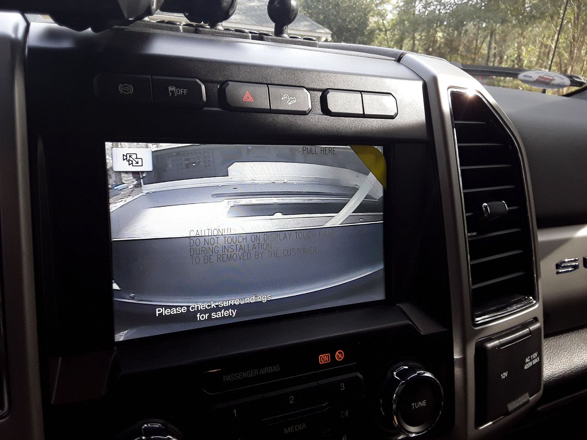

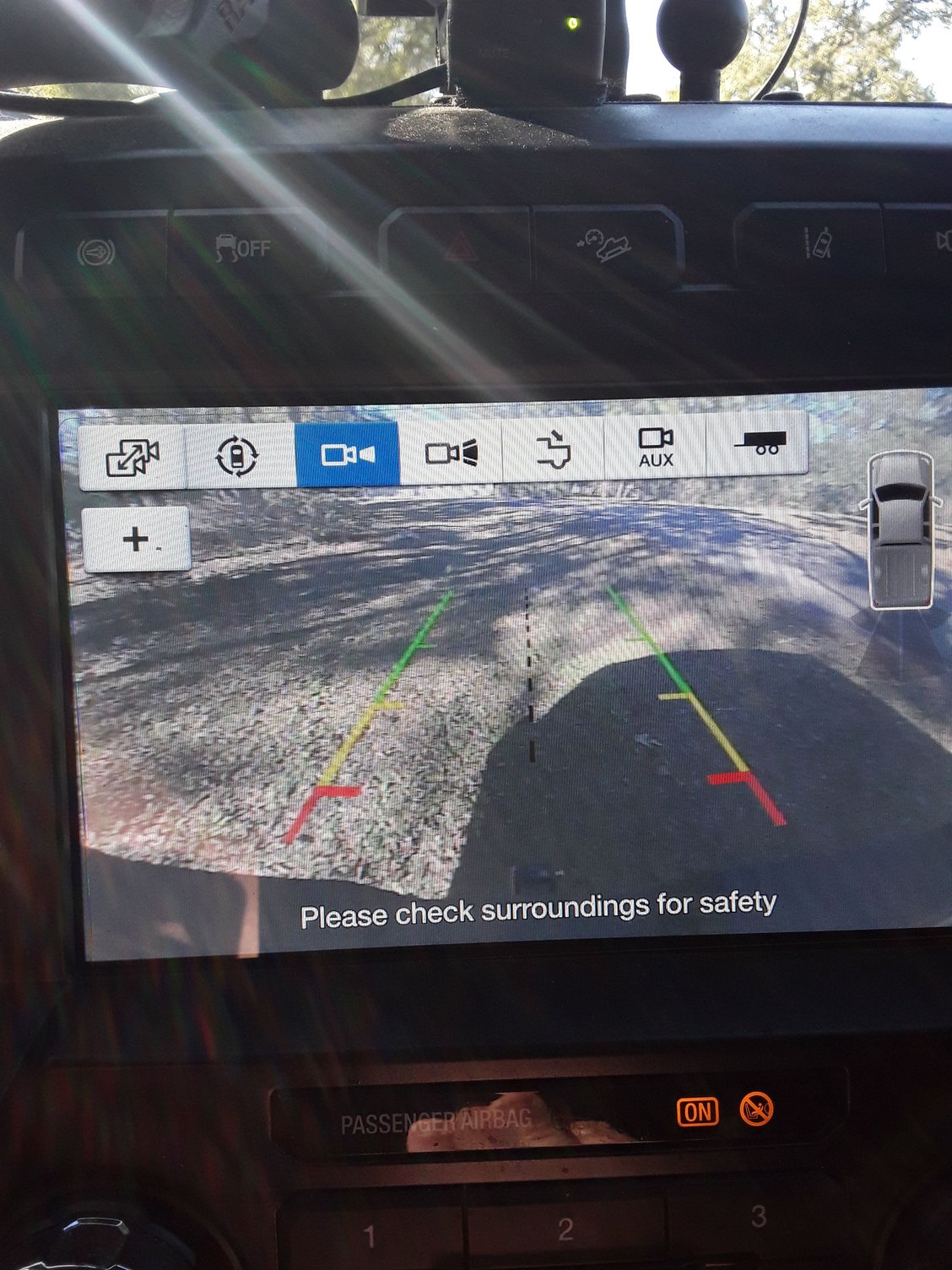

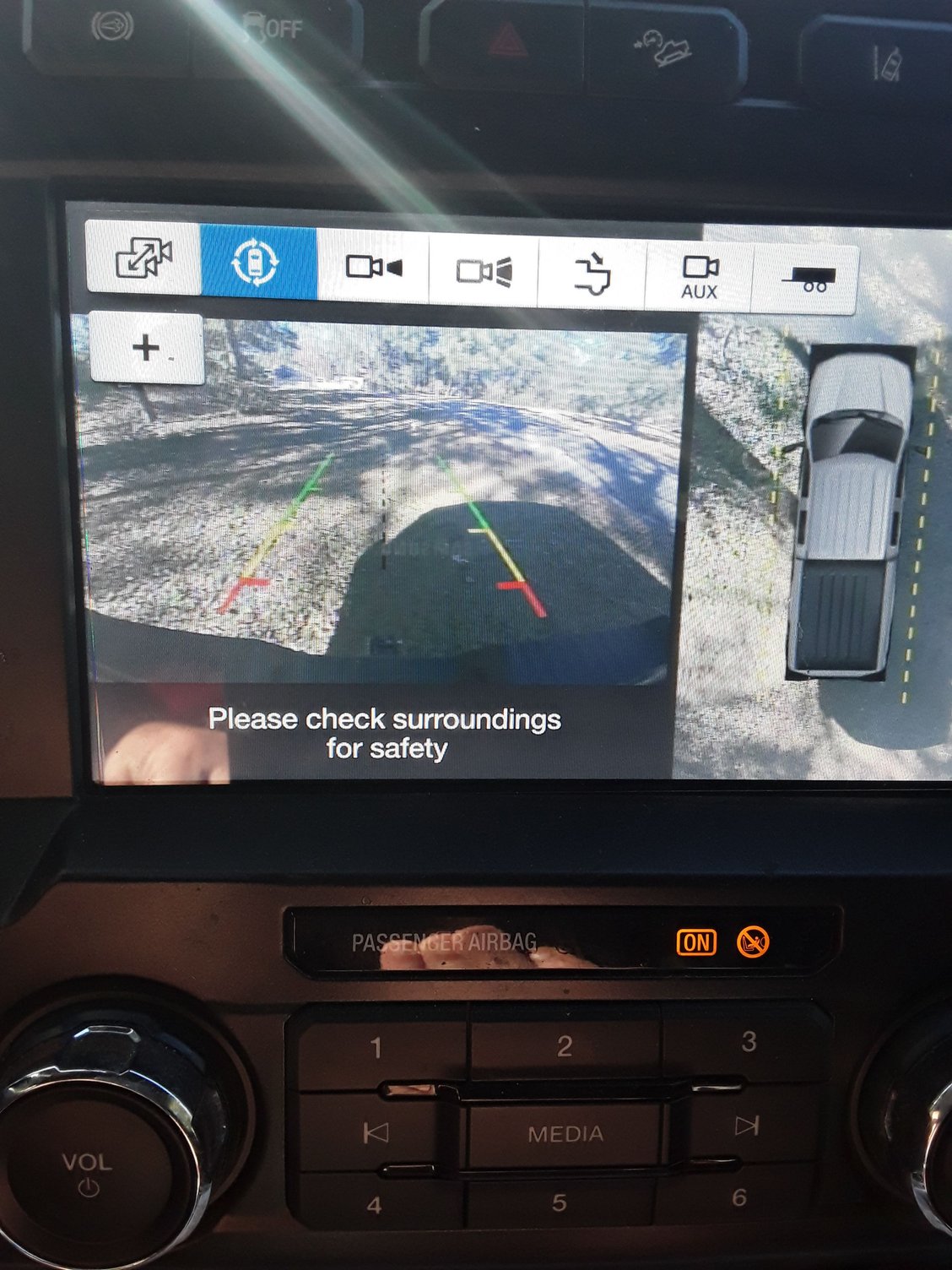

rear tailgate full view, in reverse
std 360 view
the ghost image of the truck shows up in reverse, but image is full.
tthe non ghost truck image is in forward.
these will display at any speed.
camera view can be switched from front to rear by 2 presses of camera button.
cameras in mirrors come on with turn signals, they are full wcreen
the ghost image of the truck shows the backup sensors
hope this helps, i know youve been working on a solution for a while.
this is on a 2019 lariat, 360 camera, 8" display, sync 3 nav tv cod 53
2020+ and sync4 MAY be diffrent
I also have a bed mounted camera on a upfitter switch in the system.
Nav tv cod 53 on upfitter switch
std 360 view
Thanks for the pictures!
For some reason when you said ghost image I was thinking the 360 camera image still had an overlay even on the full rear camera. I don't mind the small truck showing in the top right.
thanks again.
Now I am just waiting for the navtv kit to become available.

small truck shows backup sensor info when in reverse.

good deal, on the camera display options, with the 3 horizontal stacked lines, it wont allow you to switch from the 360 (circle) to a single view (camera rith shaded triangle view) like in the last post #25 pictures 2 and 3?
