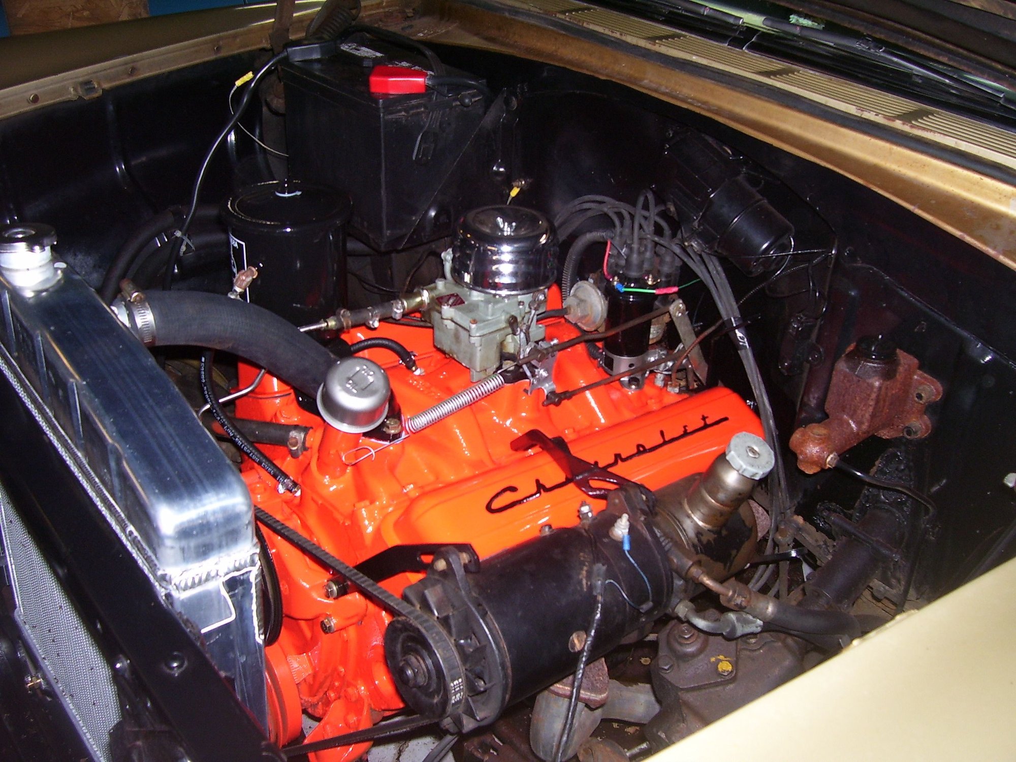

Hey I know where you might have seen that old GM alternator / power steering setup, my 55 Belair!

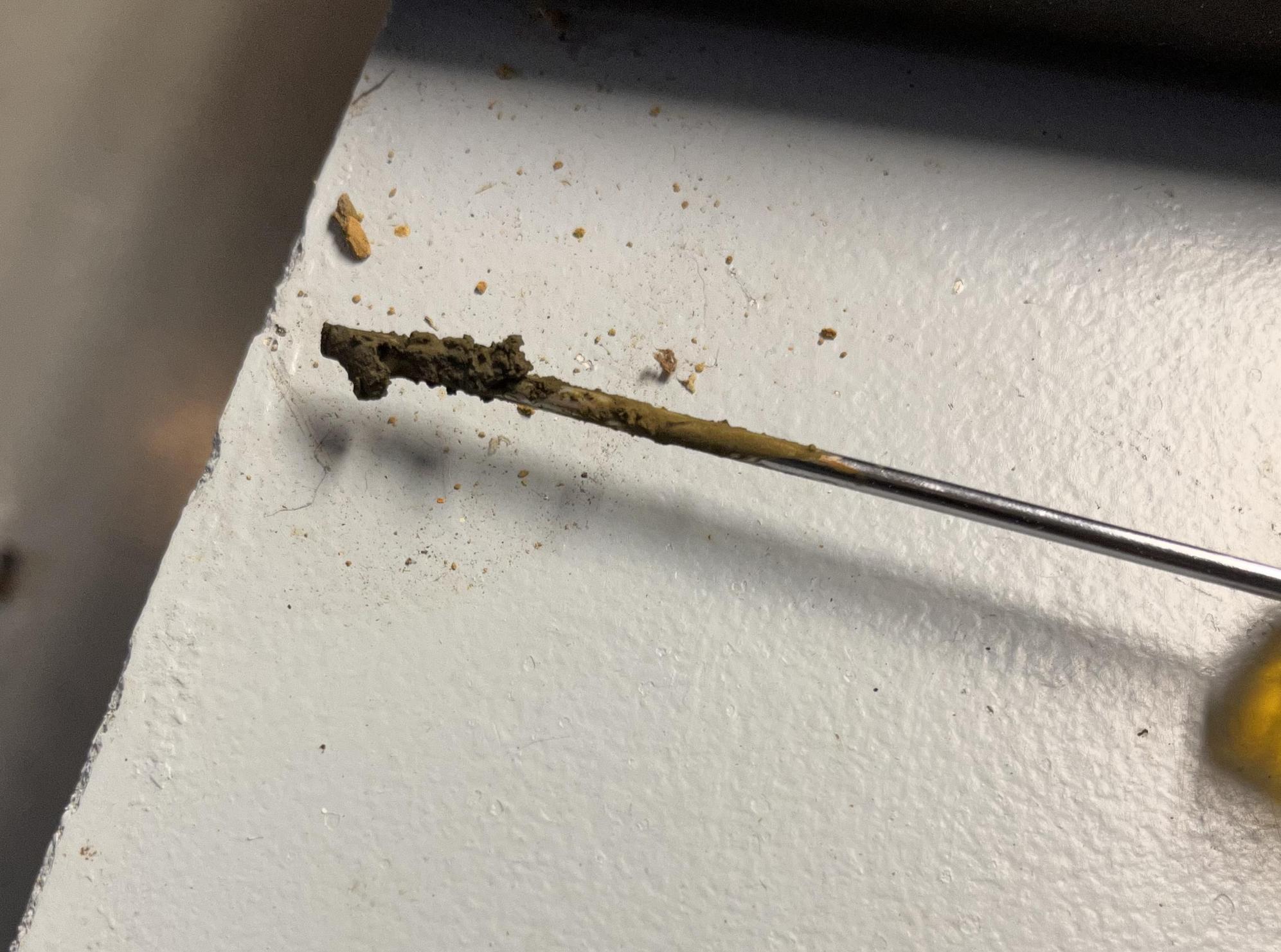

I haven't drained the water in this old tank since I got it (bought it used 3-4 years ago), and when I moved it in order to sweep and mop behind it, I could hear water sloshing around. Tried to release the drain but it was so rusted that it just spins on the rivet (or whatever is supposed to hold it). So I put a little heat in it and some WD40 then removed the whole plug. But when I set it back down, nothing came out. So I jammed a screwdriver in the hole and pulled out some nasty crud. After that when I set it down, at least a quart and disgusting black rusty water came out. I've ordered a new petcock drain so in a few days I will be back in business.
Very rusted tank, I might need to upgrade soon.
This gooey funk was blocking the drain.

On the tank I would take a hammer and tap all along the bottom to see if you hear a thin spot and if you do then I would think twice.
My dad had one blow the bottom out in our home garage when I was a kid. We were lucky that no one was in the garage at the time but a paint gun cup full of paint that was pretty far way made a mess then it got blown over.
What size is that tank?
Take it the compressor part and motor are good still?
If you find the tank is bad I may have a fix.

That is a 15 gallon horizontal tank with a 3hp compressor. I do have a 20 gallon upright tank, the compressor on it went bad a few years ago so I tossed it. Funny thing, I think it had a smaller compressor. I was thinking the same thing, maybe putting this compressor on that tank.

Well at least you have a back up tank with that 20 if the 15 is bad.
I have a 30 I think it is with a bad compressor 220 motor that if you need a tank you could have.
