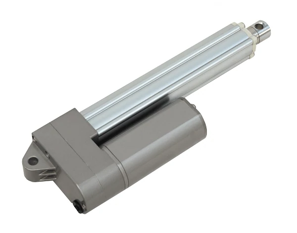

So this leads me to my last idea which has been rolling around my head. What about a 12v linear actuator, that pushes against the m/c push rod? You can these actuators in any configuration, you can choose the ram distance and the amount of force. Figuring that traditional vacuum boosters can add between 200-300 pounds of force. This one with a 4 inch stroke and 330 pounds of force costs $156.
Fabrication would be easy, but wiring to make it work when needed might be impossible.
But how do I trigger to come on, and then release when the brake pedal is no longer being pressed? If I wired it to a relay that was triggered by the brake light, then whenever I press the brake down, as soon as the pedal moves far enough cause the brake lights to come on, the actuator would engage. But it would still continue holding it even once I removed my foot from the pedal. If only I could figure this out, I would definitely have a slick setup that no one else has!

Ok that last one I cant see it working as planed.
First and for most anything used has to also work with no power to it.
Vacuum or hyd or even electric still work all be it vary hard to push the pedal but it will stop as needed with out power to them.
If there is no power to that how is it going to work?
Then as you pointed out if it comes on / off with the brake lights it will also be on or off and nothing in between in my book.
I think a rheostat type deal would be needed. Need a little braking just a little voltage, more braking more volts and a lot a lot of voltage.
I dont know if it works that way or not?
