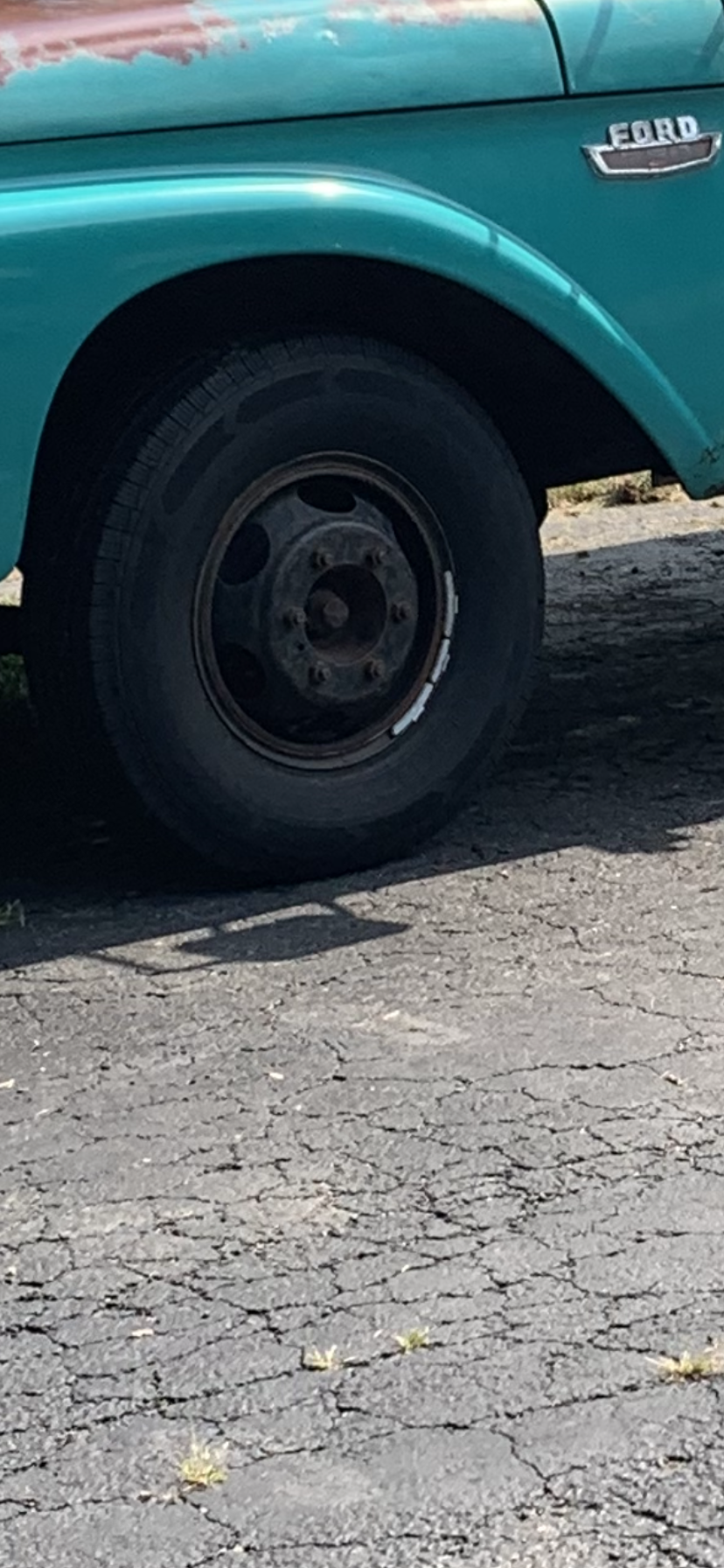

Can you post a picture of what you have?
Old Dec 31, 2021 | 07:32 PM
Dennis Bergman's Avatar
Dennis Bergman
Joined: May 2021
Posts: 25
Originally Posted by 85e150
You have 6 on 8 3/4"?
They’re 6 x 7.25
Old Dec 31, 2021 | 07:34 PM
Dennis Bergman
Joined: May 2021
Posts: 25
Fronts

The wheels now on the truck have the Firestone RHP unbroken ring 16” rims. Optional on F-350s 1956 to 1966 were 17.5” x 5.25” tubeless one piece wheels made by Budd, either numbers 71320 having six hand holes or 79120 having three hand holes. The below set of 71320s is now listed on eBay. These use 8-17.5” tires that are being reproduced by the STA company and are available from Coker, Universal, and other vintage tire retailers. These tires are approximately 32” diameter which is similar to your 7.50-16”s. Below is a link to the eBay set. Stu
