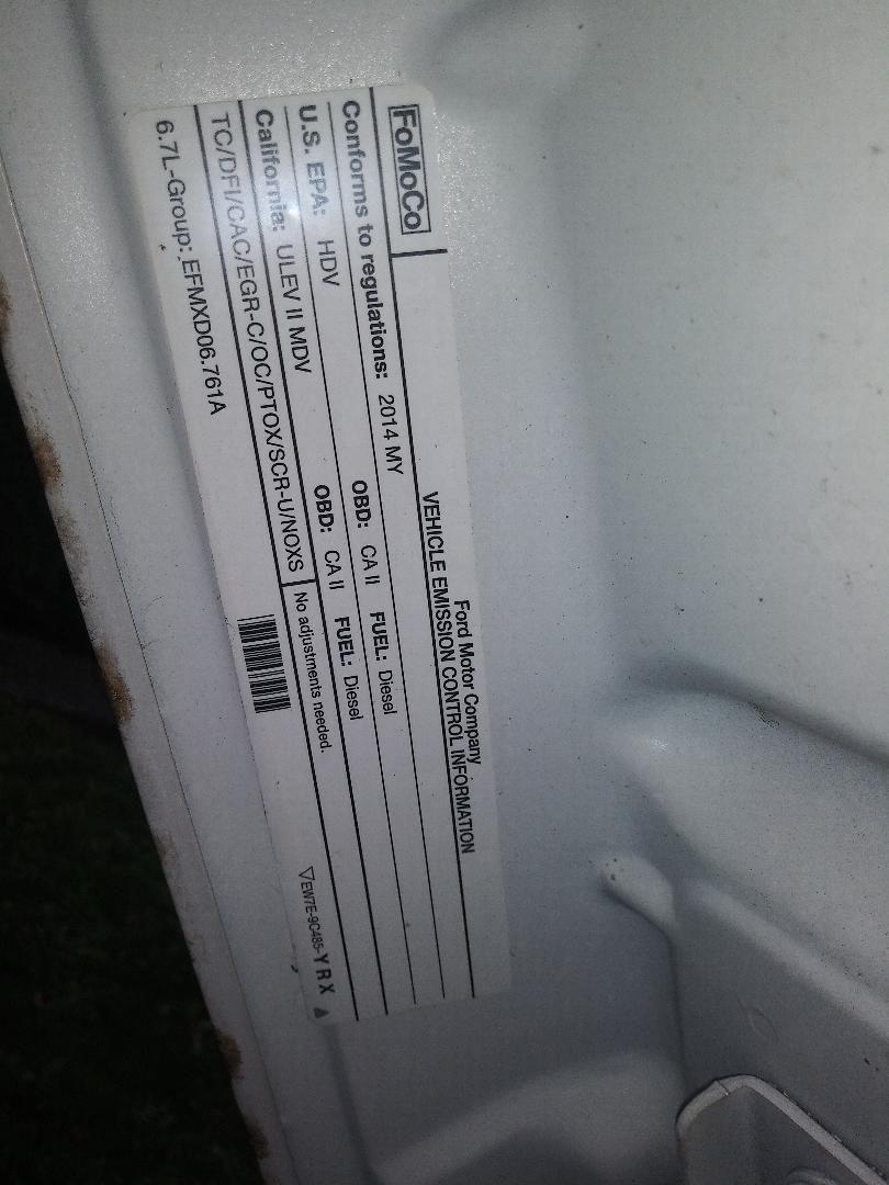

This is what Fords response to the warranty:
As you can see your vehicle which is a 6.7L 4V V8 T/C Diesel is not specified under the California Emissions Defect* section of this NEW VEHICLE WARRANTY COVERAGES FOR 2014 VEHICLES Table of Context. Therefore, you vehicle would not be covered under the California Emissions Warranty.
