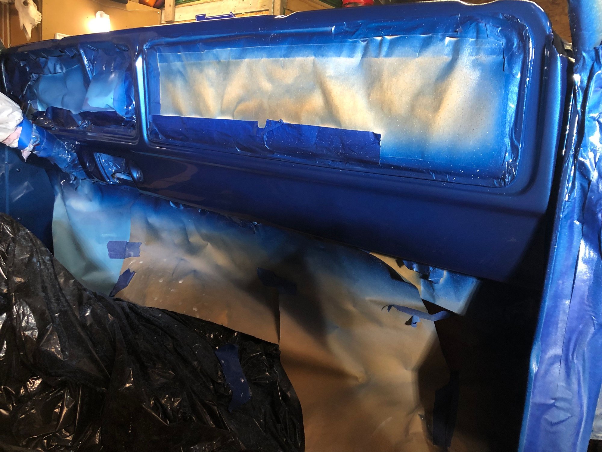

I am definitely an amateur but I practiced a little and bought a really good paint gun and my base coat/ clear coat interior and door jambs came out nice. I got pretty much no orange peel, dirt or runs. A nice gun makes a huge difference.

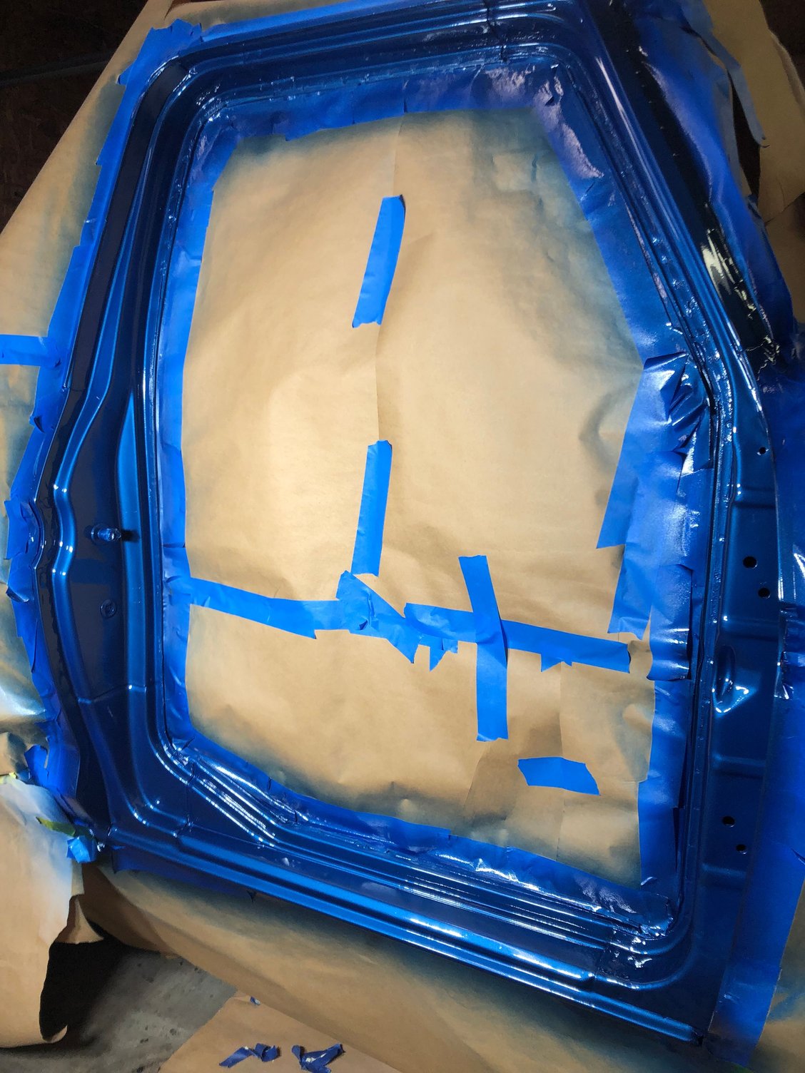

My last painting experience was my first "two-stage" base and clear. Was like cheating compared to a single stage, because the clear will make any substrate shiny and purdy. _ _ _ I liked it.
Here is the reason: the basecoat is not catalyzed, so indefinite pot life. That is a biggie when spraying in 102-degree temps. Because of no catalyst, the basecoat imperfections in the first or second color coat (basecoat) can be nibbed or lightly sanded until you are happy. Then you may proceed with the clearcoat which does have a catalyst which means limited pot life depending on temperature.
I did a quarter panel repair on a subaru wrx, and did like the two-stage base / clear.
Yes, I did color-sand the first color coat for smoothing. Added more reducer, and was happy w/ 2nd.
