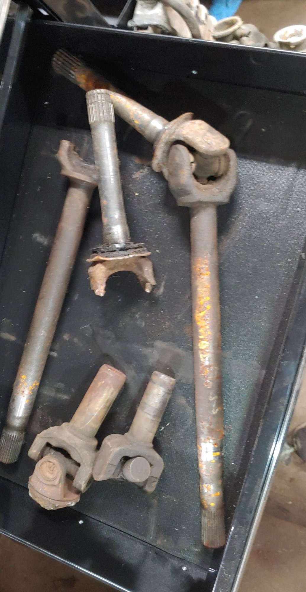

I have work ahead of me next year.. I have 2 axle shafts about ready to pop their u joints they are so worn... but the passenger side isnt the right shaft apparently a 77 d44 from a chevy had different bearings, specs, machining than a 1980 d44 from a chevy(gmc) and my truck is the 80... I also have limited experience on straight axle systems other than being an expert on dana spicer locking hub install(had to redo 2 times for different reasons on the one side on year lol...)
I think there is a bearing in the spindle or suposed to be on the outer shaft that supports it in the hub nose area stuff so its kept at good angles and not throwed around, and also possibly something in the axle tube i need to verify because the thing feels sloppy and im like oh no let me guess that was smaller or had a different bearing size than the one it came out of
I already ruined the first shaft when I had bald bias plys and clutch dumping trying to plow with
its partially cut off in the pic but this ultra lightweight 10.5ft plow Apparently the weak point was the passenger axle shaft in that equation those many moons ago. open diff I suppose only needed to lose traction for a second while not moving fast but under throttle and a weak old u joint that was abused said nope and the shafts yokes had a suicide pact
the shaft thats good there is for a jeep size d44 I think.. bought it by accident trying to replace the one you see to the left. which i salvaged from my spare d44 but has different enough stuff that Im in this pizza roll

Fun fact. That did not work. but it fit and allowed me to get stuck in mud thinking i had 4wd lol
There's a needle bearing on the inboard side of the hollow spindle thru which your stub shaft passes, it's right next to the U-joit yoke. The other end of the stub shaft, with the splines for the locking hub, is centered and supported by the locking hub itself - there's usually a bushing in there for that, and with '96 & '97 Ford hubs (the one with only 3 bolts instead of 6) you get a second needle bearing instead of a bushing, but honestly either type does the job fine.
There ain't nothing inside the axle housing tube. Both the long and the short shafts are supported by the diff on their inboard side and by the wheel U-joint on the outboard side. So really the needle bearing in the spindle carries the weight of both the stub shaft and the axle shaft.
This is how all disc-brake Ford D44s are, also all pre-Superduty D60s regardless of ballpoint or kingpin setup at the knuckles. Superduty axles with unit bearings are near identical, with the exception that there ain't no hollow spindle and instead the needle bearing is pressed into the inner bore of the unit bearing assembly - functionally it works the same way as far as shafts are concerned.
With your GM axles, if there's no center disconnect like your NP203 truck should have, the setup is identical to the Ford described above. With CAD axles it's almost the same, except your long axle shaft now pilots inside the CAD unit on its inboard end, instead of in the diff. The short axle shaft is the same as the Ford's above regardless CAD or not.
