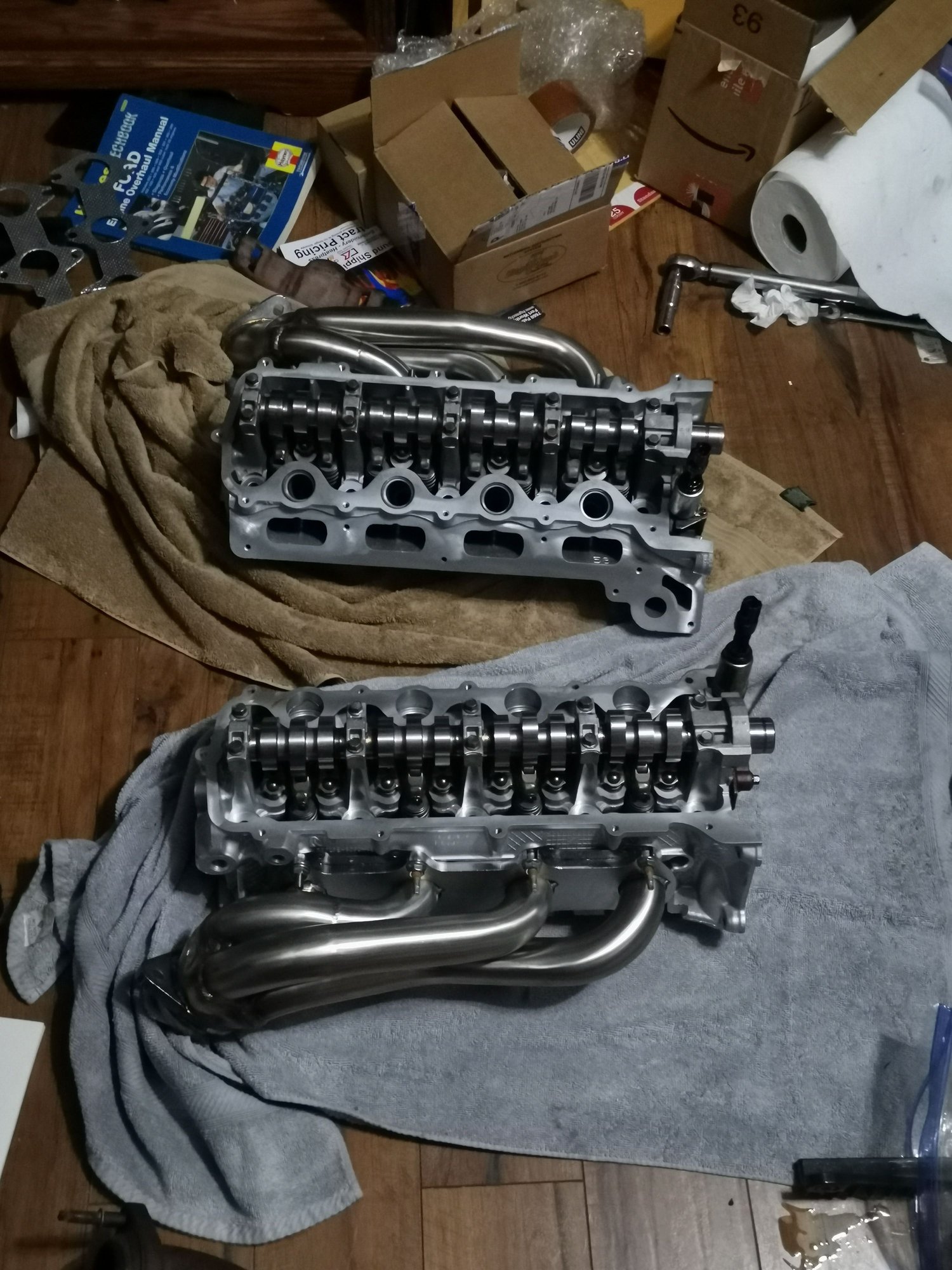

so now I’m in to replace the head entirely , but I understand that you can’t really replace one with a brand new one without replacing the other with a brand new one because it will throw compression ratios off .

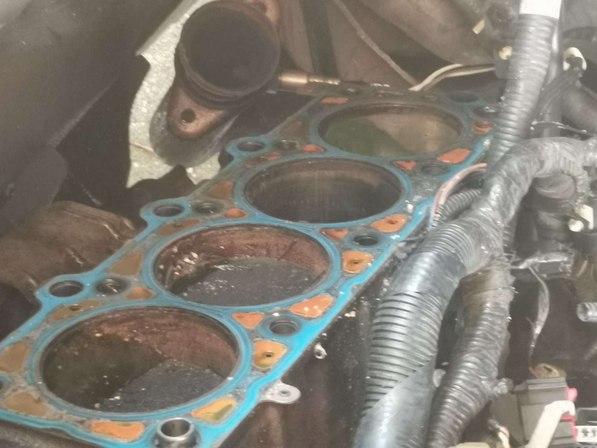

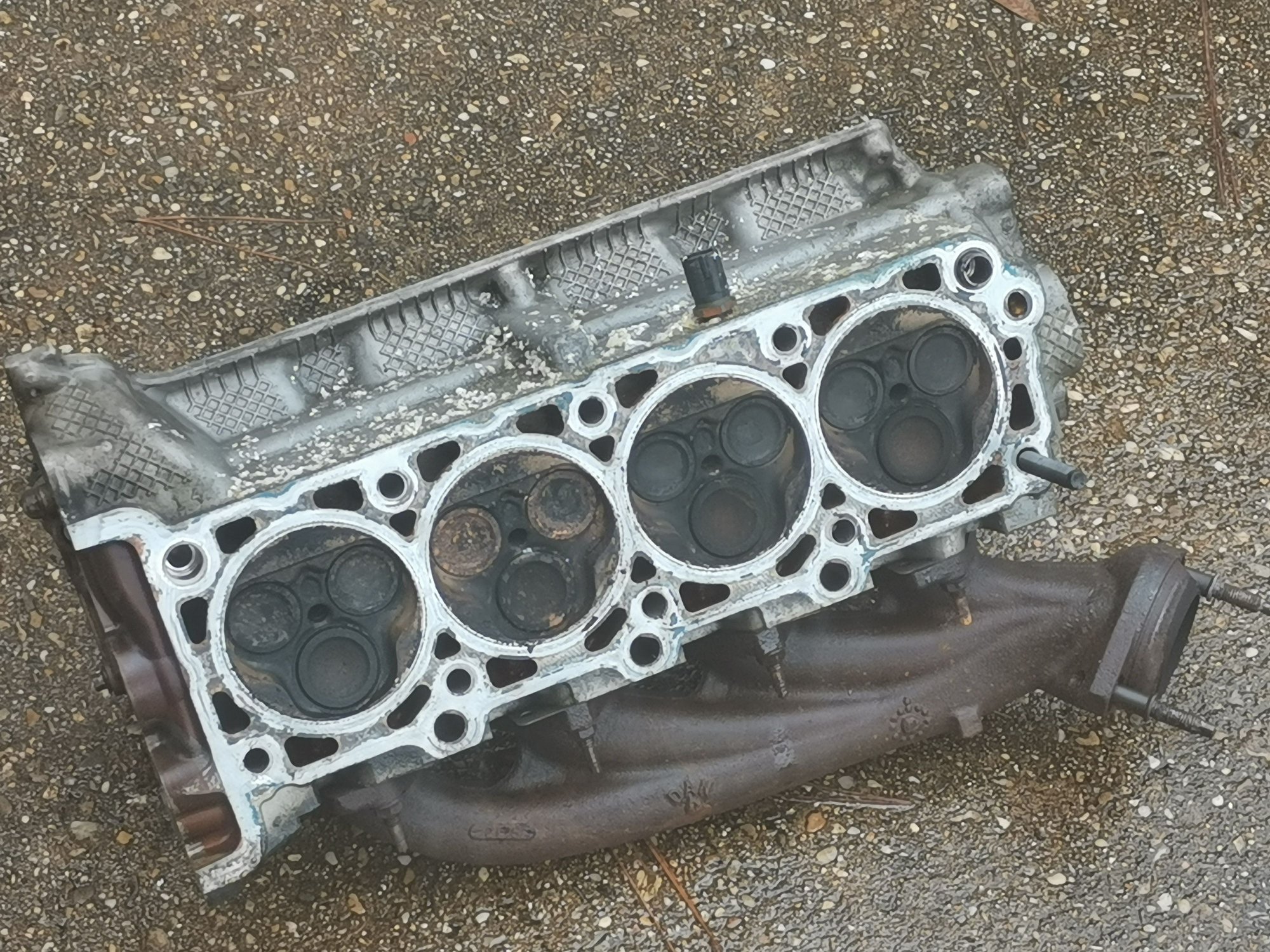

so fast forward to about a week or two ago I get my two new heads in and am pulling off the old ones . As soon as I pull off the intake manifold I get to that back corner near cylinder 4 and the thing just barely is on there and pops right off with a couple 3 half turns of the bolt and coolant just showers everywhere . (To be noted I did drain the coolant at the plug days prior to this )
so heads come off didn’t really see any visible signs of head gasket failure .
what I do think happened is when I replaced the intake manifold that coolant from the intake crossed over into the air ports going into the combustion chambers due to no gasket being seated or torqued there , thus why I got my white smoke .

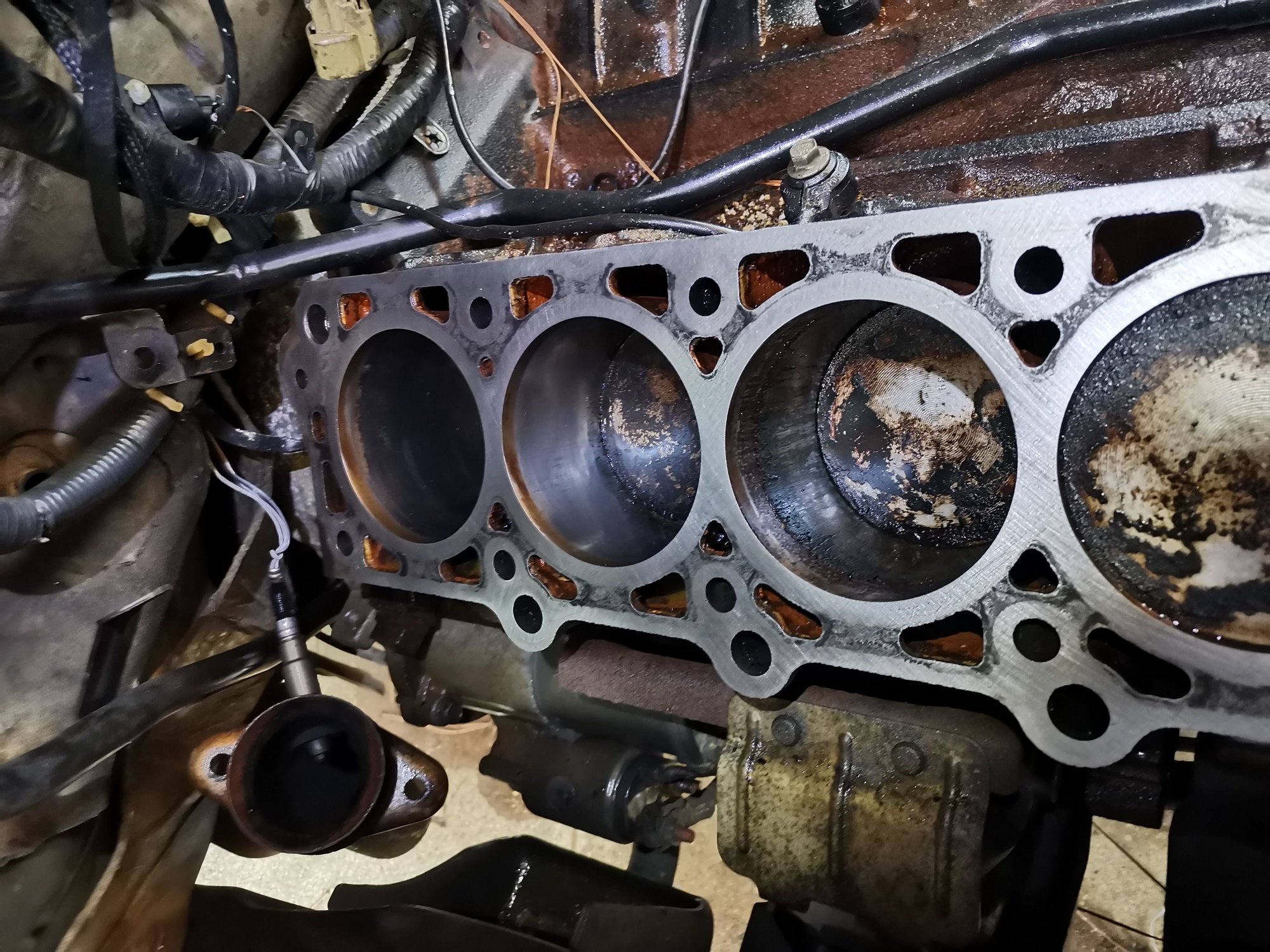

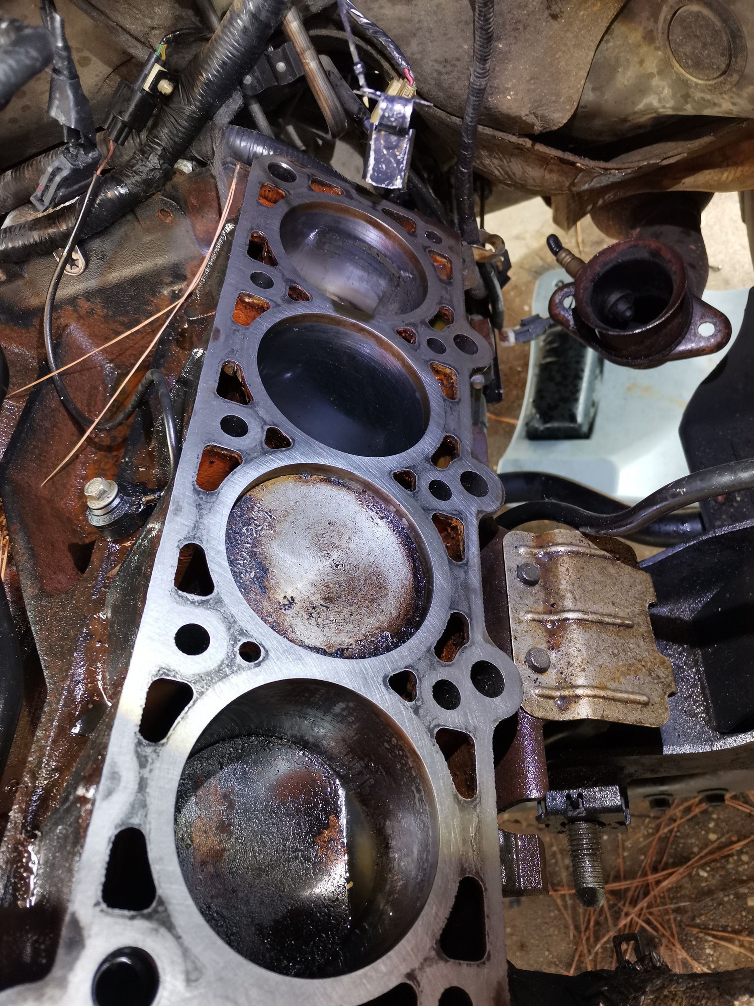

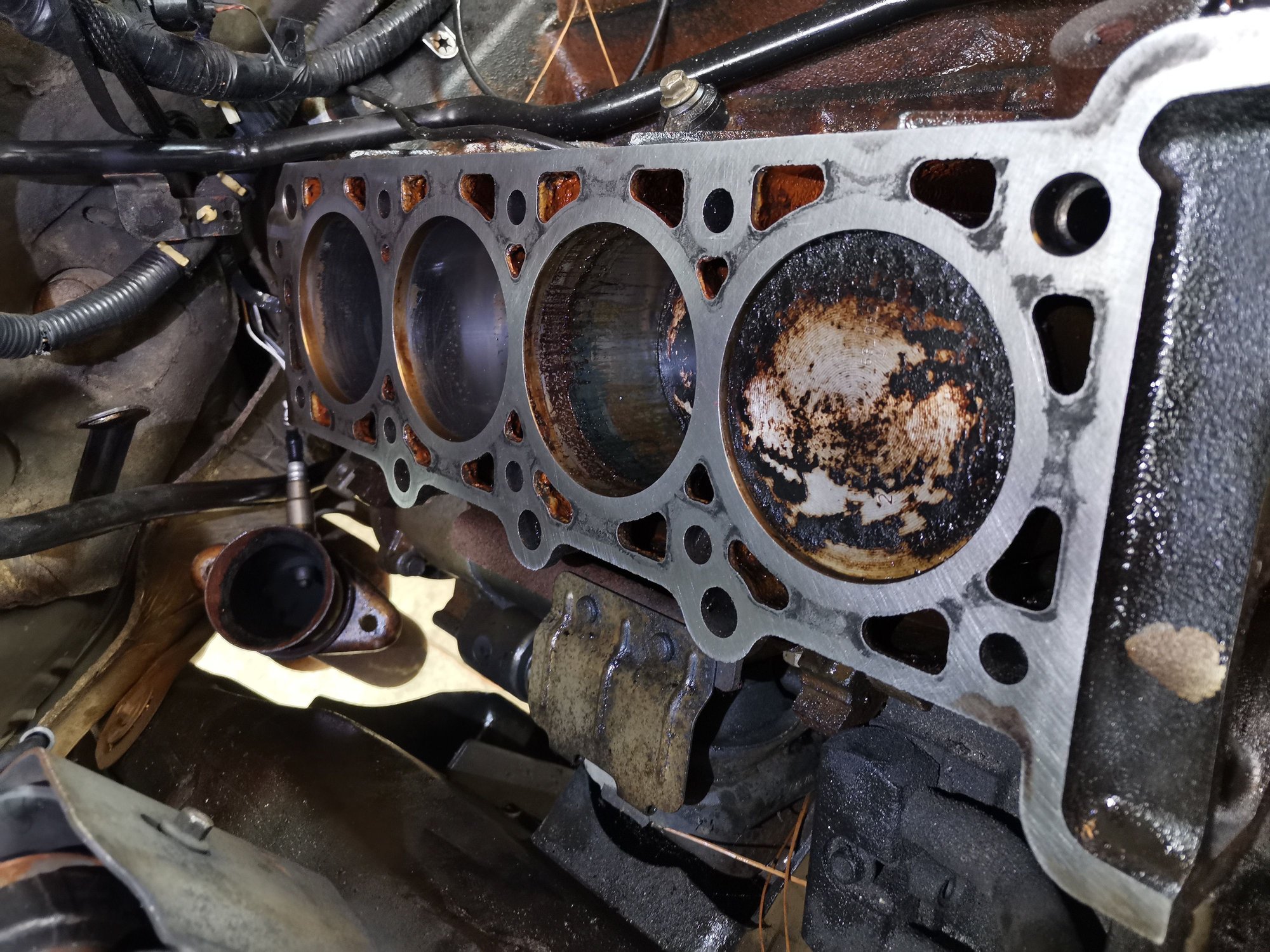

so here’s where it really gets interesting . So I prep my block surface for installing new gaskets and heads , and I’m turning the engine over with my ratcheting breaker bar on the crank shaft , watching the pistons come up and go through their cycle, cleaning the piston heads a little and the cylinders and oiling them and what not .
that’s when I realize there is an unequal amount of pressure that it takes to rotate the crank shaft through about 35 degrees of the rotation. The pistons/crank are taking an even consistent amount of torque to rotate the crank through the cycle , except it’s hitting a rough spot from about 9:30 to 11:30.
I drop the oil pan and look at the crank and find the in tact forward upper piece of thrust washer in the pan and the 2 rear pieces fallen down hanging loosely in the bottom half behind the back main bearing boss all chewed up .
so I’m thinking that when the coolant entered combustion chamber I had mild hydro lock , putting more force on crank, creating more lateral movement/end play and crushing the thrust washer which sent the metal pieces back up into the cam caps scoring them up .
