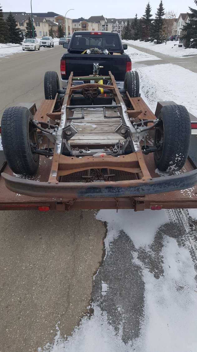

Guys,
Those of you that have installed small block Fords, etc...did you have to remove the angled brackets where the Flathead front mounts sat?

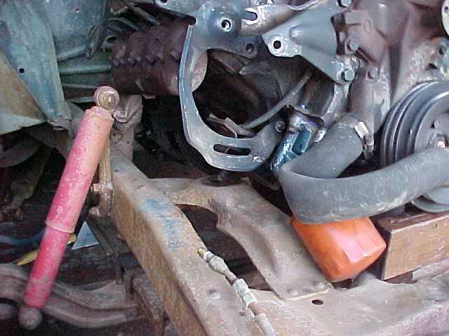

I removed the old engine mounts and left the angled bracket for more strength. The motor cleared without issue. All I had to do was use a shorter oil filter.
