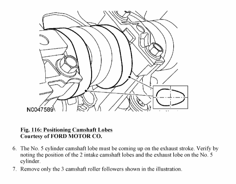

You can take the valve tool and remove all 24 rollers carefully , keeping pressure on valve with your fingers to not let keepers fall out then dropping valve into cly - bad result . This is tedious and clumsy to me .

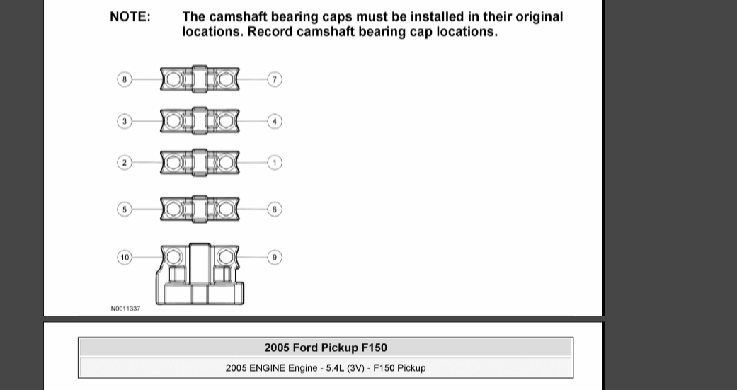

Another way to go is to pull both cams which means no valves will be pushed down . This is my best way . But you have to do it properly . It can seem daunting but its not if you study it and do it by the numbers .
You must mark all parts before you take them off , they must go back exactly as they came off . Lay them out in order so they won't get mixed up . Treat them like a baby .
Parts are removed slowly in sequence per ford . They are put back and slowly assembled in sequence. The idea is to put them back with rollers in place at the timing point watching carefully .

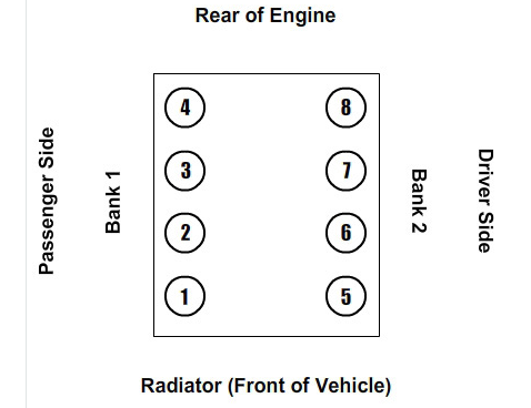

Do not get left and right backwards , use passenger/ drivers side instead . Forget all that keyway stuff use six oclock timing dot on gear and check your cam lobe direction on 1 and 5 on assembly .

Torque on cam bolts is 89 inch pounds , thats around 8 foot pounds but too low to really read properly on a foot pound wrench .
