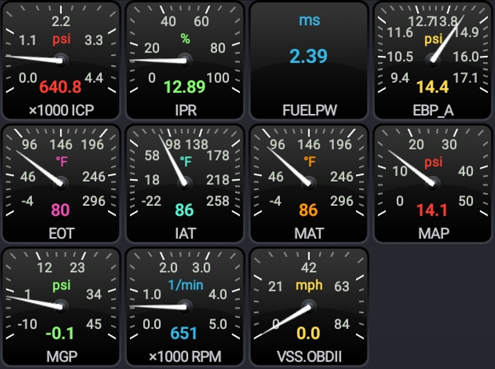

Ok I went to the shop to get my truck. I had a hide-a-key on the frame rail so I got under the truck to retrieve the key. I got up and just for giggles I grabbed the door handle and it opened!!! It wasn't even locked and worse tham that the key was in the ignition!!!!!!! Anyway at idle and operating temp I have 500psi on the ICP and IPR 12.8% IPW 2.8ms. Idleing at 650rpm. Am I in the right parameters? The GPR I believe is working because there is a wire looking light that comes on with the key that I let go out before I try to start.

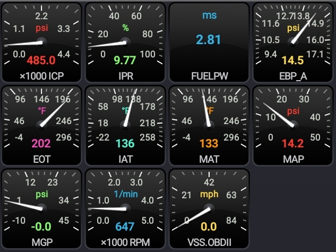

Your parameters appear to be right about where they should be. Below is a snip from a "good running condition" FORScan Lite screenshot I have on file.
Your IPR% seems a little high, but nothing to be alarmed about especially if your EOT was a bit lower than "full operating temperature". See image below.
