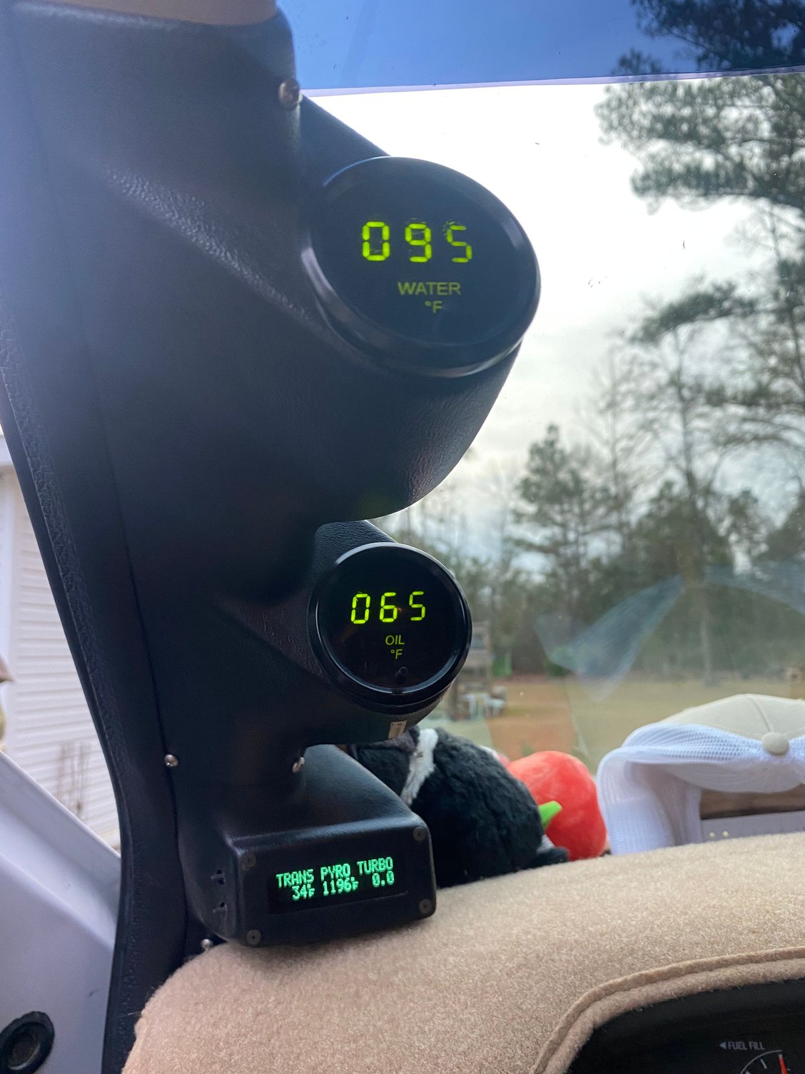

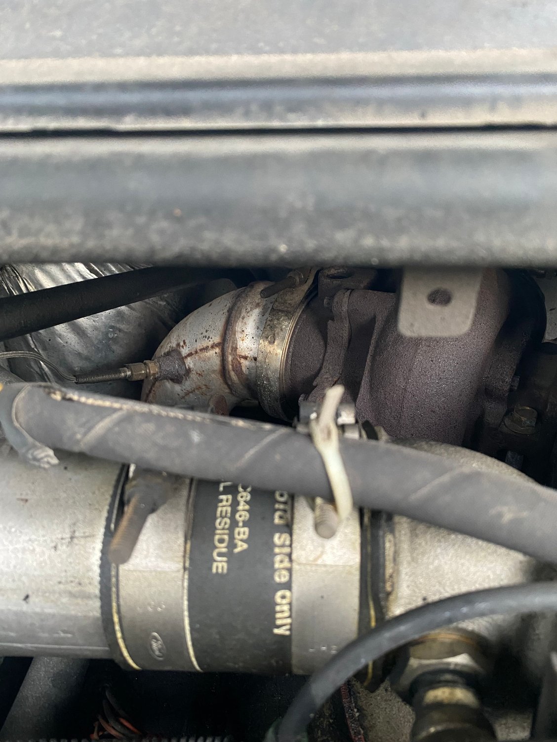

I could not find the egt probe. but did manage to get pictures, sorry for the delay
Zoom in on the bottom & under pyro you can see my current egt. The truck has only been running for 3 min after sitting for a day

I’m really starting to think something is wrong with the gauge. Because the truck can sit for hours & if I turn the key on, it will say my egt is at 850 or so…

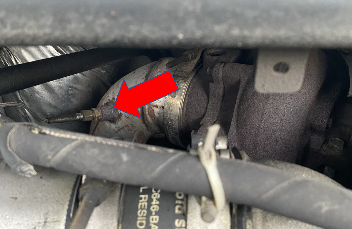

I have inserted a red arrow in the last image you posted above. That is most likely your pyrometer, which is mounted in the down pipe and generally considered not an ideal location. That said, and as we were eluding to above, the gauge or the pyrometer sensor itself are likely faulty. Especially if the gauge is reading 1196° 3 minutes after starting from a cold engine for the first time of the day. Especially in that location within the down pipe.

So I unplugged it & it read 2213 without starting the truck & didn’t move. I plugged it back in & it stayed around 920 & moved around the number, without starting the truck. Also, come to find out, it is a BD Power x monitor
