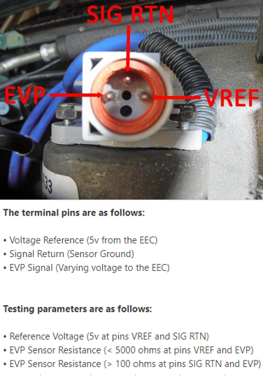

I wonder if your issue is the pintle/stem of the EVP, is slightly longer than need be, and thats why your getting that its above closed volts(0.67v), a couple members had this issue, when they got the wrong one, not just the wrong motorcraft brand, which there's 2 of 1-black, 1-lt grey, I cant seem to find the thread, it was, they ended up filing down the end(pintle/stem) and code went away. Check voltage instead of resistance, may not be opening the EGR enough to cause issues, like theirs did.
Fuel Injection Technical Library » EGR Valve Position sensor (EVP)
