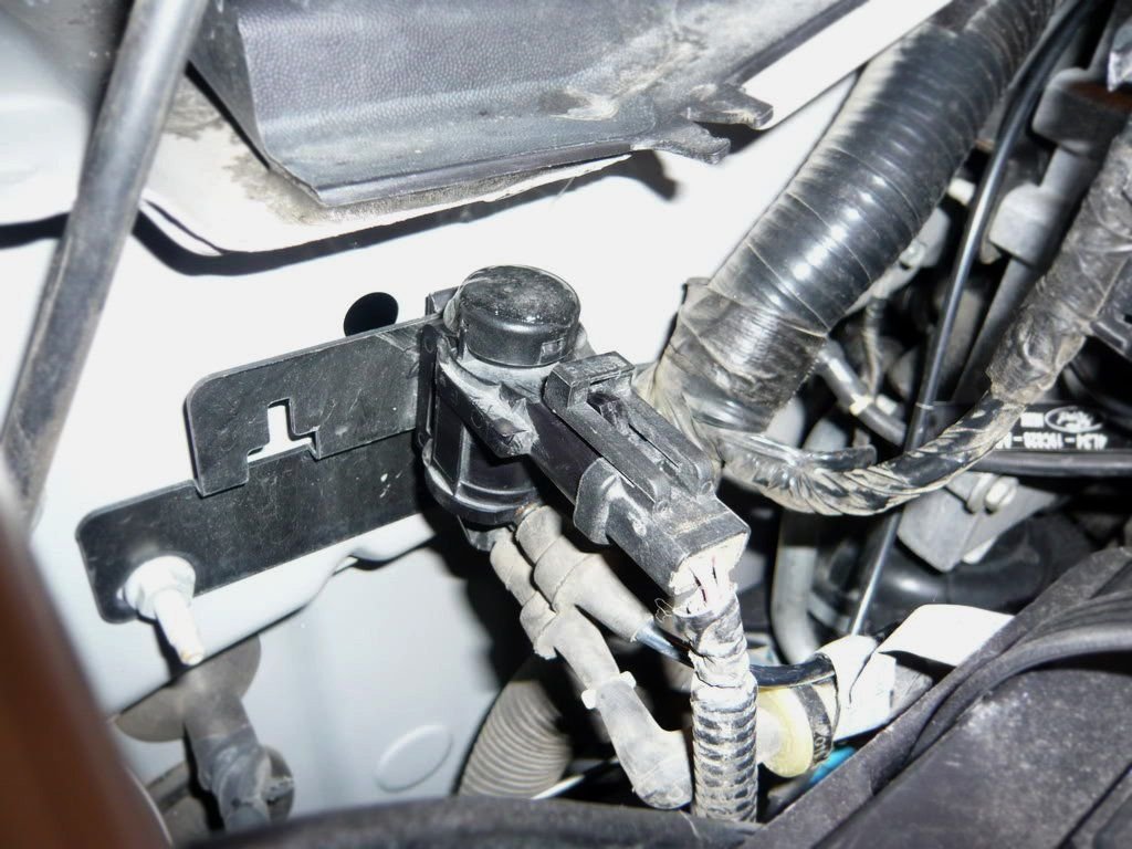

Yes, there is ONE control solenoid behind the battery on the firewall, and an actuator ring on each front hub. When vacuum is taken away from the actuator ring the hub engages. So if you parked your truck on the ice or snow in 4x4 mode and turn the engine off the front hubs will stay engaged to help hold the truck in place.
Ford's 4x4 Front Hub Control Solenoid on Firewall ....
Ford Front Hub Actuator Ring .....

I read that, but i also read that in the f-150 that in 2004 the system swapped from adding vacuum to engage hubs to no vacuum engaging the hubs. I wasn't sure with the expidition if this was the same - wasnt sure if it was when they swapped from the 2v to the 3v and if that had something to do with it. My truck is a 2v.
Other quick question - Looking on rock auto there appears to be 4wd actuator, 4wd actuator valve, and 4wd hub locking solenoid which all look the same thats in the picture. Are these interchangable names or actually different parts?

Yes, Rock Auto lists the same part in several places by different name.
I always cross reference the Ford part number ( you can search for it on FordPartsGiant or Tasca or some of the other Ford parts suppliers online....).
What kind of issues are you having with your 4x4 system ?
Motorcraft CX2046 Vacuum Control Solenoid at Rock Auto
Ford OEM 4x4 Front Hub Actuator on Amazon Ford OEM 4x4 Front Hub Actuator on Amazon
