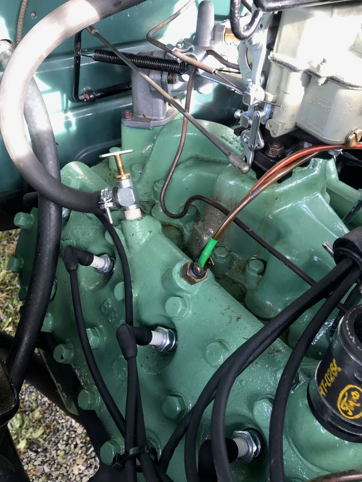

Did you ever verify that the spark plug wires are radio suppression types? Can you post a picture of them or link to the vendor's website?
Hi Ross, I asked about the spark plug wires that I purchased and that are on there. And they said that 6 v wires aren't or can't be of this type? They are the standard reproduction type OEM repops for the 52 V8 stamped FoMoCo. Thanks!
here is a picture from last year after I got the new wires installed. However the problem with the radio happened or started before the wires got installed.
I don't understand that statement. 25,000 volts is 25,000 volts, whether generated from 6v or 12v. I don't doubt that the ignition system is causing your problems.

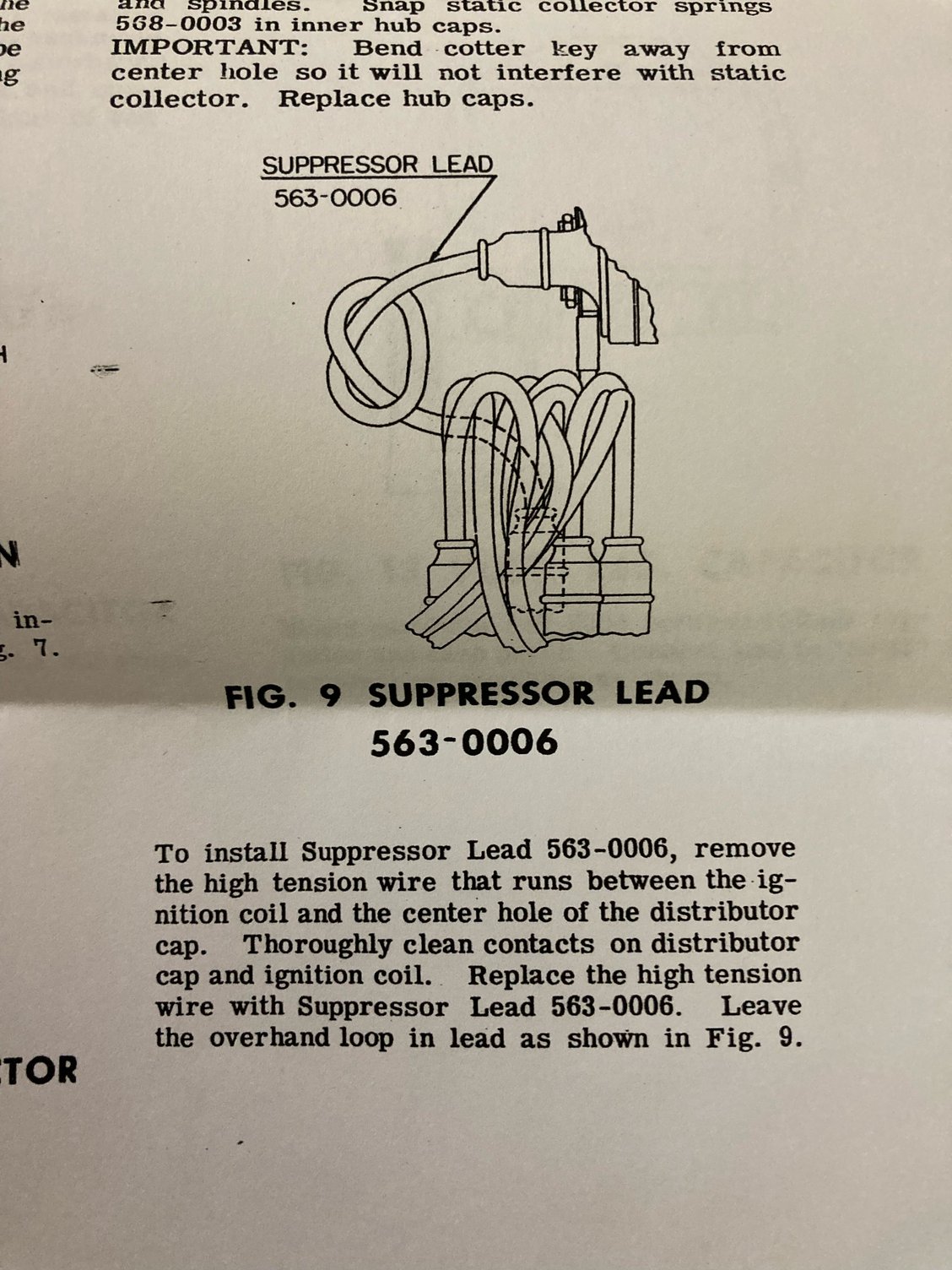

Question, on the Ford Radio instructions on the distributor there’s this part plus the condensers.
Do you guys think it’s needed? Where would I find this part if I wanted to put it on?

The "suppressor lead" is probably the equivalent of modern radio suppression spark plug wire, as Ross mentions above. Any mechanic will have a short length of modern ignition wire in his shop, or a short coil lead you could just try in the coil to Distributor lead. Worth a try and easy to do.
BTW, the "overhand loop" is a way to take parallelism out of the line - simply put, long straight runs of ignition wire transmit more interference.

Thanks Jeff, for the info on the overhand loop! I didn’t know about any of this. Turns out he’s got the suppression wire and correct connectors. He’s going to see if he can remove the white lettering on the black wire so it looks period correct too. So looks like that’ll happen as well as those condensers. I’ll keep you posted as this is an Aurora unit as well.
