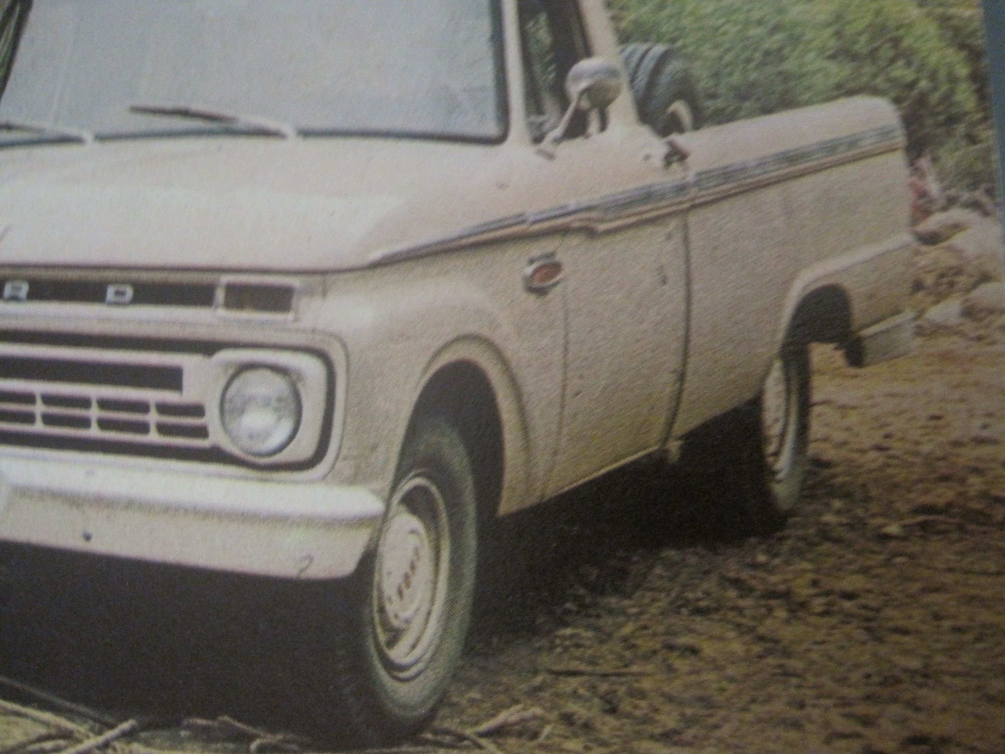

Originally Posted by Branden Heine
I’ve never seen a truck with white caps on white rims?
Wimbledon White was the standard wheel color on all '66 F 100's with all paint colors and combo's, unless body was painted a special order fleet color ( body and wheels usually same color). The carryover bottle cap style was the only "white" hubcap used in '66 when the optional heavy duty 2 piece 15 wheel ( second photo) or 17.5 1 piece was ordered. The "galaxie" ( bump style) cap never came painted "white with red trim" on F100 pickups, it was either argent silver with red trim ( first photo) or stainless with black trim. The only "white galaxie with red trim" hubcap was used on '65-'67 Econolines.
