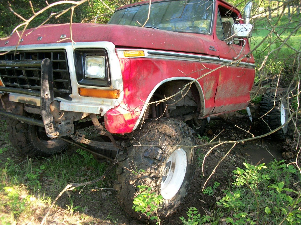

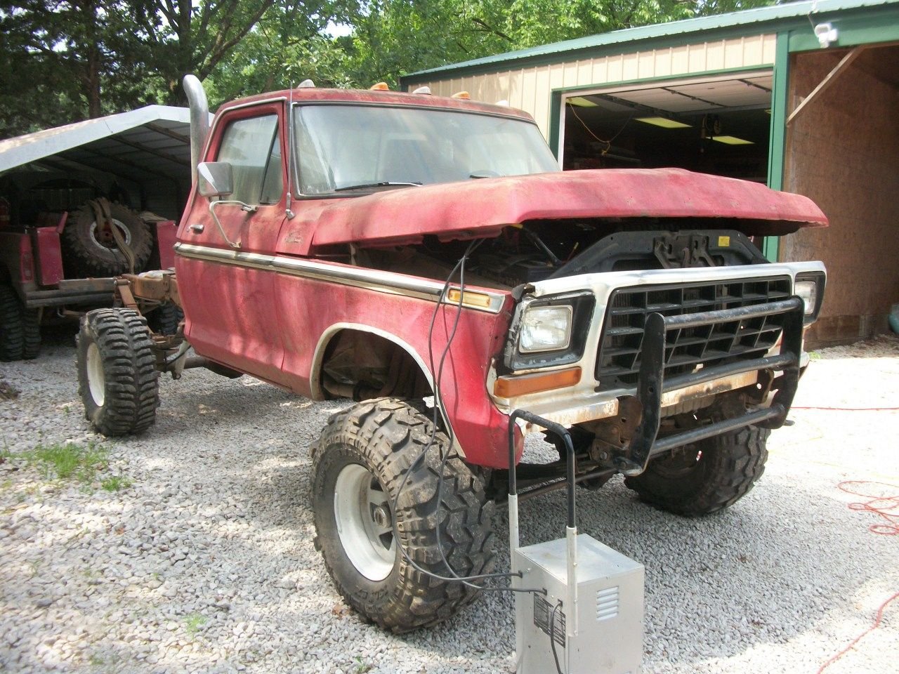

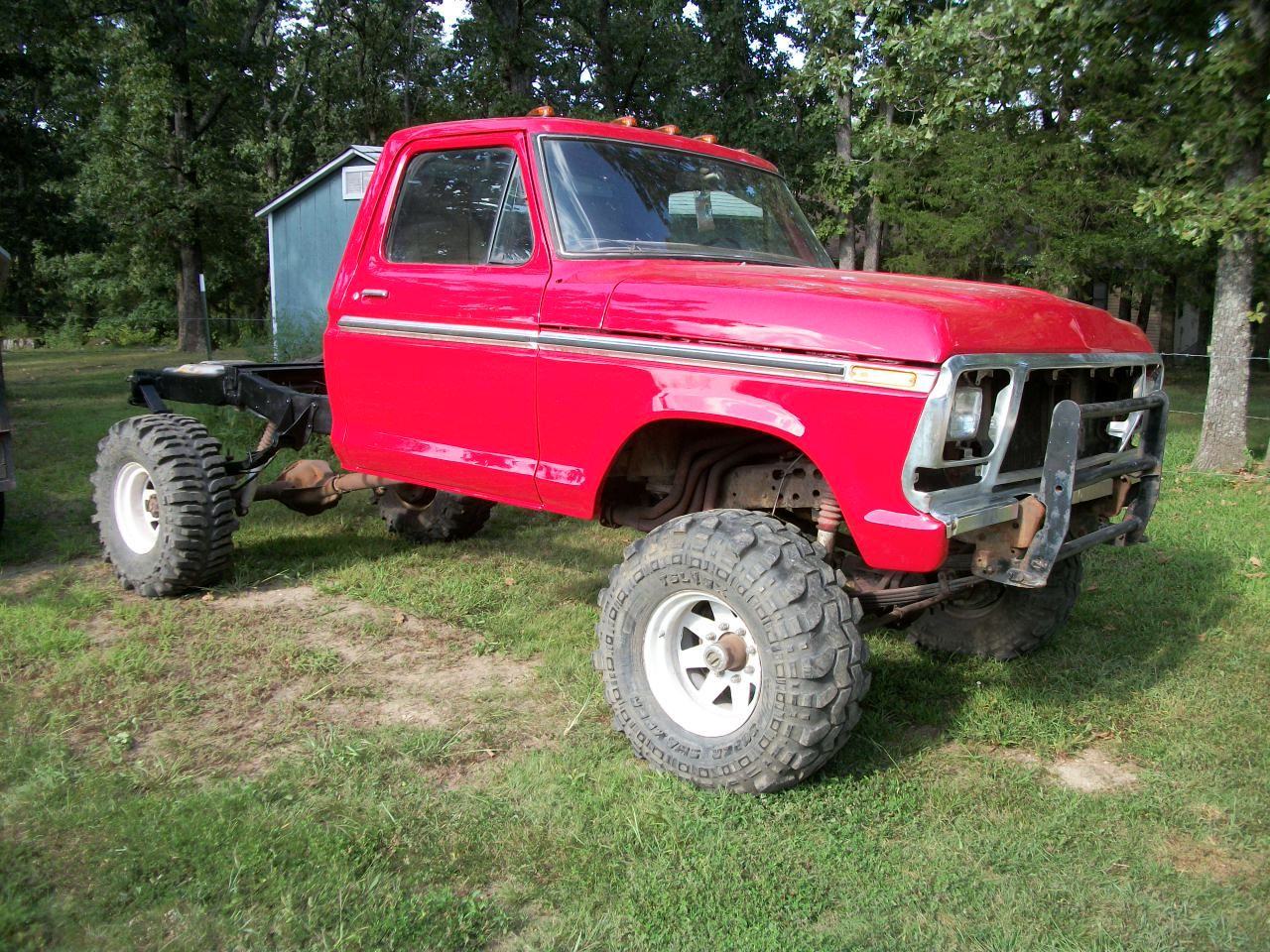

I have a set of Hedman fenderwell exit headers (not sure of the number) on my no body lift, 4wd 79 F250 351M 4sp. With a 6" Skyjacker and 35's. Easy to install, only had to move the brake line clamp bracket that is on the frame. Easy to finish them off with some header mufflers and turn downs. In some of these pics I had them routed to stacks. I now wish I had gotten the coated ones, but they came in a parts deal NIB. Check out Remflex header gaskets.
