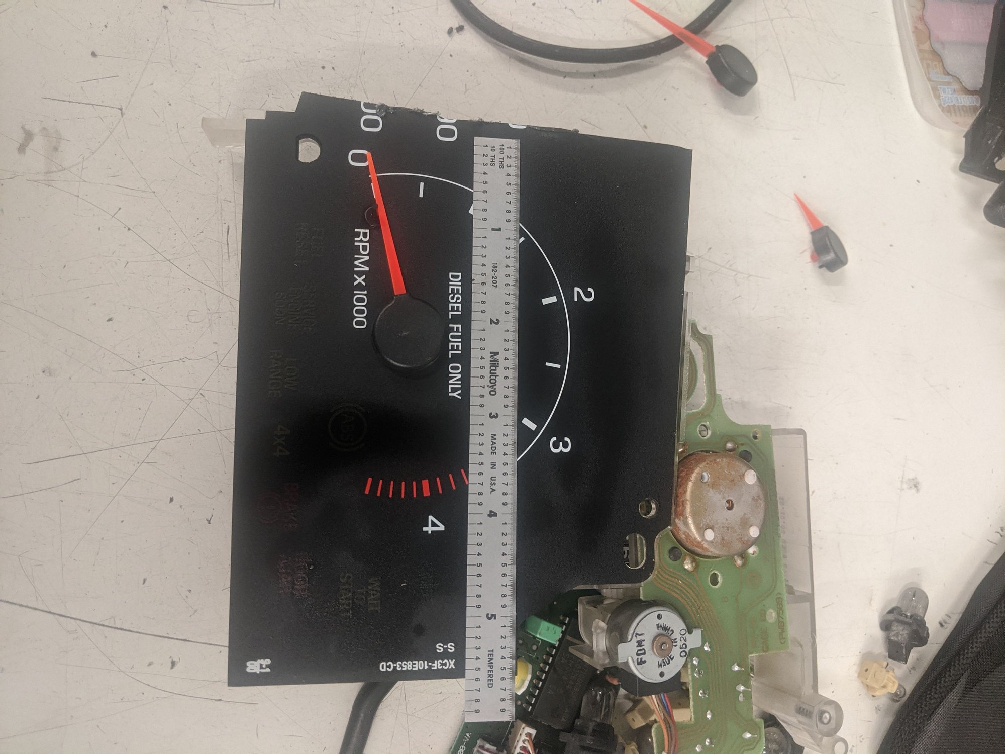

stock 7.3 gauge cluster
Back of the factory tach
cut down version
Thanks Sous, and all that have replied. I was looking at the VDO tachs,and adapters, and thought "Hey *******,you ALREADY HAVE a working tach" use IT!
After a bit of taking the cluster apart here is what I have.
Looks like a piece of 4" tubing and a bit of work to make a "Cup" to hold this,
a few wires soldered on and connected to the PCM, I will be as accurate as FoMoCo built the thing.

Ummmm, are you sure there aren't any circuits that control the tach in the bit that you cut off?
I sure hope not!!
There was some type of circuit board on the top of the cluster, but I didn't bother to pin it out .

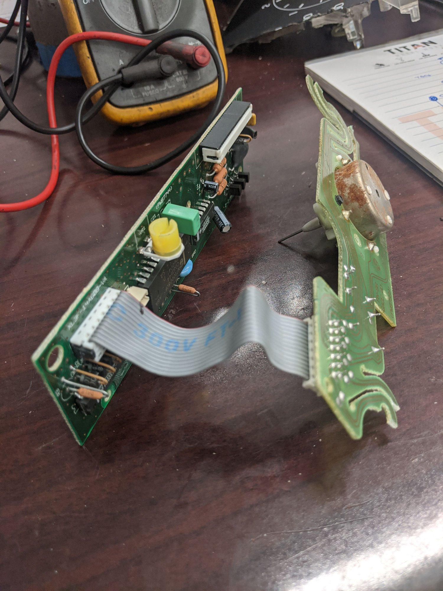

Circuit board to PCB
The little 'motor' is the Speedo drive

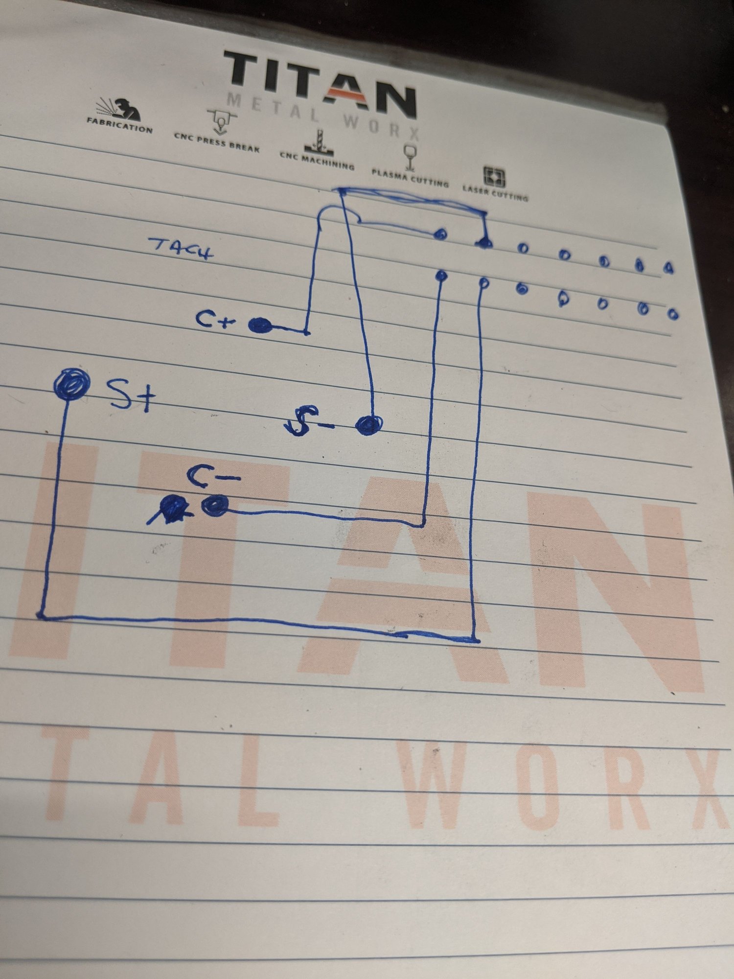

Back of Tach connections
I followed the tracings on the Tach from where I cut the circuit board to the ribbon cable.
this is the 'Pin out'
