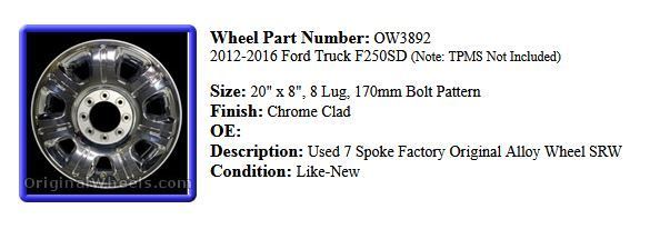

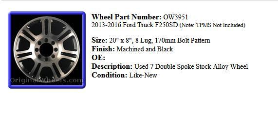

This may be the answer to a question I have been needing to ask. I'm possibly looking at the same rims to add to my X, but it sounds like the reason for spacers would be that some or all Ford rims going forward may have a "deeper dish", causing that inset you are referring to?

Yes the newer post 05 SD wheels all have very little "dish" set back, back spacing, etc. So if you just bolt them on, they pull the tire in about 2". If you park next to a newer SD, it's very obvious. I have both in my driveway, very easy to see. I learned the issue when I started planning to put fresh wheels and tires on my SD, and move it's wheels and tires to the eX.. Not just a bolt on swap.. weird but true. You can buy aftermarket wheels that bolt right on, they will be lug centric instead of hub centric.. that's a whole other discussion.. But probably what I will end up doing for the eX and just keep the stock 20's on the SD.
