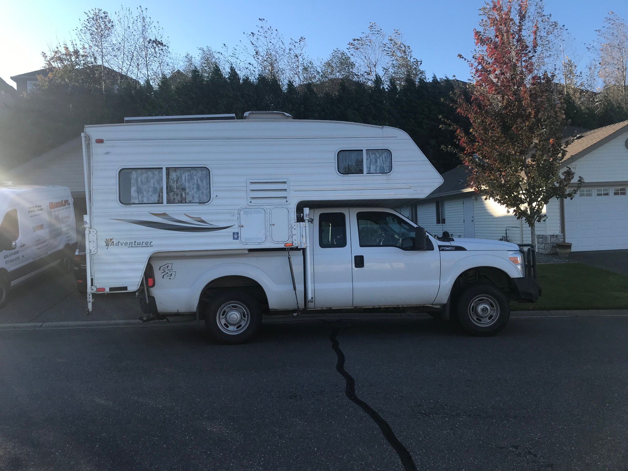

I have same load capacity on my 2014 f250. With my camper( 8’10 adventurer, 2420 dry,15 gals water,fishing gear and food,camp chair and other typical fishing gear) I scale at 11,200 lbs and am just under max rear axle load of 6100 lbs. No way I could consider towing a trailer that would ad 700 lbs tongue weight. All the additional stuff( hold downs,camper jacks,air bags etc add rapidly to reduce carrying capacity.Oh and no passengers just me in truck and I load back seat to keep as much weight forward as possible

The Adventurer camper mentioned has a floor length of 9'5" and so a stinger or extension is going to be needed for towing a trailer. There is a leveraged loading of the hitch receiver with the extension and this should be factored into the choice of the extension with some having chains to reinforce the extension.
