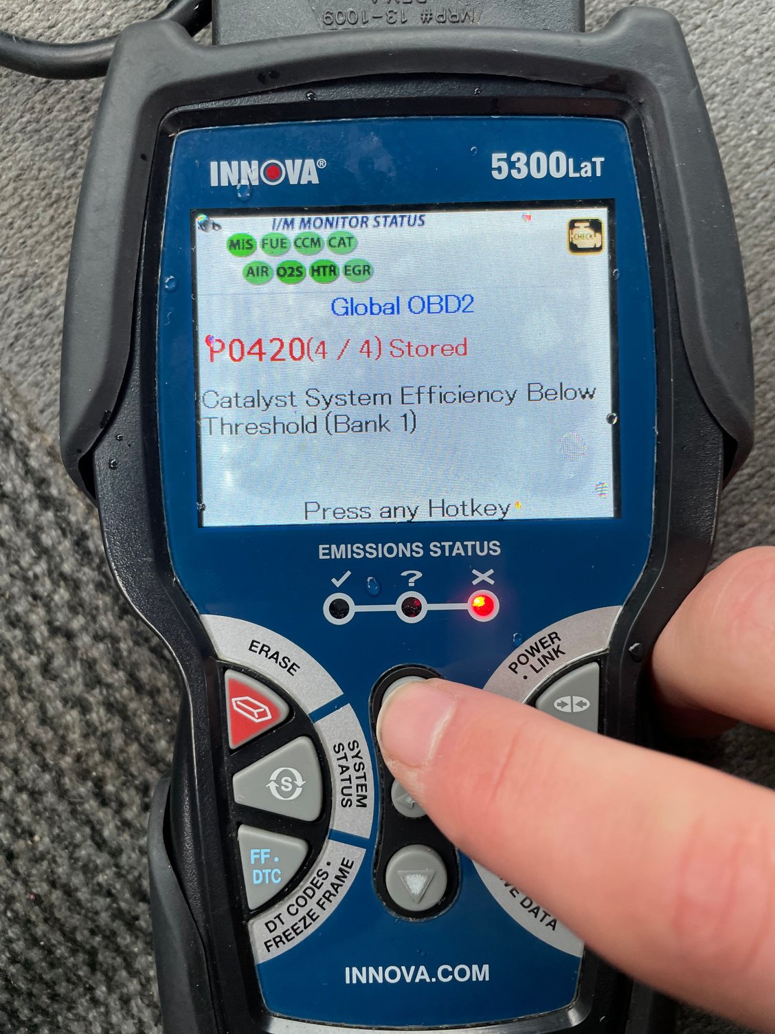

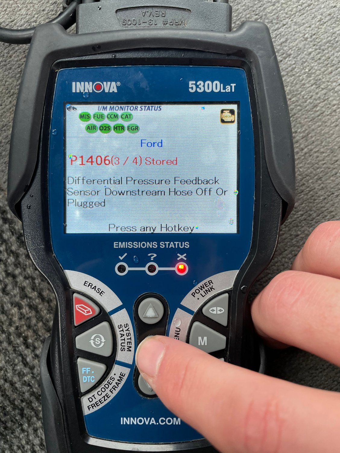

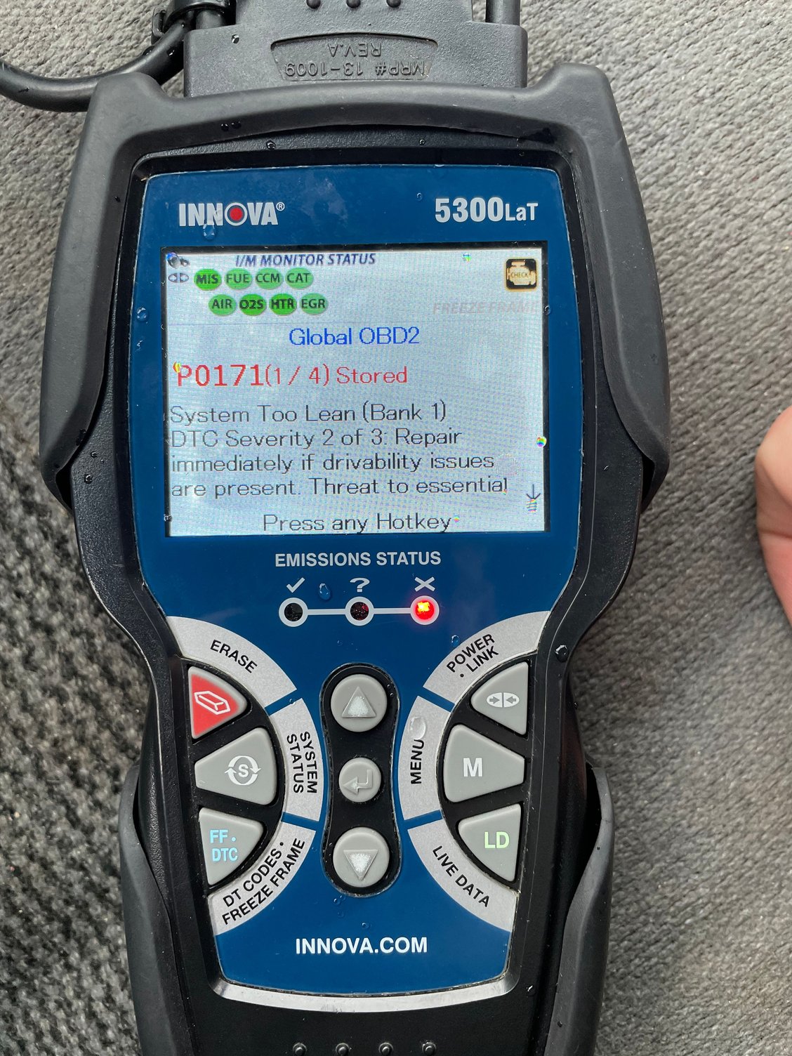

well here are the codes currently. I will google later to understand them

It looks like you have some work to do to fix them codes then the MPG may get better.

I would guess on a plugged cat with those 4 codes all together.
The 31 tires aren't going to help mileage either.

Looks like You need to spend more time checking what you have and fixing problems BEFORE asking questions.
These guys on here are a GREAT source of information BUT it is hard for them to answer questions when you have not done your homework first. (how many converters on my truck) get under there and look.
You have codes up the _____ and not sure of your mileage and asking these guys on here why you have bad mileage???
I think everyone here is always willing to give great advice but we probably should help ourselves first.
Have all codes cleaned up, know exactly your mileage, then if your gas mileage is what you think is bad ask for input and ideas. You will then receive excellent ideas of what the problem may be.....
My .02 worth..
