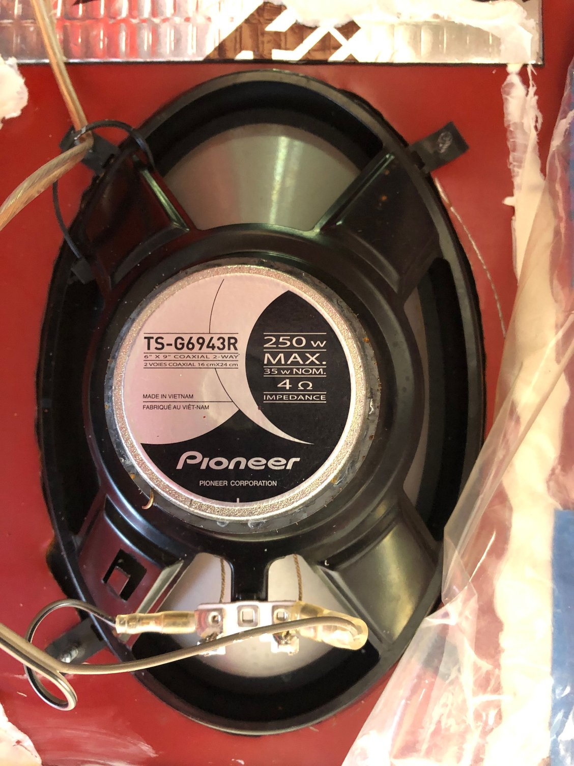

I have a RetroSound radio unit with some Pioneer 6x9 speakers in the lower door panels. The speakers aren’t high end but they are 2way and should be good enough I suppose. They sound pretty crappy in the doors. Is there a way to improve the acoustics in the big farm truck doors? They are mounted to the lower panels. Sheet metal probably isn’t the best sound box.
any suggestions?
TIA
