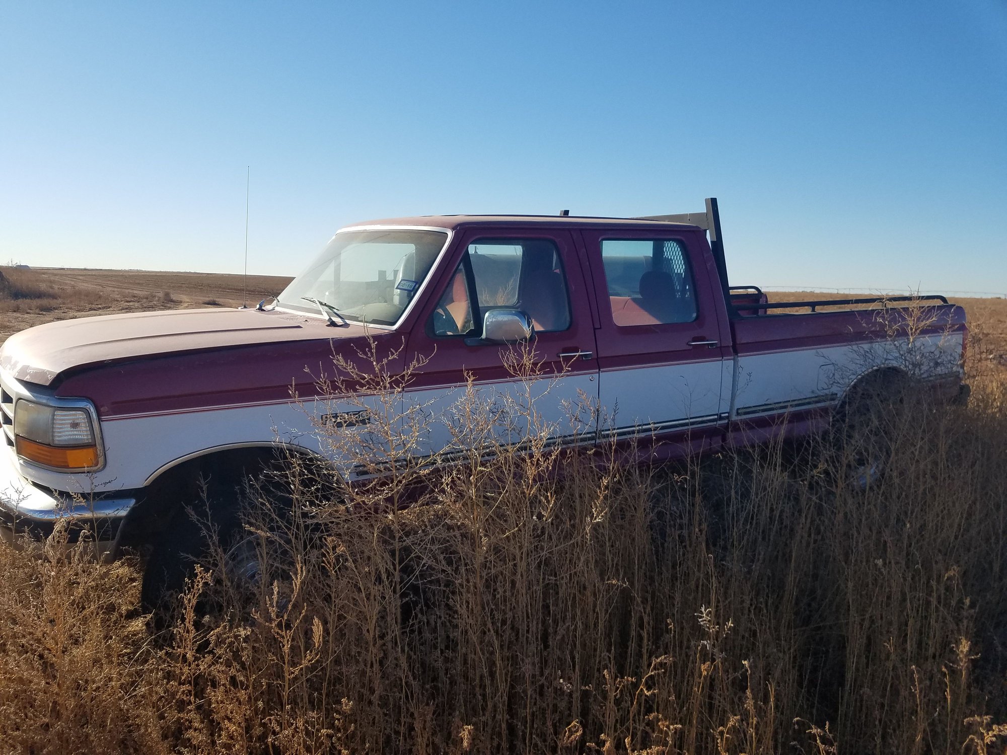

Howdy from Texas, I am new to forum but ill be around because... I just purchased a pretty rare truck to restore and had a few questions. This is the 2nd ford I have owned (the first being 20-30 years ago) so I am going to be learning and leaning on you experts. I was doing an inspection of farm equipment for my job and ran across a gem in the weeds. A 1994 crew cab 4x4 7.3 IDI automatic in EXCELLENT condition, electric windows, 2 tone paint in really good condition. Ive been looking for something like this for years as I loved my other ford, I know how few of these are around. Especially in this condition and this price. Most I have seen over the years were high dollar and had the 460.
The owner died in 2016 and it has been sitting in the pasture ever since. There are no dents, dings, rips, tears, scratches anywhere on this truck. The deceased owner's family member sold it to me with a clean title for cheap (i think i could triple my money today if I just cleaned it up) but my goal is to fix it up and drive it daily. He said "as I recall it was running when he parked it here, then he got sick and nobody has touched it since."
There are problems though, rats have built a pretty substantial nest under the hood. There are NO keys (so i dont know how many miles are on it, the owner bought it new with cash) . He has no idea where the keys are. There is about a half inch of dust in the interior as this was parked by a farming field. I have some questions that you guys may know.
1. The decal says F250, but I'm thinking this is a replacement because I always thought crew cab 4x4 single wheels were all f350's?? Is it possible it is a 3/4 ton?
2. It looks to be a NON TURBO. Under the rats nest you can see a air filter cover, sort of like what is in a 90's Chevy 350. I did not see a turbo on top. So is that a correct? I always thought 93's and 94 IDI's all had turbos. Maybe somebody took it off? Can/should I add one after I get it running? are they gutless without one? The f250 I had in high school was a 1990 non turbo and it would only go about 55-60 pulling a trailer, and you had to hit a hill pretty hard. Very good truck though. I really liked it but I was 16 and didn't know better.
3. The automatic. From memory, these overheat i think. The owner's family member told me the transmission was replaced a few years before it was parked. My 1st truck was a manual. Are there suggestions there?
4. The rats nest in engine bay.. where do I start as far as checking for damaged wires, etc.
5. What do you suggest on keys?
The truck is still in the pasture as I just bought it and need to go get it. Please give me some input of where to start.
Plenty of crew cab 4x4 single rear wheel trucks were F-250s.
There were a few turbo IDIs made, but most were non-turbo.
A locksmith. It will be easy and not very expensive because these are not chipped keys.

Thats a very nice find and a great looking truck. Easiest way to spot the difference between a 9th gen 4x4 f250 and a 4x4 f350 is the front axle. F250 got the twin traction I-beam front axle. F350s got the dana 60 solid axle.
The old non-turbo IDIs arent power-houses, but theyre decent. They'll comfortably pull a 6000lb trailer in the hills with out complaining. A turbo will help out alittle, but cooling system is the limiting factor.
The E4OD transmission is decent. Keep the trans temp below 200 and itll be happy. Most problems with these transmissions are electrically related and easily fixed with a few sensors.
If its been sitting in a field for 4 years, the diesel fuel is probably full of algae. Itll drive you nuts trying to solve fuel system problems. Its best just to drain it out and start with a fresh tank of diesel.
The mice problem is a bummer, but not a deal breaker. Shop-vac out all the loose stuff, and power wash the engine compartment clean. Theres nothing in theres thats sensitive to water except the intake and the noise-absorbing pads on the fenders and hood. Just use common sense.

Just replace the locks. It's quite easy to do on these trucks. And they're available everywhere (my Autozone has them for the doors ($45.99) and ignition ($18.99). Cheaper than a locksmith!
When I got my truck it was a non-turbo. It wouldn't win any drag races but it would get you there eventually. I bought a complete factory turbo setup and installed it with a Banks downpipe. Turned up the pump just a little to match. The 7 psi boost makes a big difference.
