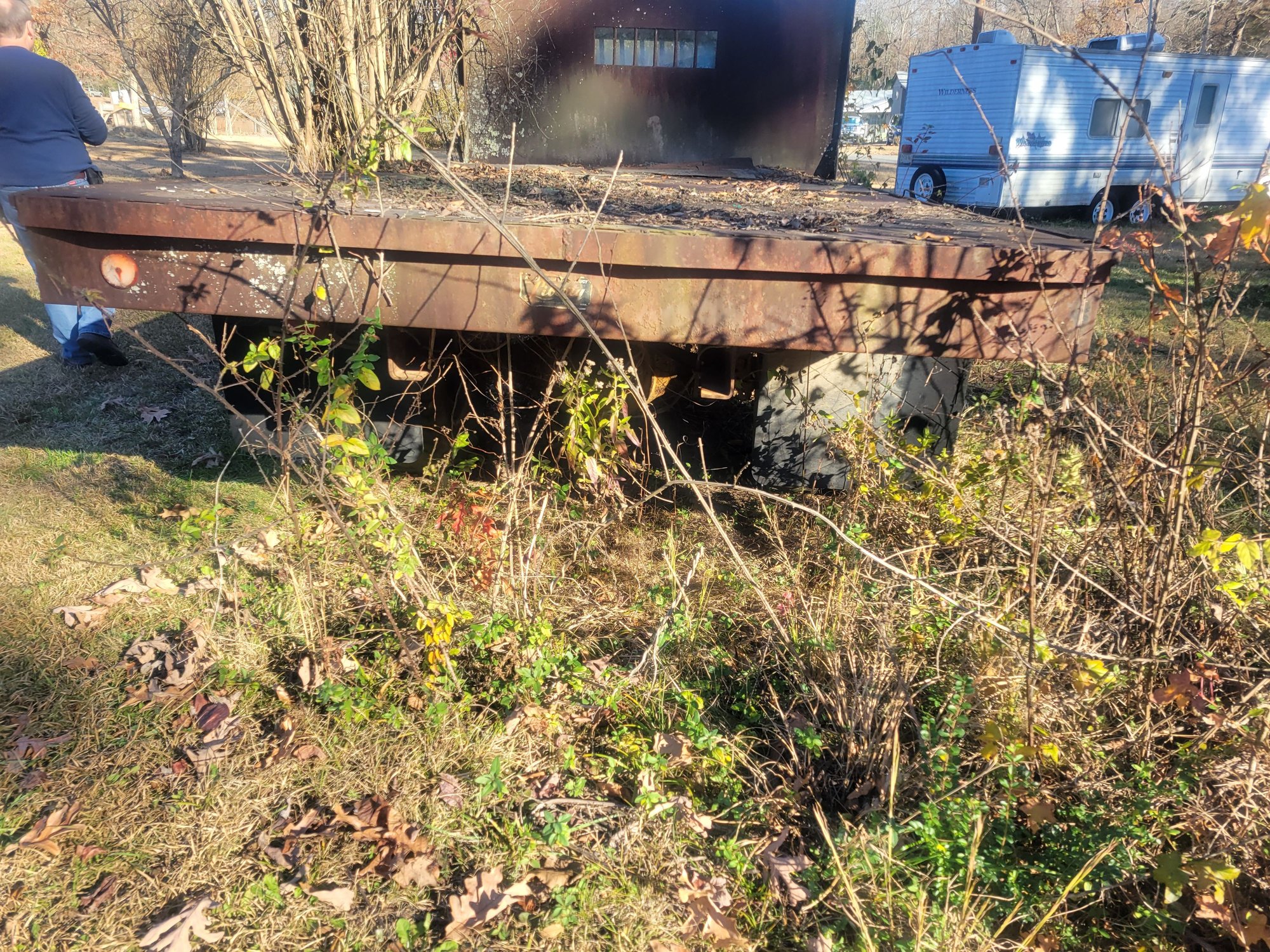

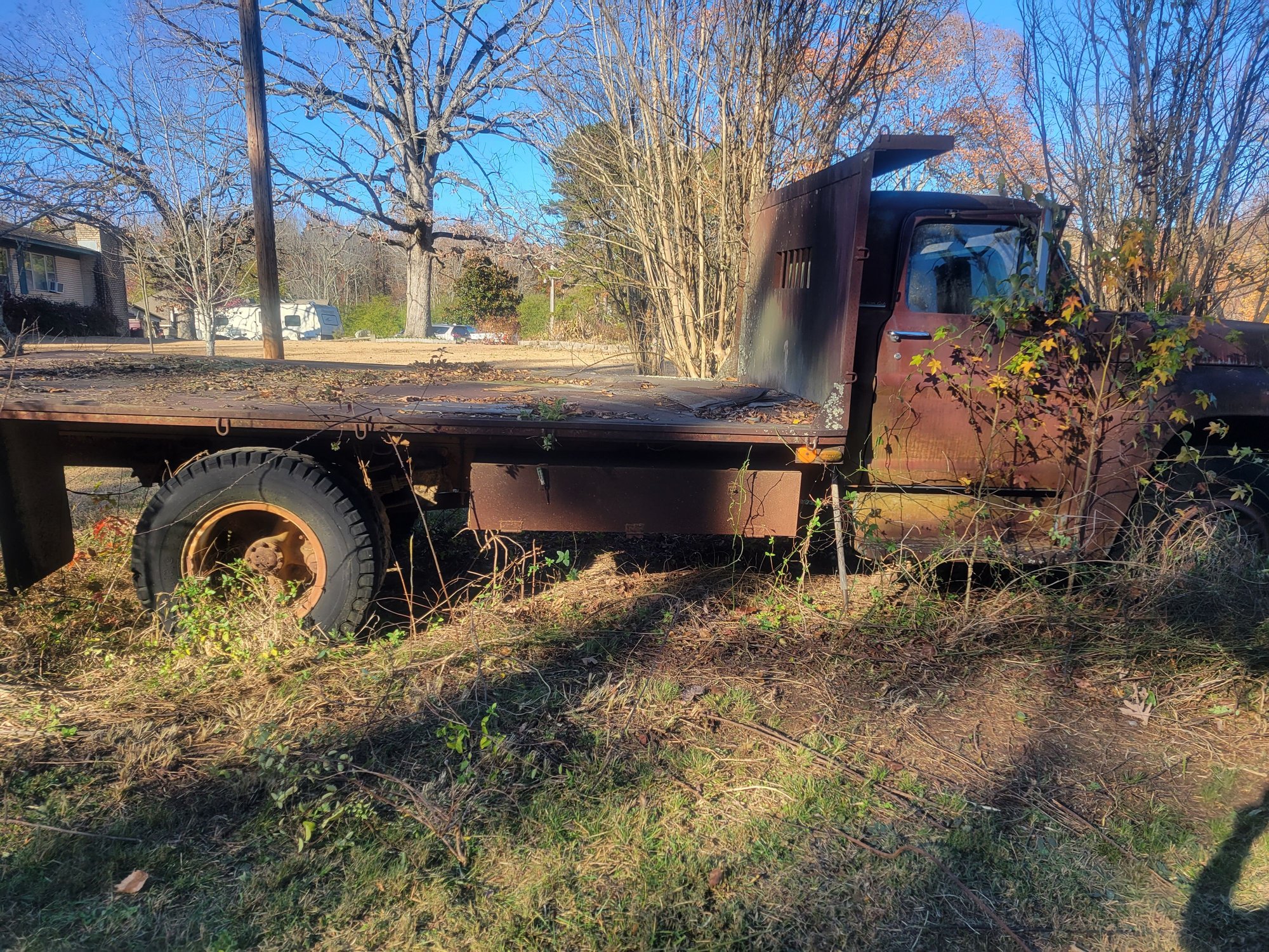

I inherited this F700 from my grandfather and am wanting to restore it and put it in service in my business. I need the Vin decoded to know where to start. If any one could do it I would be very grateful. VIN# F70DUB42915
