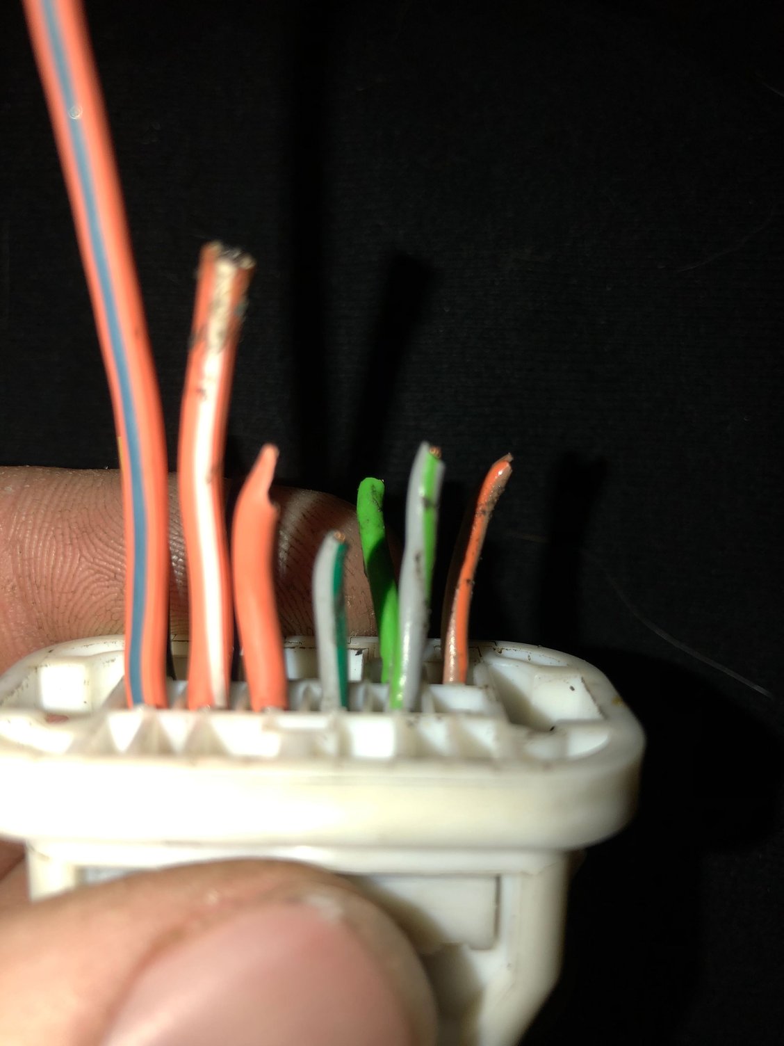

Very common for the wires to break between the cab and rear doors, I would pull back the rubber boot on the rear doors and see if any of the wires are broken(most likely some will be).
This is from a dodge rear door but same thing happens, this one only had one wire connected still, all the short length ones broke.
