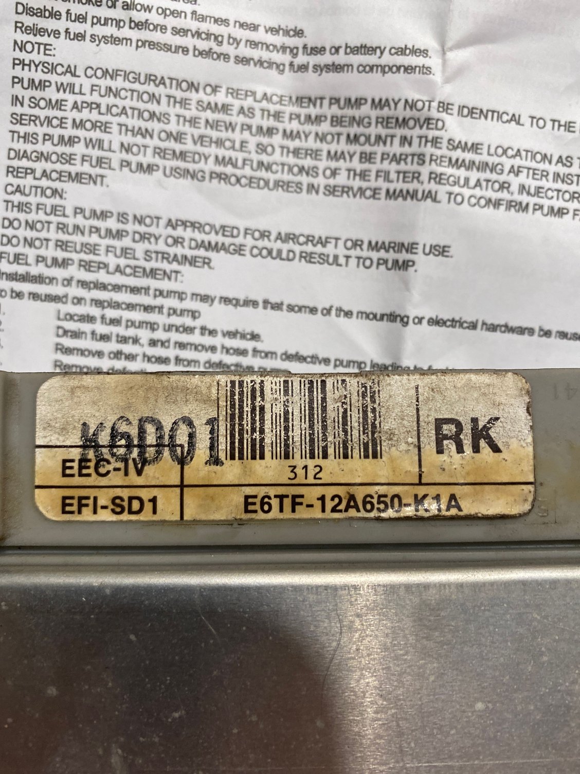

I’m am trying to find a new ECM for my 86’ 302 5.0. E6TF-12A650-K1A. I can find replacements that end in KA but not K1A. Can anyone tell me if the KA replacement will do the trick or do I continue trying to find my needle in a hay stack. The reason I am replacing it is I have replaced just about everything on the fuel system I can replace. New pumps(all 3), tanks, filters, reservoir selector switch, injectors, coolant temp sensor, EGR, complete distributor, fuel regulator, plugs , plug wires, checked for grounded wires. I am getting a code 31(EGR valve position sensor out of range)). Truck starts when cold but but won’t stay running then will not start again. Fuel pressure is 41lbs. I am no mechanic but my brother in law who is has been helping me with it and he is stumped. All he can think to do is replace ECM but I can’t find an exact match.

To answer your question about the ECM, K1A and KA are as close to an exact match as you'll find. Those suffix characters are denoting revisions, probably just a code tweak. My '86 truck, manufactured 10/85 has a A1A suffix. Your truck probably has a much later date of manufacture. I would not be afraid to replace my A1A with a KA. Both still perform the same basic functions.
These computers are known for crapped out capacitors. There are three inside this unit. Their job is to keep the power flowing smoothly to the computer systems. They can be replaced if you are experienced with de-soldering and re-soldering on a circuit board. Three new capacitors cost about a dollar. Or you can just throw another new part at the problem.

Thanks for the information on the ECM. Not sure about the O2 sensor but I’ll check that out before ordering the ECM
There is the ID number marked on the part...and the actual part number:
E6TZ-12A650-KA .. Processor Assy / Marked with ID number: E6TF-12A650-K1A or E6TF-12A650-K2A
Rock Auto has remanufactured processors.
