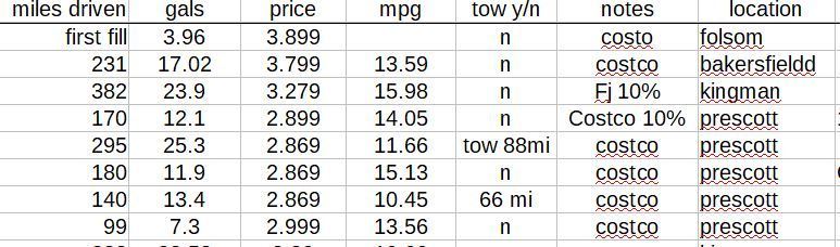

Here's the data encompassed in the first 1500 mi. The 88 mi tow was a test run from 4400 ft to 7000' over 44 miles and the return trip. The 66 mi tow was a test run from 4400' to 5400 ft over 33 miles and return.
Note the mpg that included the 88 mi tow is higher than for the miles driven with the 66 mi tow. That's because the 88 mi is a smaller % of the 295 mi driven than the 66 mi tow is of the 140 mi.
I might have done better with the over all mileage on the 88 mi tow. But I wanted to see how much faster I could get up a couple of steep grades over the other 2 trucks. It was substantially faster and made me smile.
This is the story for the miles I've put on it:
total miles 3020; total gals 283.47; total mpg 10.65
A note on fillups. I fill until the auto shutoff activates and then do two more about 15 seconds apart. That gives me pretty consistent fill data. I don't top off because in past vehicles it can cause problems with getting fuel into the carbon fuel vapor recovery canister (if it still uses one).

bankstruck, thanks for the additional info. I am kicking around ordering a F250 / 350 with 7.3g and researching what gear to get the best mileage. I don't tow anything of significance (dirt bikes mostly on an open trailer). I would like to add 35" tires tho, so every reply I've seen in searches says "go 4.30", but from what I've been able to find and read, sounds like the trucks getting the best mpg are 3.55 or 3.73 trucks (at around 16+/- mpg). Going to 35" tires is the kicker tho, as it drops a 3.55 down to 3.27 and a 3.73 down to 3.43. Ideally, I'd go F350 to get the 3.73 and add 35" tires, BUT..........my insurance says that may bump me to commercial policy, which I'd rather not deal with.
I've fed my current GM 2500HD 6.0g 4.10 at 10-12mpg for the last 18yrs and would like to see higher mpg if possible. I really think 4.30 would be overkill for my uses.
