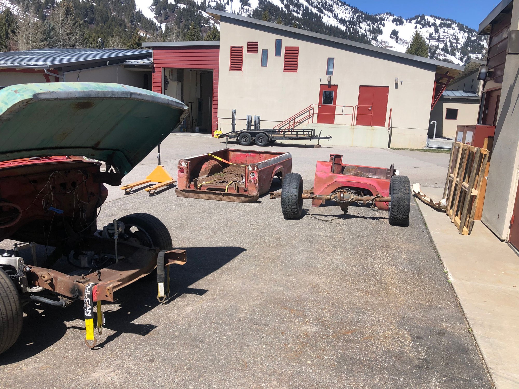

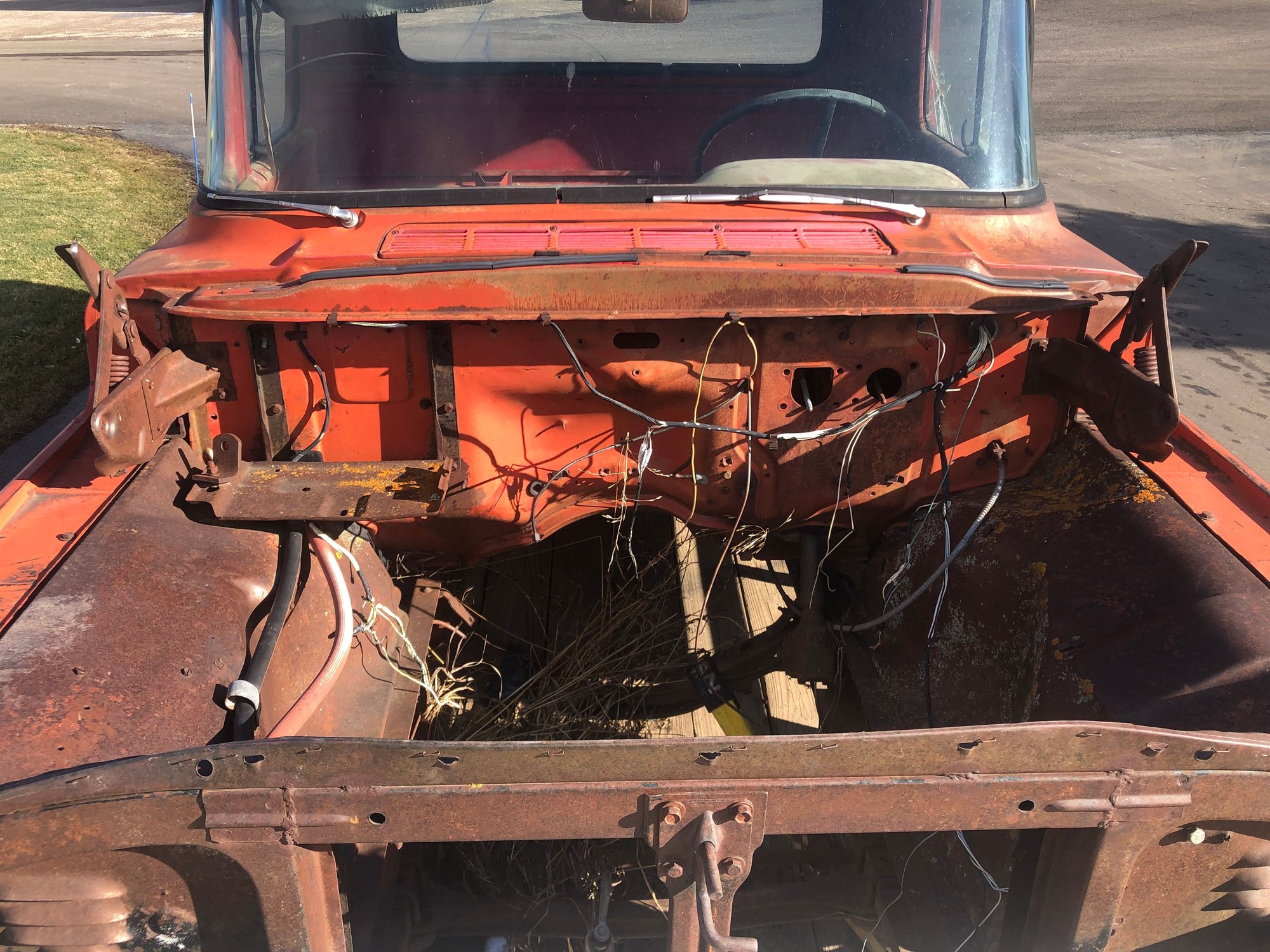

Deconstruction continued today. Rear spring hanger rivets didn’t stand much of a chance against the plasma. Oddly the bed gave me the most resistance. The bed still had dirt in it, so I looked underneath for the bolt locations. Mid bed was easy enough, but the ones under the rear of the tailgate made me work for it. It was a little tight for the plasma to get to the bolts. The very front ones were sneaky, because they were out boarded. All the others were nicely lined up on the inside of the c channel. Once they were discovered, the plasma took care of the topside and they all but fell out.
Here’s the pile for today.
Is there any value to the old front axle and suspension? I ask because I could kick my younger self for what I threw away from my FJ40!!!

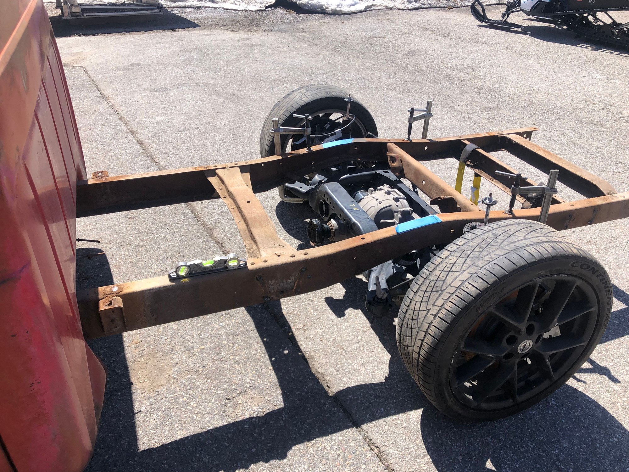

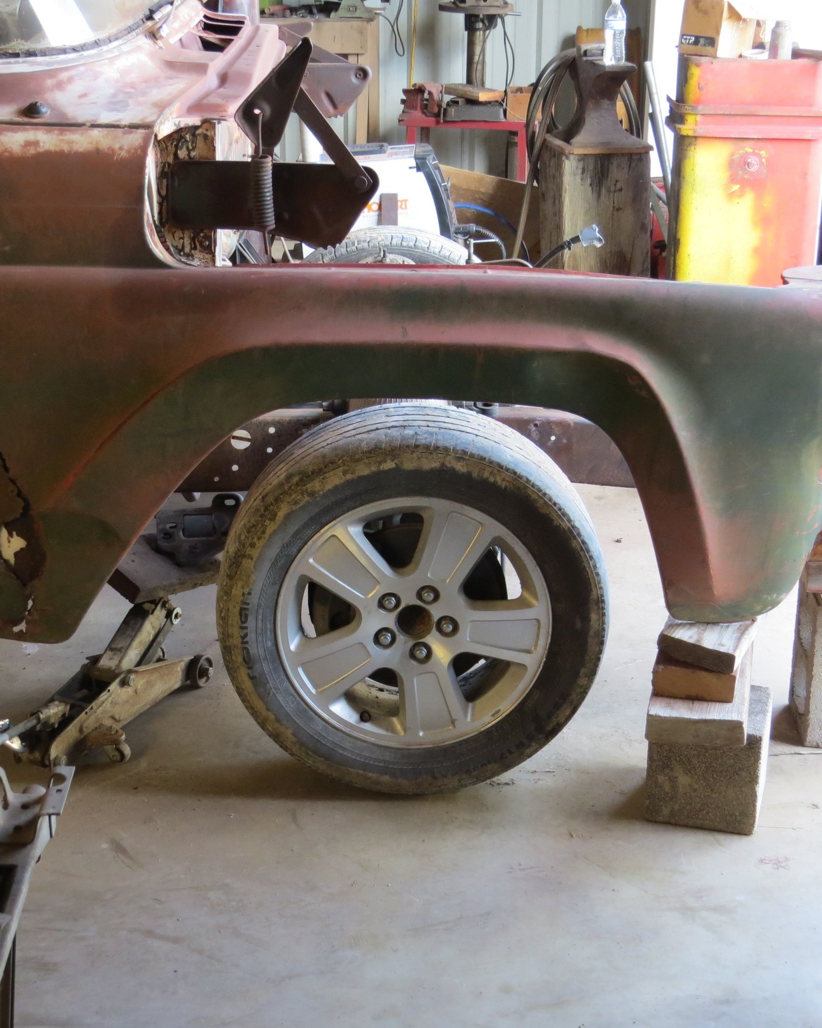

So here’s the rough placement of the CV front end. I found my center of the wheel well and marked the frame before removing the front clip. I’m open to all ideas and or criticism on this.

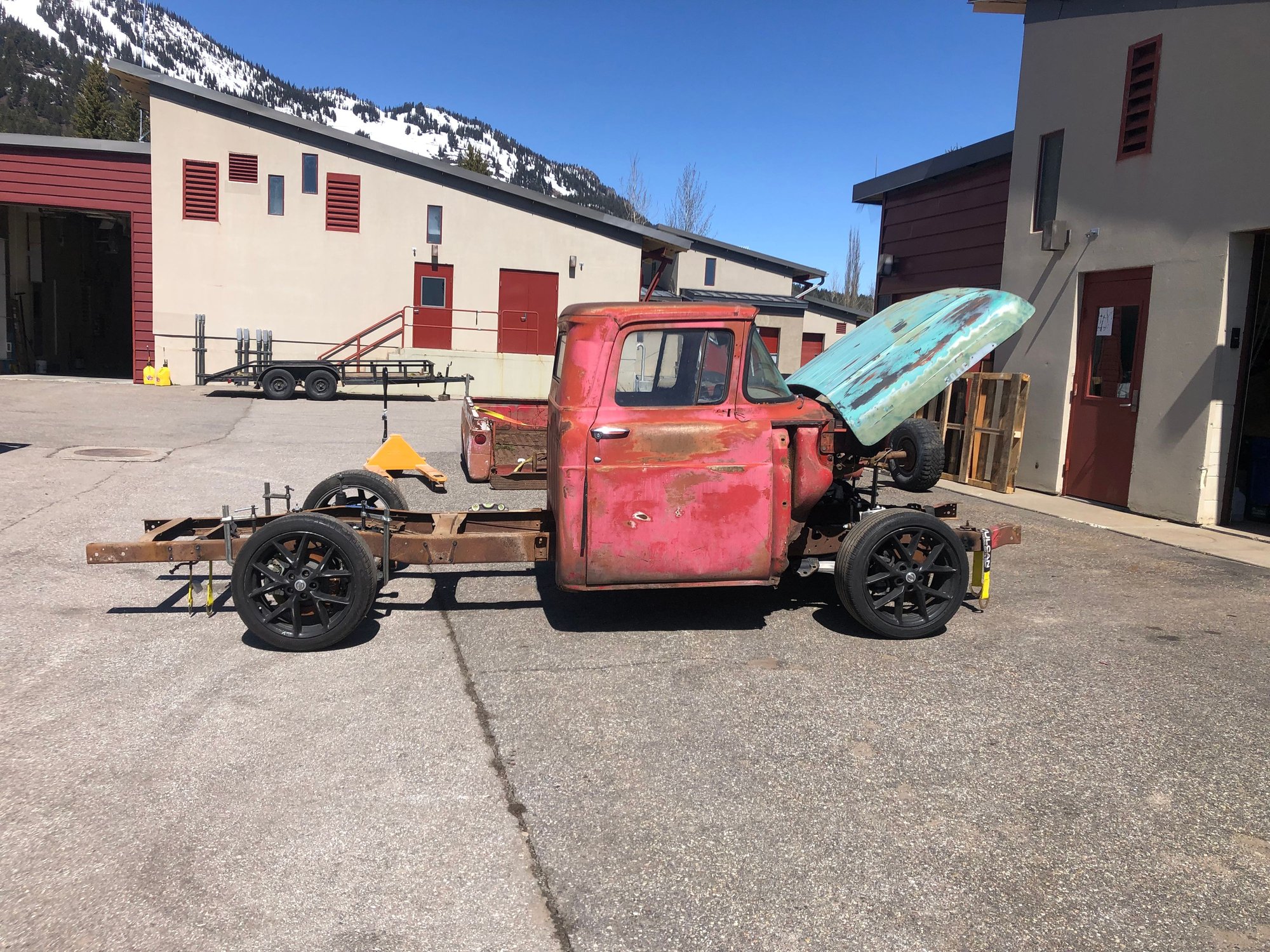

The Mustang IRS pretty much slipped into place. Just sitting without any upper coil bucket, makes the drip rail over the door sit almost level. Everything is simply clamped in place, which means it’ll likely change some what. I do want the truck to sit basically level, I’m not fond of the stink bug look.
So this where I made is to today. I like the stance and height. Everything is subject to change right now though, it’s just clamped in place.

Some folks including me set the front axle 1" or so forward of the stock location to better center the tire in the opening.
Good luck with the project.
I bolted on a
fender and centered it that way.

My plan is to put the bed and front end back on before I mod the frame. Then I can pull those and the cab off, at that point I’ll be able effectively clean the frame. After that I’ll be able to box the frame end to end.
