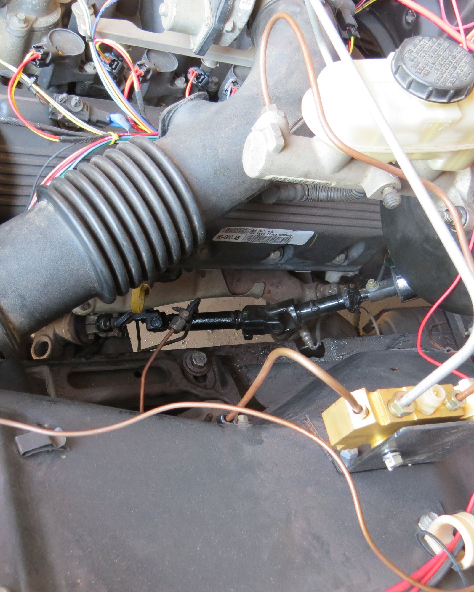

I used parts from the CV steering to hook to the rack and pinion. Cut and welded and got it to work.
That looks doable, unfortunately I don’t have the donor car to pull from. I’ll start looking for other sources. Hopefully explorer have some usable parts as there a ton of them in the local yard. Is there a collapsible section on the linkage?
Old Feb 16, 2022 | 09:22 AM
  #48
Ibex's Avatar
Ibex
Joined: Feb 2021
Posts: 283
Likes: 56
From: Bandera, /texas
The joint next to the Rack will flex some. But not like collapsible if you wrecked.
That does look like a tight fit for what I did on my last project. I’ll get there sooner or later.

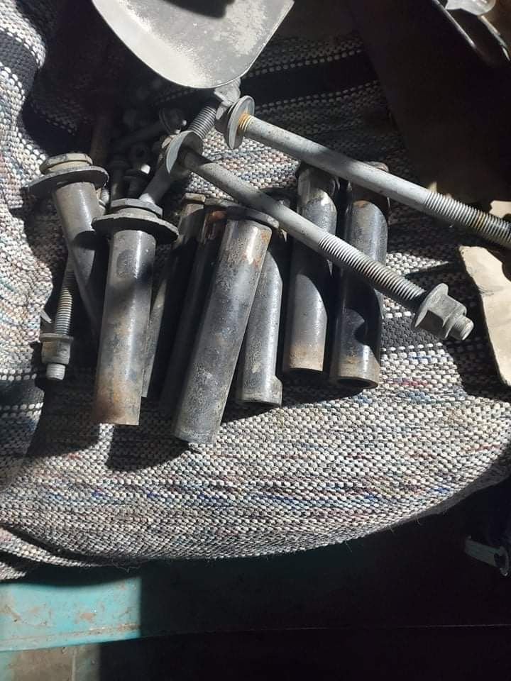

I’m new to the Vic front end so as much as I look these pics over I can’t seem to find anything concerning. Anybody with more experience have a minute to check them over?
If anyone see a reason why I would want to grab one unit over the other let me know.
Frame tubes and bolts. Speaking of bolts, my YouTubing has me under the impression that these are one use bolts- correct?
Thanks

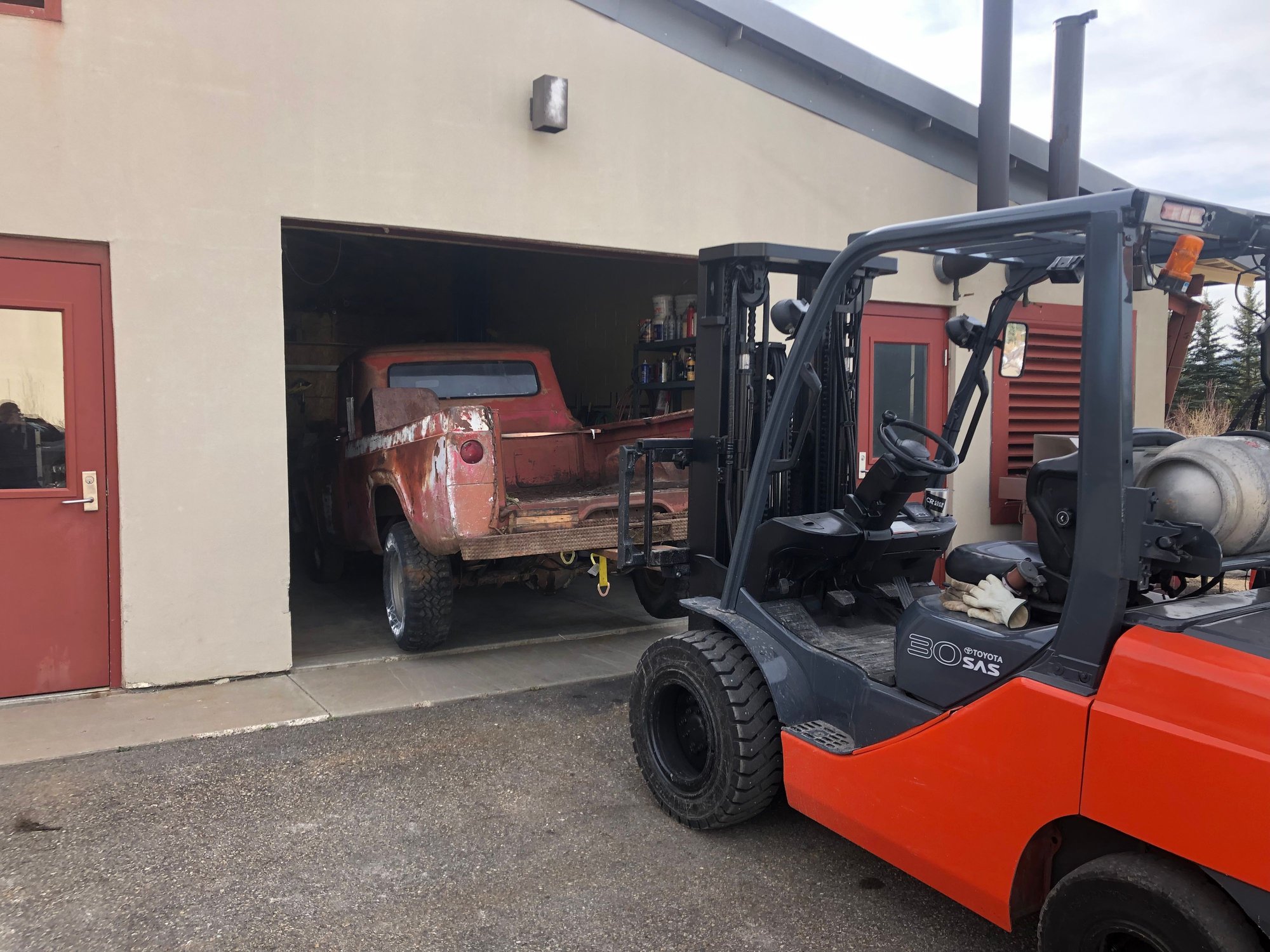

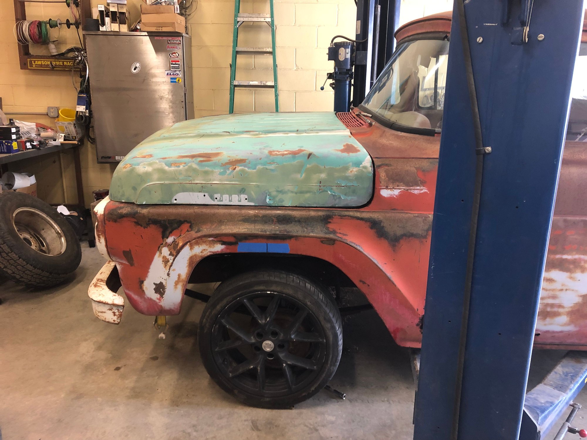

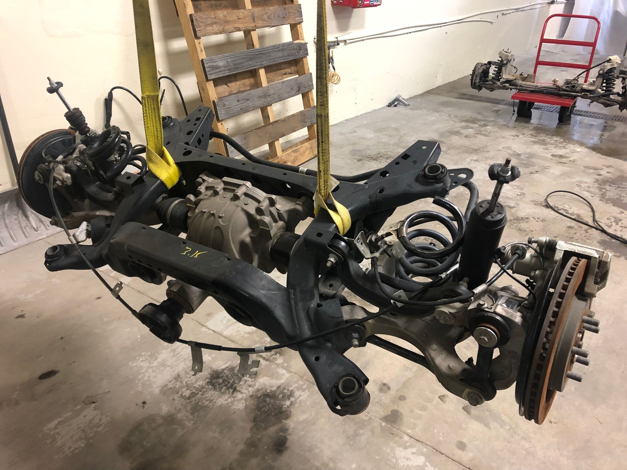

I hope your right, ‘cause I bought the front one. All kidding aside, I bought front one. It looked to be in better shape in person. The other one had what looked to be a boogered rack and pinion, so the choice was easy.
Since I bought it and a Mustang IRS…
…I might as well buy some wheels. (Obliviously, this is just mock up). The wheels were cheap enough to justify as rollers, so they’ll do. They have their own kind of patina- bald mismatched tires and peeling paint…
Into the shop at work it goes- with a little help from the forklift.
