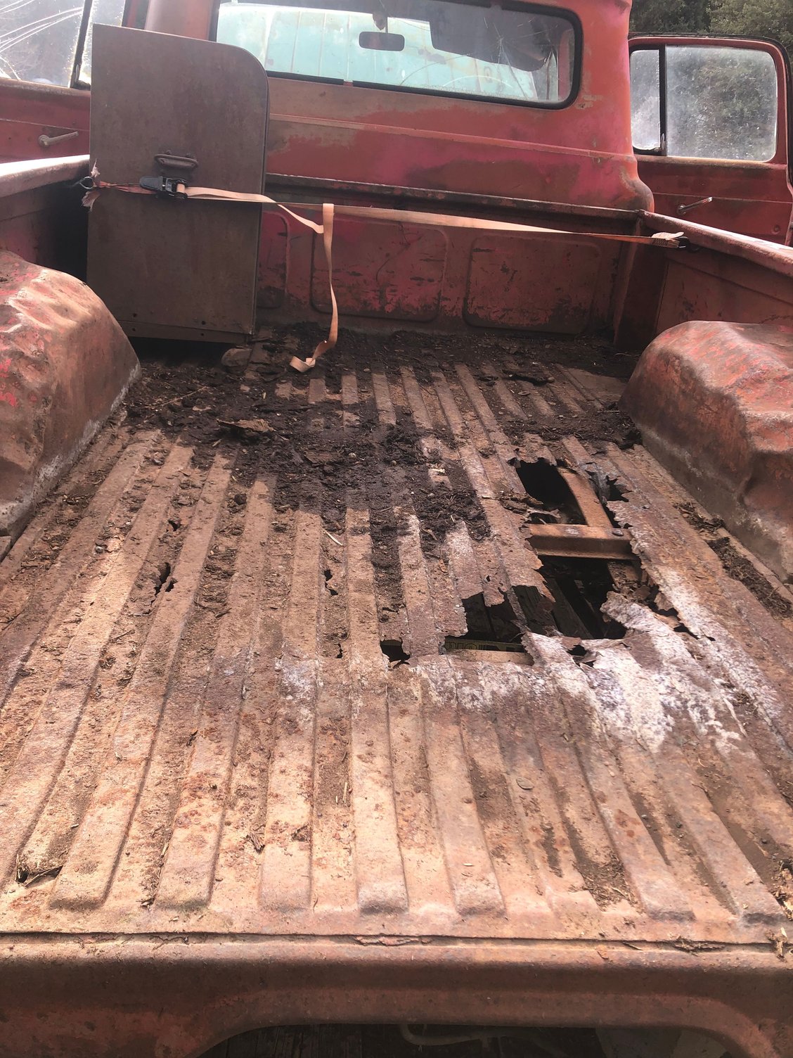

While I under the truck, I snapped a couple of the underside. I had tried to get a look when I inspected it before the buy, but the tall grass didn’t lend itself to a complete picture. I was pretty happy with what I saw. Cab corners took some abuse at some point, but they’re solid.
As mentioned the bed floor is toast. I think the supports will be alright. Started thinking about a wood floor and how nice they look. Then I think a fancy wood floor will clash with the “patina” character. Time will tell I suppose.

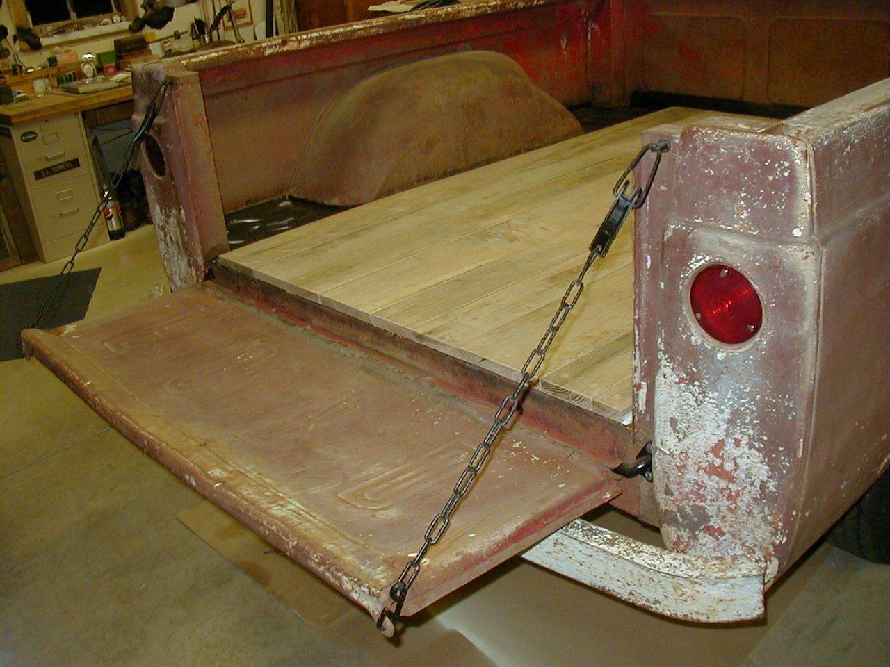

My bed was totally shot as well. ended up putting some white oak from a local mill at random widths. Very durable. I pit a couple coats of water seal on them but this truck doesn't really see any bad weather unless it is raining the day I have to take it for inspection. lol Here is what mine ended up with :

That looks good. A wood bed is definitely on the list- possibly distressed wood? Something to match the patina. One thought is my kid wants this truck for shuttling bikes, so it’ll need to be moderately durable. It’s tempting to tackle the bed first, simply to avoid the tetanus infection that are waiting happen.

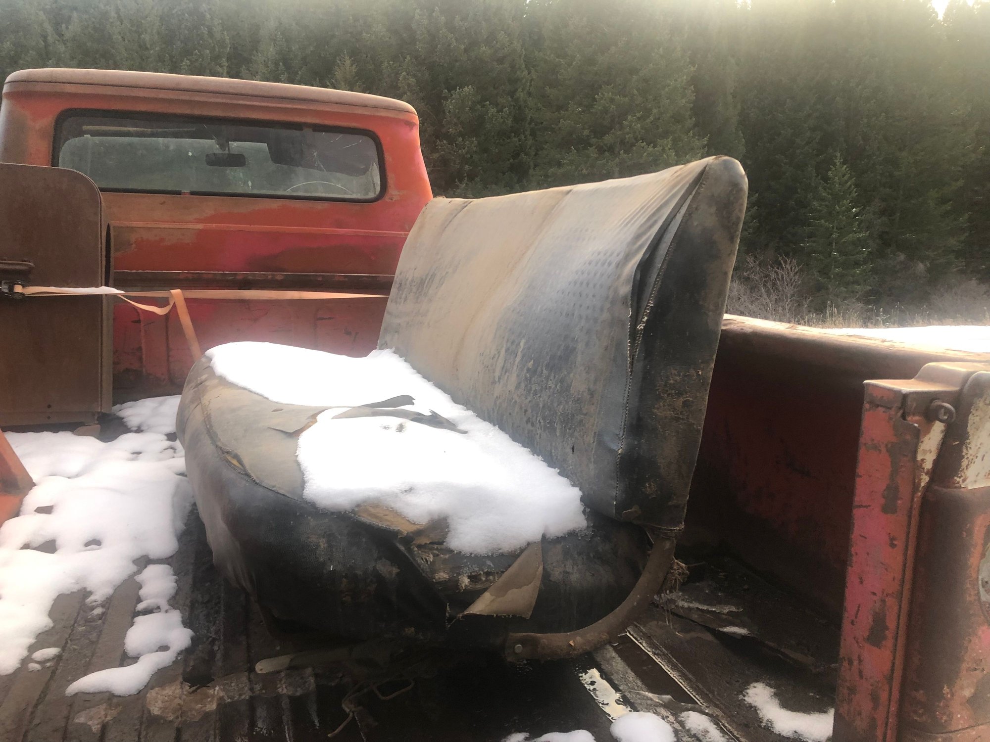

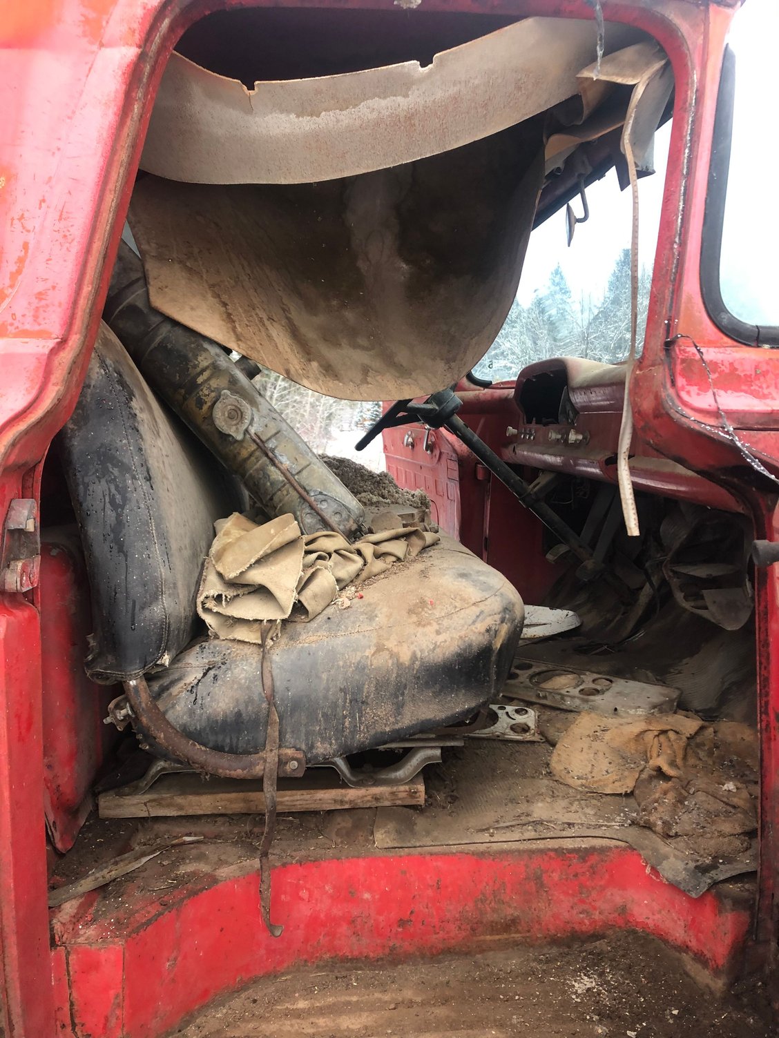

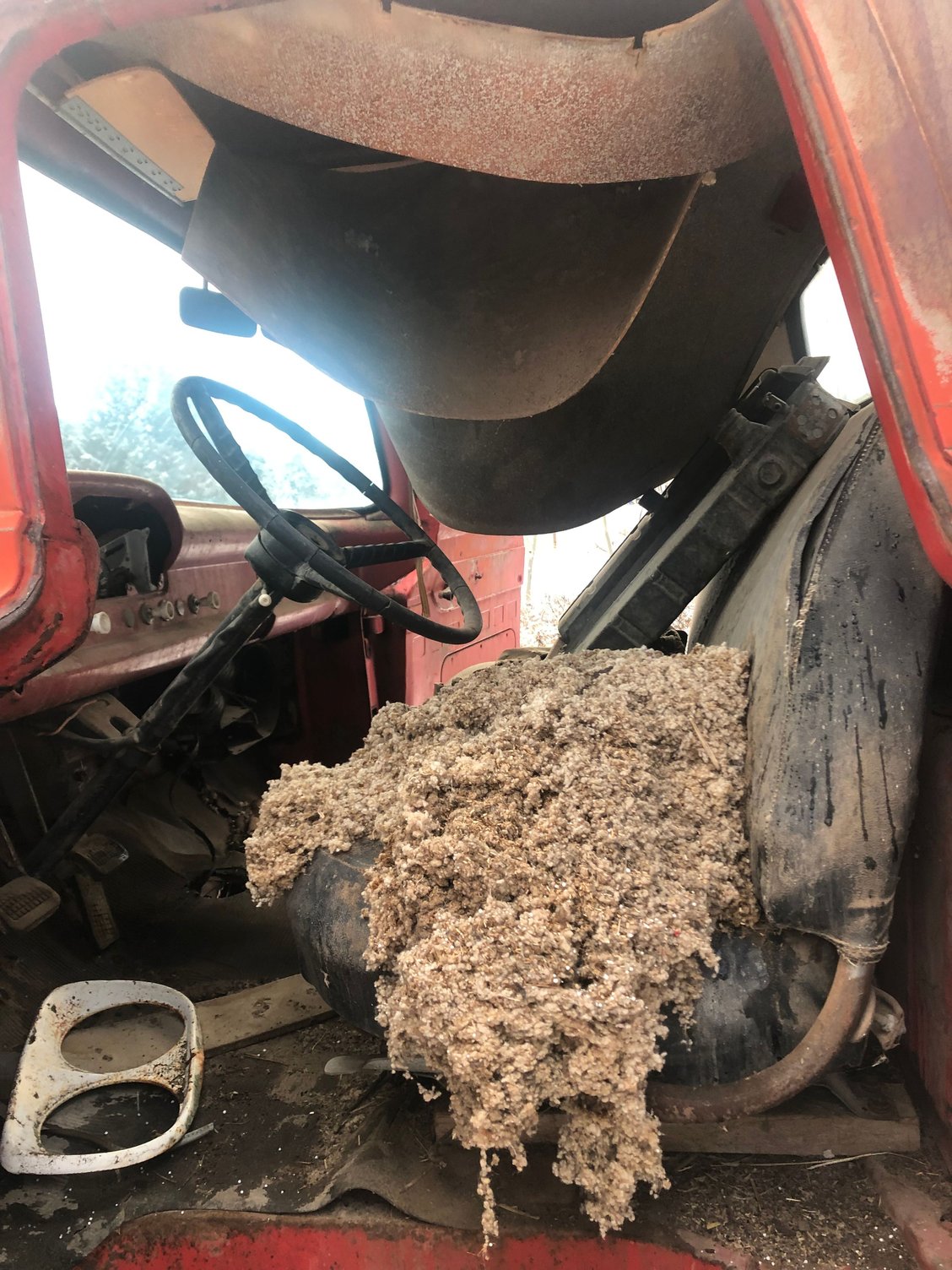

Seat value ?
So the seat that came with the truck is in pretty bad shape. The mice had been allowed to nest in it for who knows long.
Their best seems to have centered around the drivers side.
Passenger side is better, but brittle.
This is how sits after cleaning out the nest and a layering of white stuff.
Currently it’s blocking my ten year old from falling through the rust holes in the bed. Also I wanted the mouse house out of the cab for the winter.
I hate to throw anything away from the truck, but I am not sure this would have any value. I considered mounting it in the bed for the drive in, but it needs a serious rehab. Is there any value in the old seat?

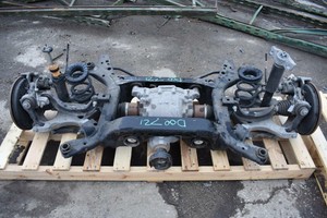

What I would really like to make is an AWD canyon cruiser, so it will receive some modern updates. For the rear end, I’m leaning toward a ‘15-19 mustang got irs assembly. (I like the fact that it’s a complete suspension, brakes, axle and there should be plenty of aftermarket upgrades for it in the future).
