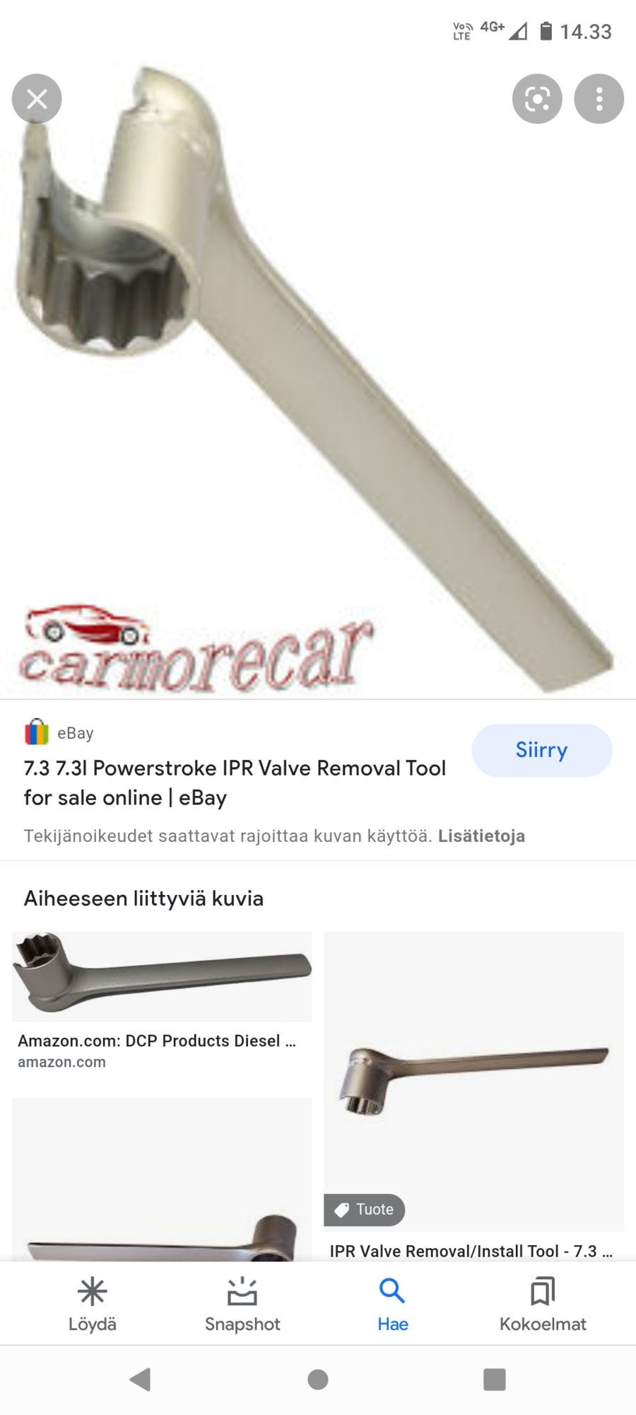

You can actually buy an IPR tool. Fabricating own is also an option.
