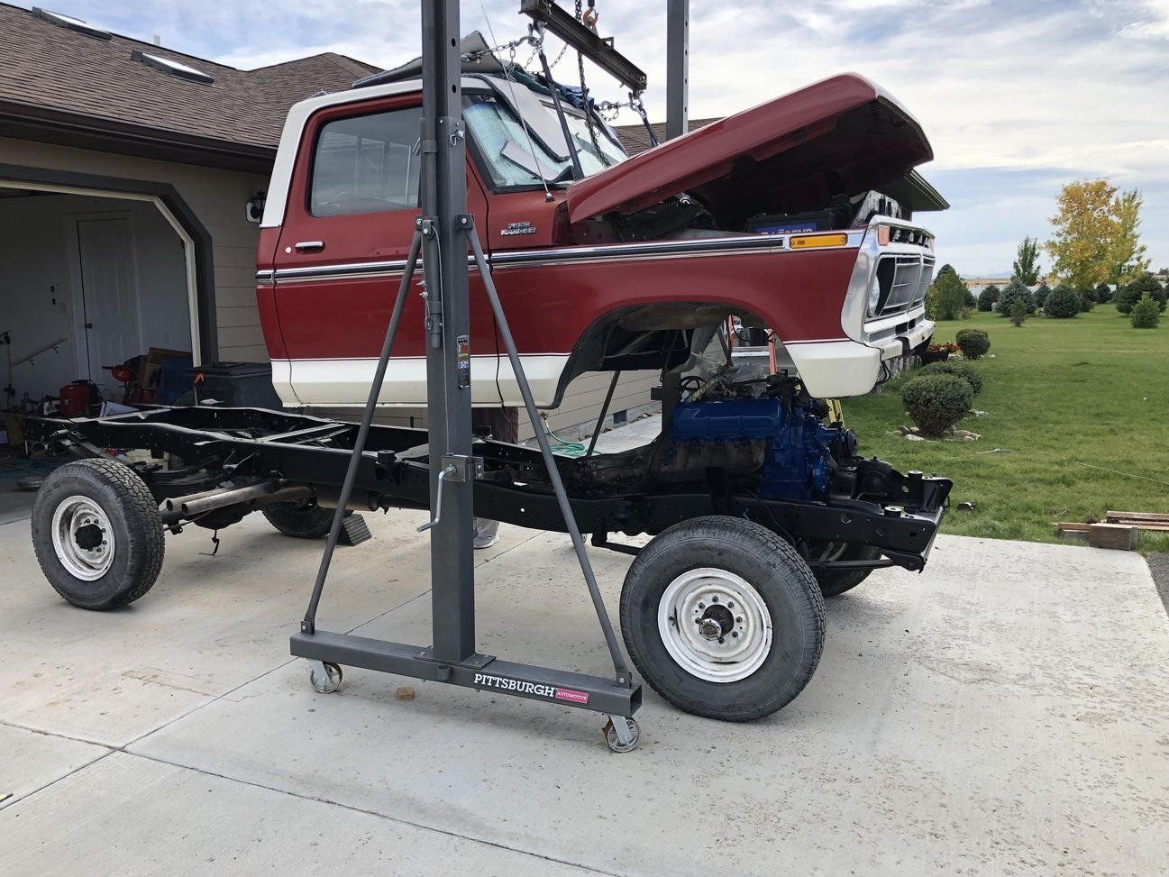

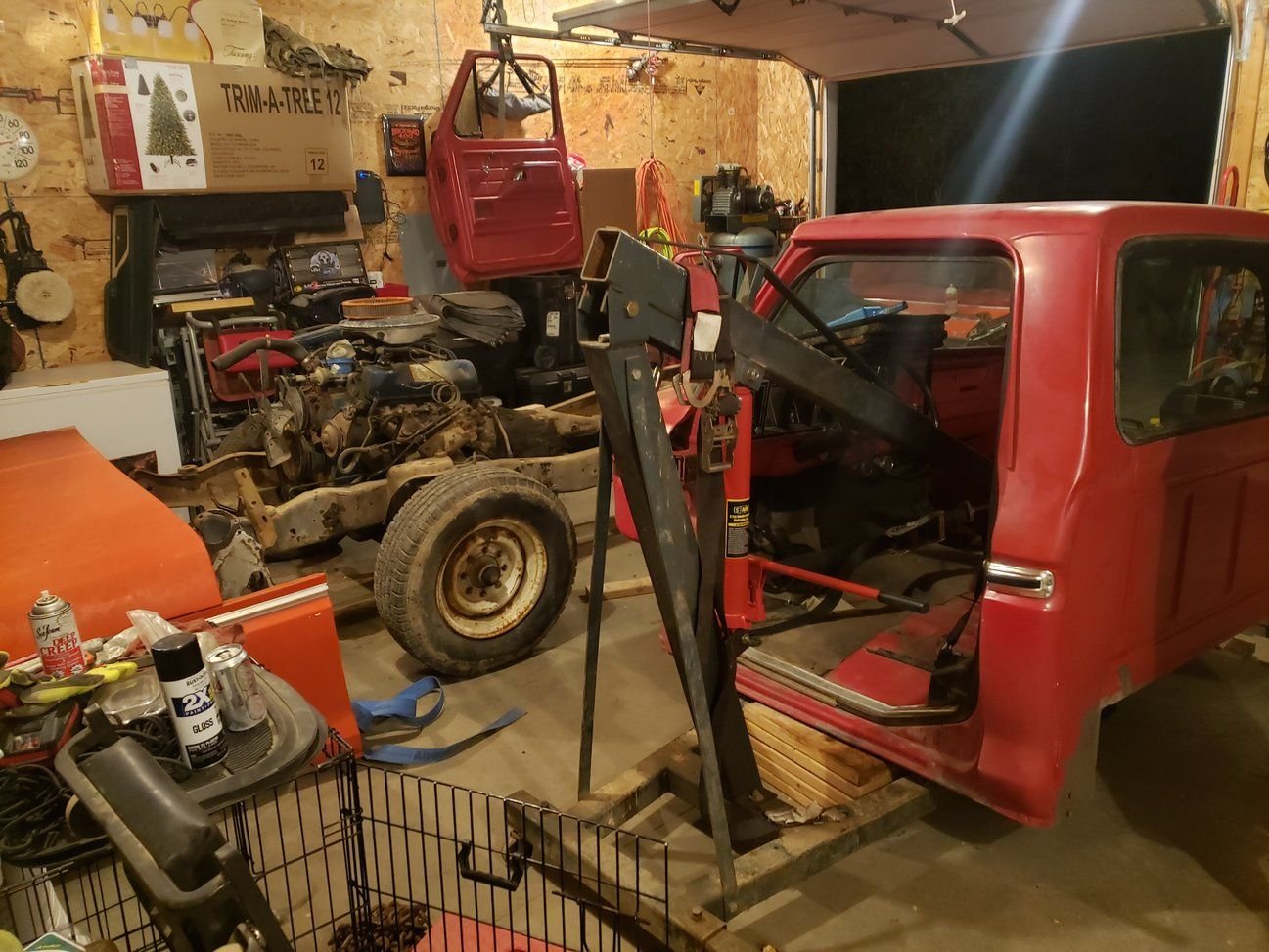

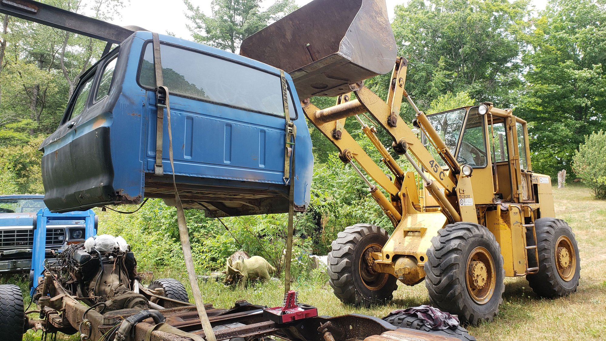

Well here are some fine examples on how to rig it. https://www.ford-trucks.com/forums/1...l#post14696917
Use the seat belt attachment points for the rear. Are you pulling the doors to lighten it? Then maybe go around the the lower fwd corner cab and come in the lower fwd corners of the door opening and across for your fwd attachment point. Use chain or quality HD straps.
