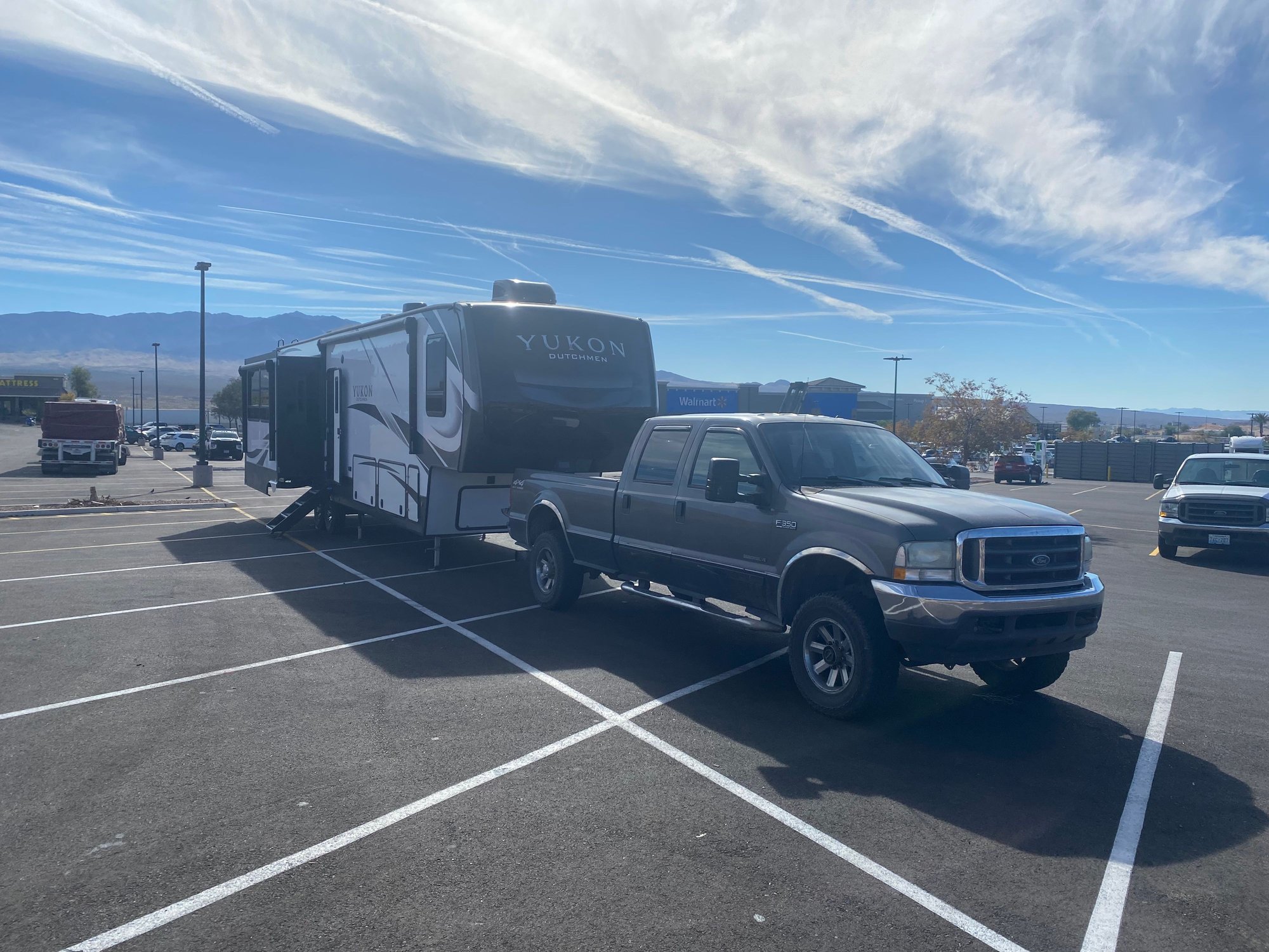

We headed out yesterday for a 250 mile trip to take the 5’er in for some warranty work. Truck was pulling along nicely, eating up the miles just like it did on our month long vacation. Pulling a good grade about 5 miles long, probably 8%. About half way up I noticed a strange chirping/whistling sound. Cresting the top, there was kinda a chug/hop and instant loss of power. Pulled off to check things out but didn’t see anything out of the ordinary, except for the shaking engine. Idle was really rough, no power. Decided to head down the road to gather some more info. Speed at 15-20 mph max under its own power, ECT 220, EGT 175, trans temp 168. Nursed it along for about 20 miles to reach the nearest Walmart camp ground. Cold start this morning and it runs good for 5-10 seconds, then starts the rough running with an instant check engine light. P1316 is the code. While driving on the shoulder last night I put in a call to @Sous for road side advice. Multiple troubleshooting directions this morning with more phone time and multiple texts and we’re kinda at the conclusion the IDM is the culprit. That’s the best we could surmise with the limited resources I brought along on this trip. I’ll never leave my home Valley again without my laptop and FORScan cable! It appears the drivers side bank is shut off for whatever reason. I pulled the valve cover to do the 50 cent mod and it has the valve cover gaskets without the connector inside, so that mod isn’t possible.
Good Sam is taking my trailer to the dealership, my son is on his way with a trailer to load the truck on. Worst part so far is the rescuing truck is a Duramax…
If anyone has any other suggestions to look at, I’m game for the advice.
