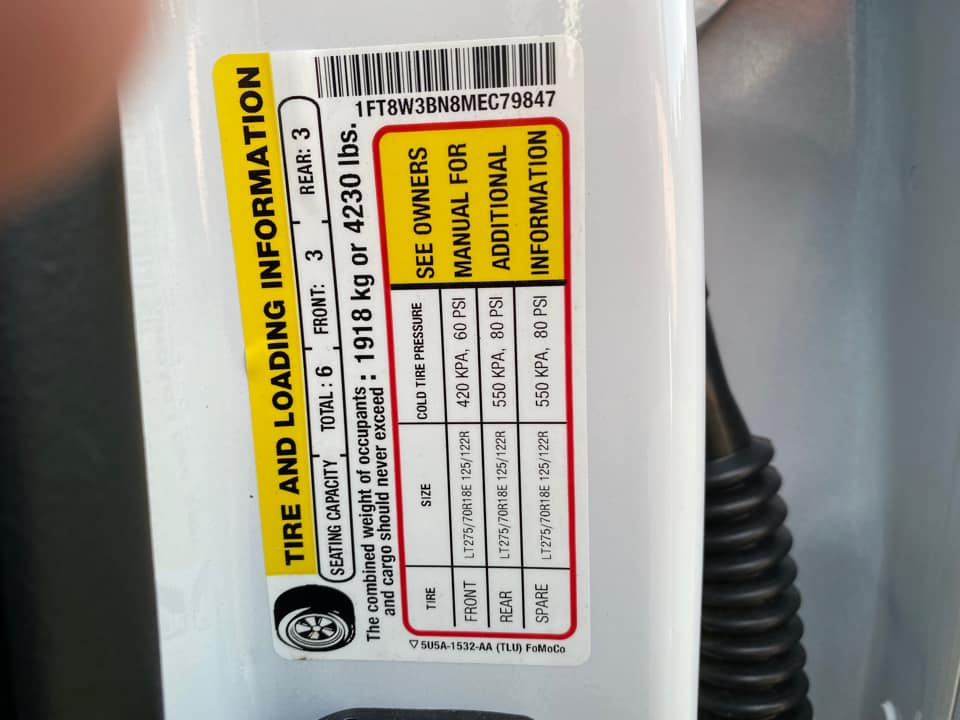

I just saw this posted, so yours being a King Ranch will be less. Might want to consider a DRW (about $1200 more?) with a 3000lb plus pin weight.:
"2021 F-350, CC, SRW, 4X4, STX package, 7.3 gas, 11,900 GVW, snowplow / camper package"
