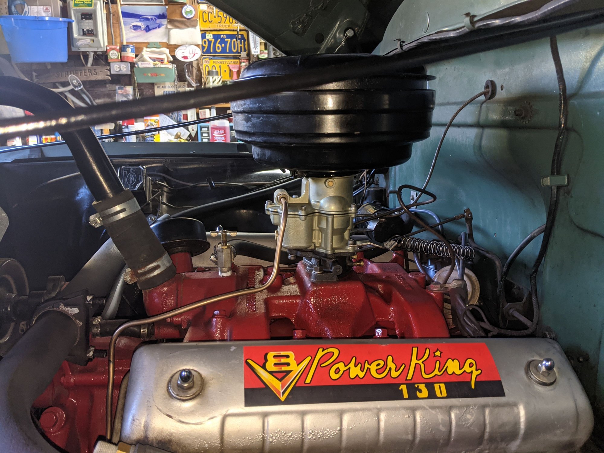

I bought a rebuilt carb from Cowboy John two weeks ago. He said he's busy. He doesn't have rebuilt Holley 2 barrel carbs sitting on a shelf. He rebuilds them as orders come in. He said it will take 4-5 weeks to get it to me. I got the mail today and there was a box. I asked my wife if she ordered something. I wasn't expecting anything. Then I see the return name of John Plaskan and almost leapt for joy. I took the box out to the garage and opened it.
It looks great. It is slightly different than my current Holley. But I don't think my current carb is original to the truck since it has an arm for dash pot that automatics had. See the pics
I almost put it on tonight but then I thought maybe I should put a phenolic spacer under it. What do you guys think? Do I need a spacer to prevent heat transfer?

Have you ever had an issue with carb heat sink and drivability issues with the truck before? Is there a reason why you think you need one, other than you think it couldn't hurt? You will need to replace the carb mounting studs with longer ones if you decide on the thicker spacer. And there's always that chance of breaking something when you start trying to remove old studs sitting in cast iron for 60+ years.

This past year the truck suffered vapor lock twice. However I really think my fuel line was too close to the crossover pipe. So I think I'll not get a spacer. And then I can put the carb on tomorrow morning and not wait for a spacer to arrive.

After waiting to buy a better gasket, I got the carb on today.
Two problems: the choke set up was a lot different. I just had to make sure I left enough cable to open and close the choke completely.
Problem #2: I had a hard time getting the vacuum line into the carb. Either the threads were messed up or different or the female end on the new carb was smaller. I called Cowboy John to ask what kind of thread the new carb has and what size it is. He thought all Ford carbs should have the same vacuum orafice. Luckily my vacuum line had a larger adapter on it. I took that off and the threaded male end easily screwed into the carb. So not all Ford carbs have the same vacuum opening.
I poured some gas in the carb, pulled the choke and it nearly started.... some more gas in the carb and this time it started and kept running. After it warmed up, I pushed the choke in and it idled very nice. I had planned on taking it out for a drive but my buddy who helped me with the vacuum fitting got to talking and it got dark. So that will have to wait until tomorrow.

I got the truck put today. It ran good. It ran strong. Not that it didn't run good before but I think it has more pep and does not hesitate at all.
