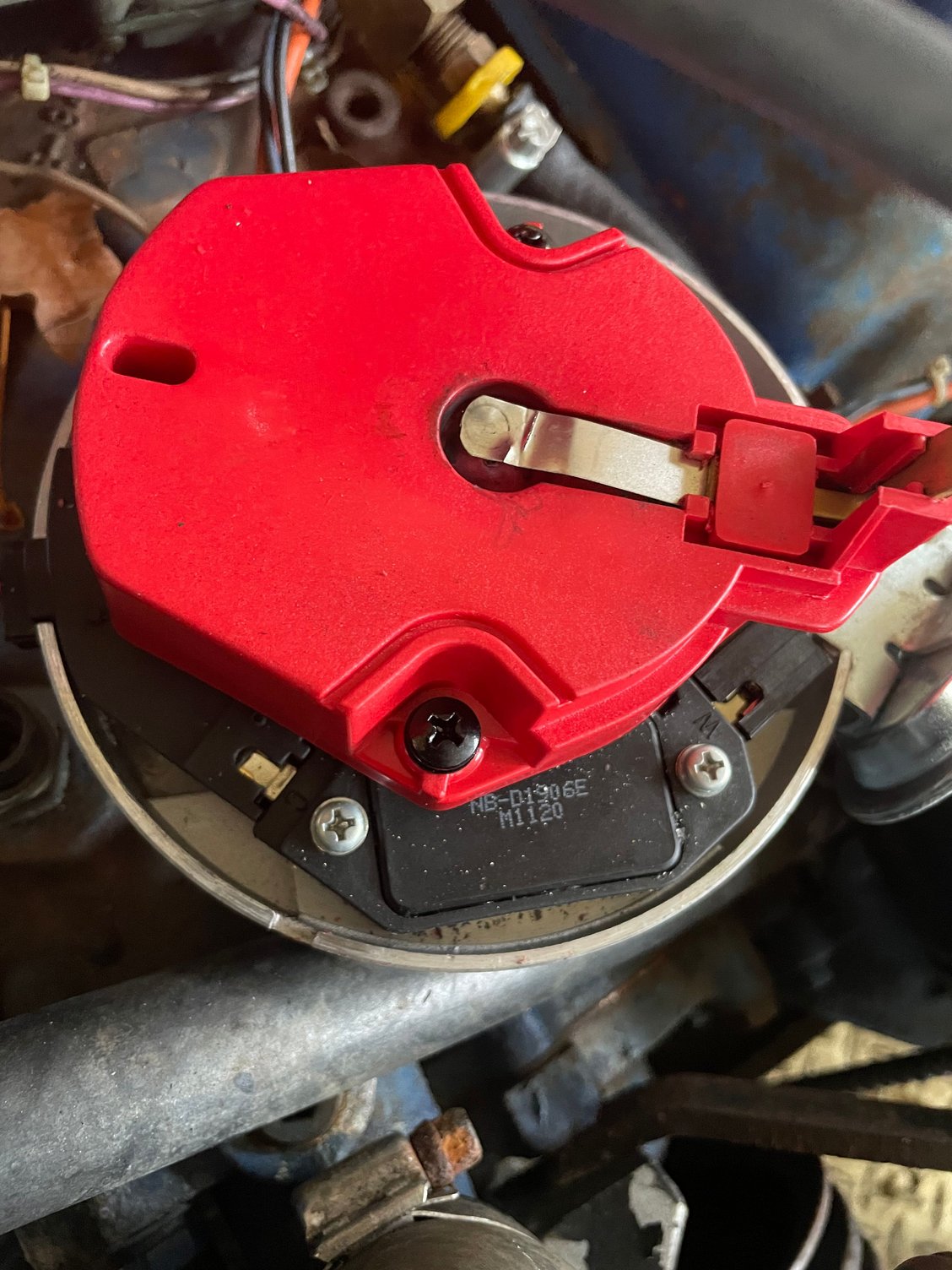

I have a 1980s 302 engine that I put a new distributor on and was running great it had probably 3 hours of good run time and then after that I couldn’t get it to fire I checked the distributor and found a bent rotor. I replaced the rotor and still am not getting a spark. Has anyone had a similar issue and found a solution? Thank you.
This is the old old one
New rotor same everything just different color

Take the module out and get it tested at the store. Here's a link with more info. https://www.gmcmi.com/wp-content/upl...EI-Testing.pdf

What bent the rotor? Is the "button" inside the cap intact?

Yes everything seems to be correct except for this

Why did you replace the distributor? Is the replacement an MSD? You probably have a new part that has already failed.
Looks like a HEI conversion distributor. Most likely the engine had one of Ford's early TFI units on it, and it was converted over to a regular ignition system to get rid of the computer.

Yes old distributor was junk.
