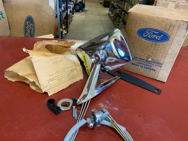

I don’t have access to the mirror right now but I found a pic of one on the internet.

Possibly 1969 Galaxie?
Found an NOS one on eBay. The seller says c9az-17696-b
Is there a passenger side equivalent for this mirror.
Item # 373239333364

I have the 1965-72 Ford Car MPC and it doesn't look like there was one offered for the passengers side. On eBay I did find someone selling a used pair but they don't match each other like I would expect. The drivers side has rounded corners like the other one you posted from eBay while the passengers side has more squared off corners.
1969 69 Ford Galaxie Side View Remote Mirror Driver Side And Passenger Side. | eBay
Galaxie is an A code and the remote drivers side mirror is a Type 5.
