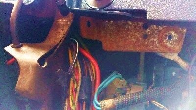

I don't know about your truck, but my '87 has two ground wires at the rear of the fuse box that tend to rust. Those were moved in later years to I believe is behind the right and left kick panels, close to the floor.
Here are two pictures of mine as I was cleaning those grounds. There are also one or two on the radiator support next to the passenger headlight, one under the hood, close to the heater box, and I think one on the drivers side.
