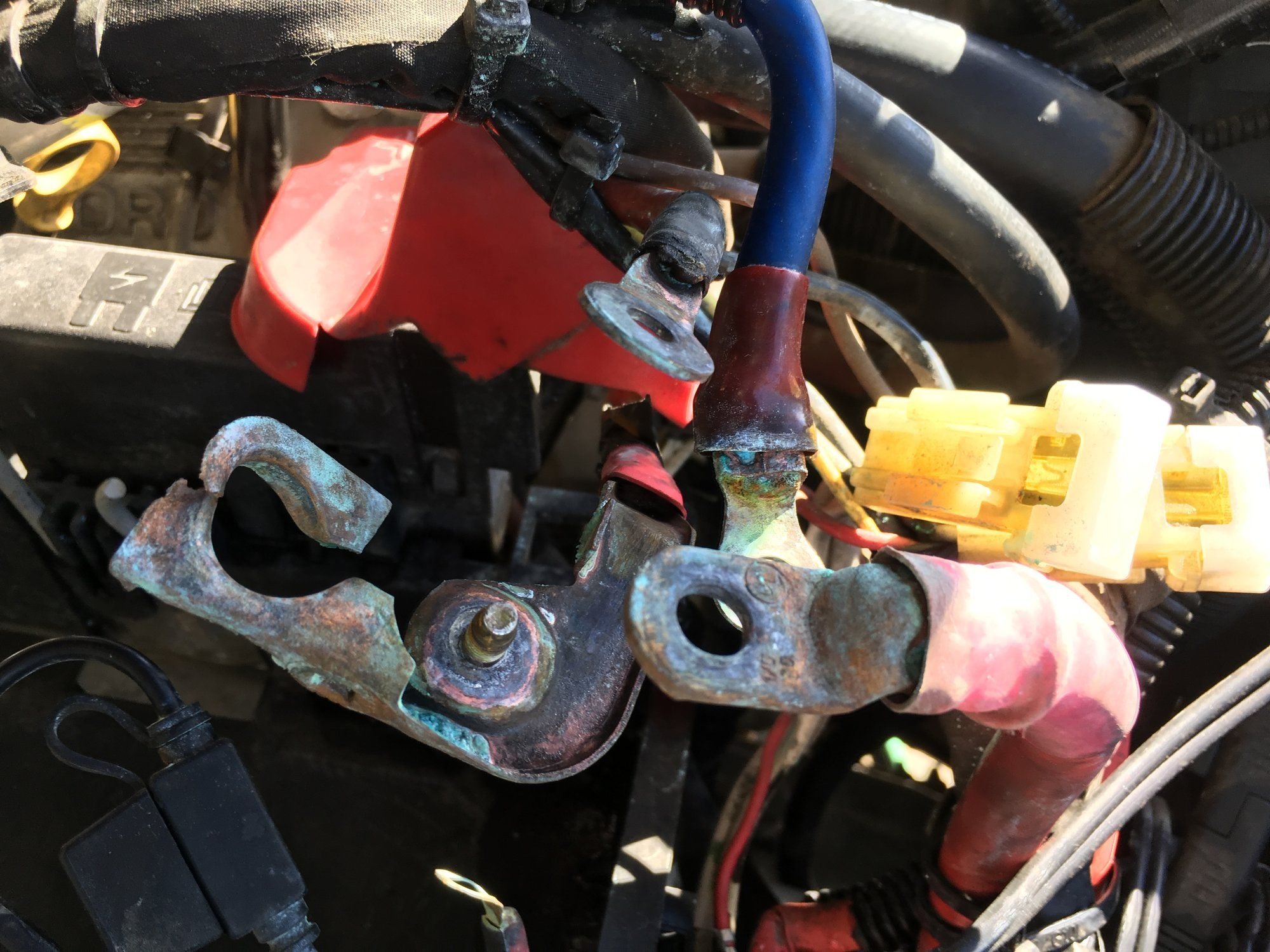

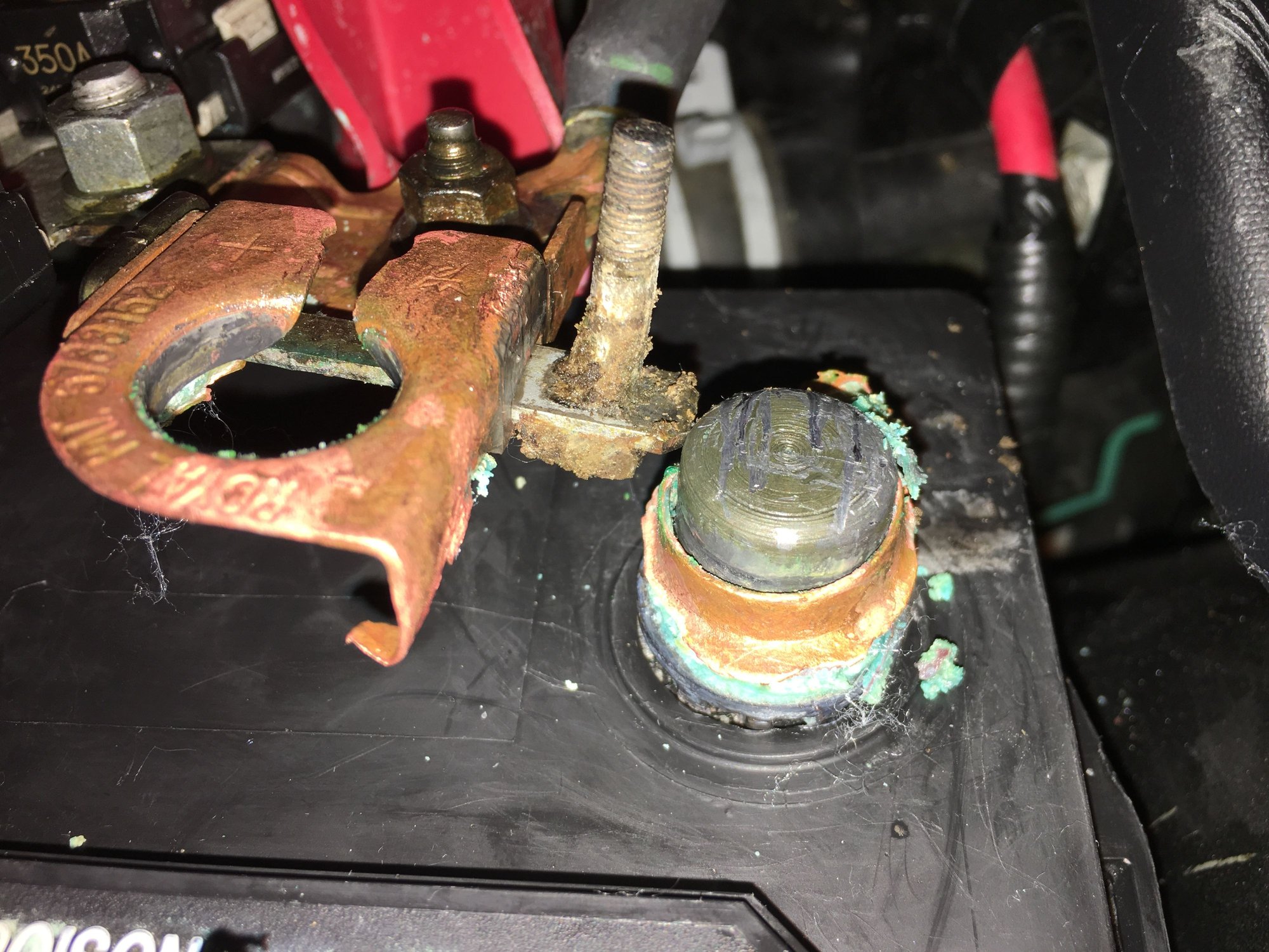

When you guys say post leakage, I assume thats leakage around the posts themselves? My current 2018 motorcraft batteries don't leak there, but they do seep from the vent caps. Its seems every battery I've owned seeped some from the vents caps.

Put some grease on those terminals. My uncle turned me on to that with car batteries many years ago and i've never had corrosion problems since. Use the axle grease out of the grease gun, cover the post and I smear a thick layer there where post meets the case to (in my mind) seal it up. Little extra on top of post and clamp once tightened in place and life is good. All that being said those pics are some crazy looking corrosion so may not stop that all the way.

Its none of our vehicles........

I had moisture across 80% of the top of each battery coming from the vent caps. The drivers side positive post was as bad as the pictures Jack posted, and even the drivers side negative post had a small amount.
