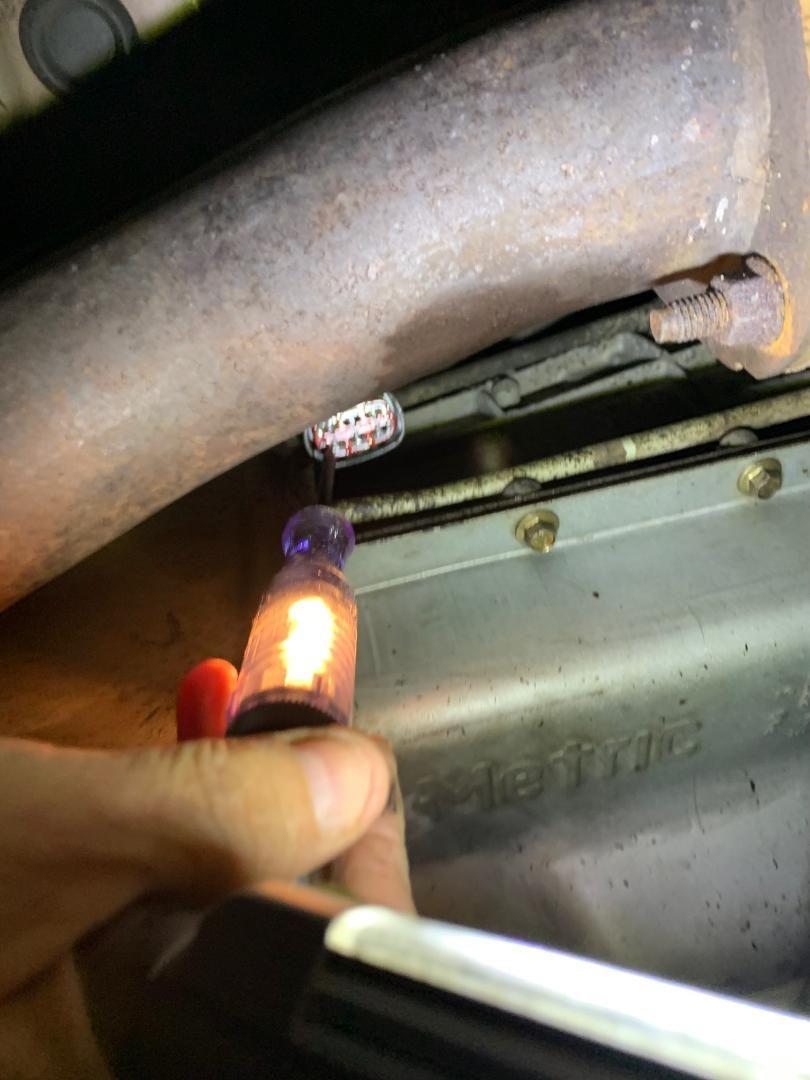

I checked that 3-4 weeks ago. Pins 1 & 12 on the solenoid pack connector both had 12 volts. There is no grounds other than what the PCM supplies to each solenoid as I read it. Unless the 12 V is some kind of week/ no current supply. I will test it with a bulb to affirm it actually can supply some current.

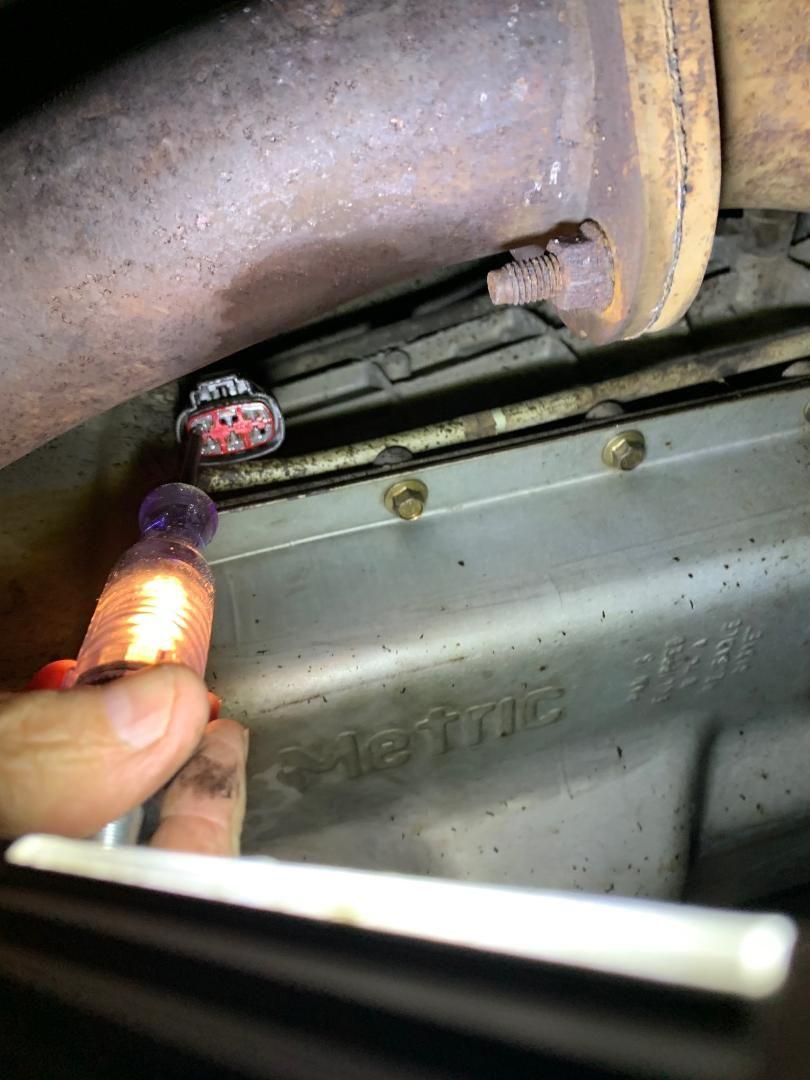

I went out tonight and unplugged the trans connector to the solenoid pack, turned the key on and used a test light on pins 1 & 12. This affirms power and current flow when lighting the bulb. I also measured again and had standing static DC volts of 12.3V. I guess next step is to check the supplied signal from the PCM at the connector pin for Shift solenoid1 is truly a ground with key on and plug unplugged.

Pushing a probe into the end of the connector can spread the pins, creating a problem where you didn't have one before. Hopefully you didn't spread any of them,

the probe is pretty big, I just had to lay it in the opening.
