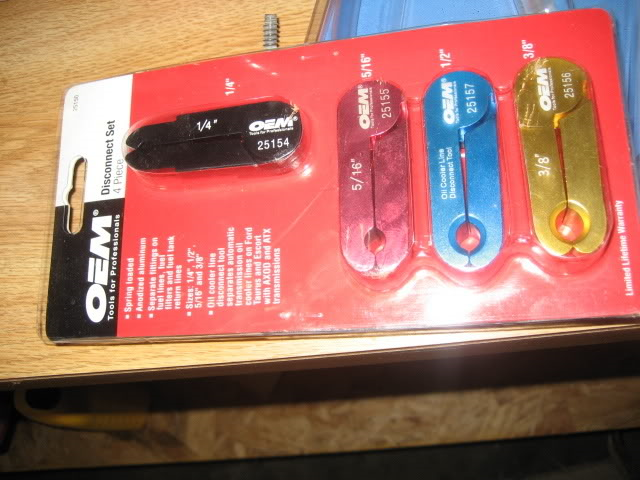

Me struggling
Old Oct 29, 2021 | 03:43 PM
Conanski's Avatar
Conanski
Joined: Jun 2006
Posts: 31,930
Likes: 1,499
From: Ottawa, Ontario
You need a different tool that one isn't going deep enough. The plastic versions have worked fine for me..

I have found that these tools work well together for the fuel line removal.
Attachment 279154
