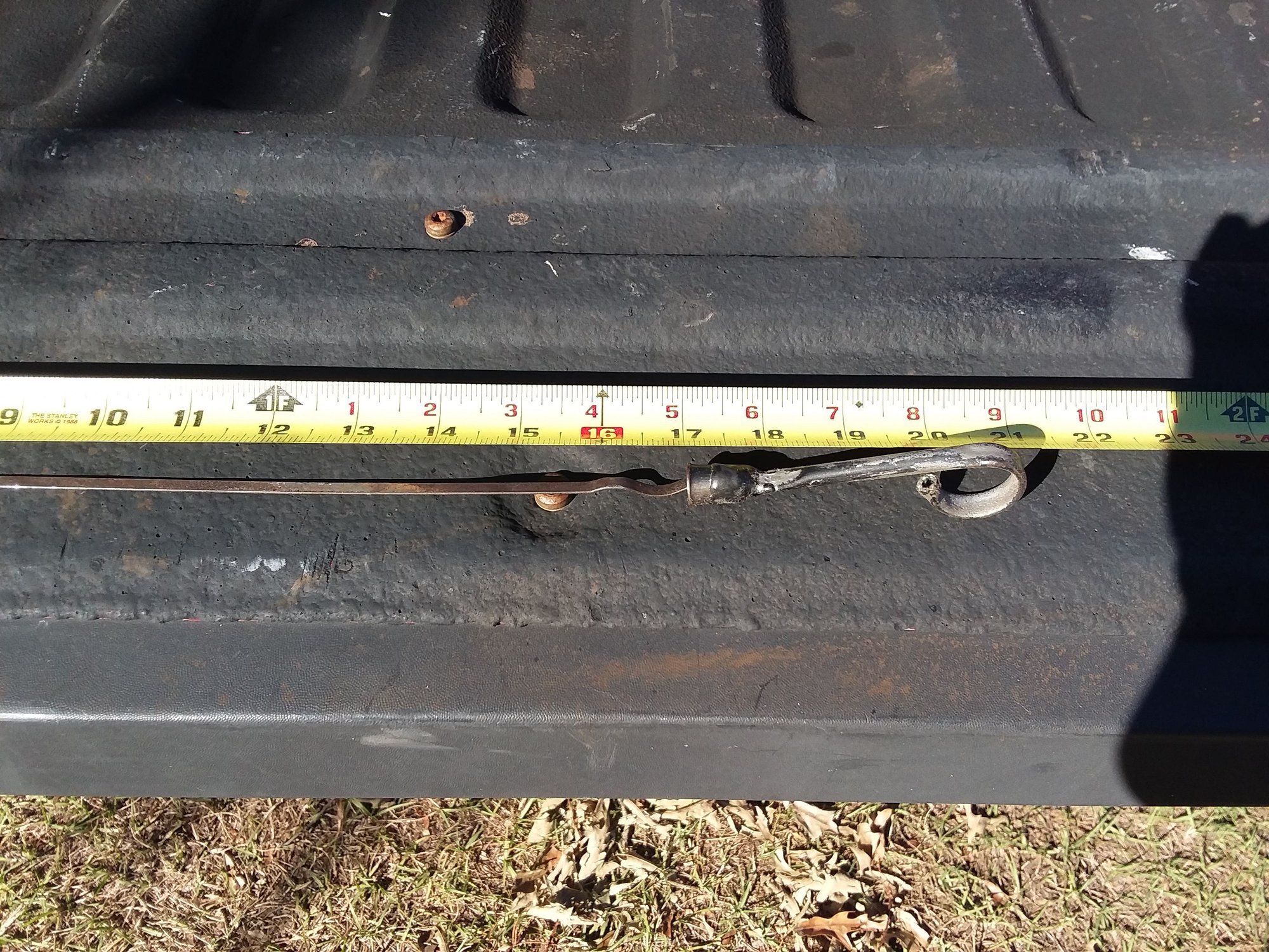

Our 78 has dipstick D7TE-6750-DA
It has a rear sump 4wd pan and I bet that makes a difference. I'm sure someone will verify.
We actually replaced it with a universal one that we made fit, because the original wouldn't stay snug in the tube.
I'll get some measurements for you tomorrow evening.
I would scribe a line for one quart low, add the 6th and scribe a line for "full".
