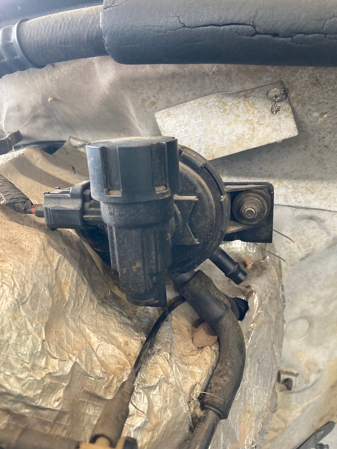

We got the old engine pulled without much fanfare. I did break a vacuum nipple on this thing. What is it?

I think that is the canister purge solenoid.

Vapor Management Valve (VMV). A 1996 F150/Bronco does not have a Canister Purge valve (CANP). It's a one year only item for this vintage truck 1996 (OBD-II). Yes it provides the same functionality but you cannot swap one for the other.

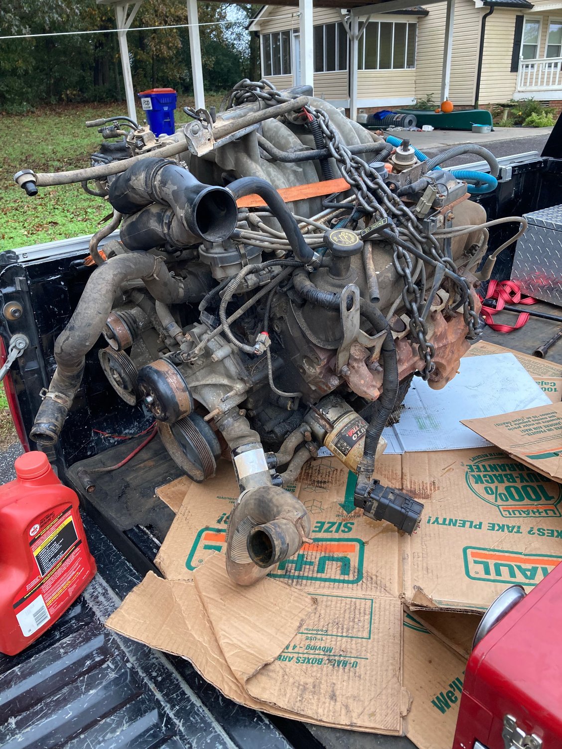

Unless that engine came from Cali, isn't that 5.0?

Looks 351W to me due to the oil cooler. Upper runners pretty skinny too.
