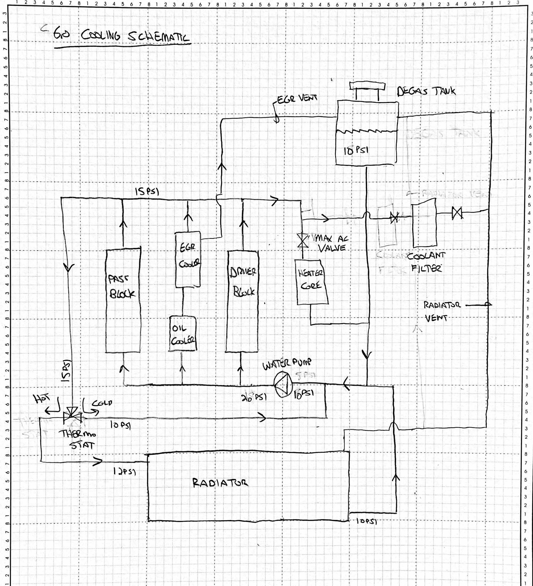

I did a basic hand schematic of the 6.0 cooling system a while back, see below. The oil cooler is controlled in parallel with the engine block by the thermostat. The heater core is a separate loop that is not controlled by the thermostat. I could see under low ambient/low load conditions the oil temp dropping, especially if you have a clean oil cooler and EGR delete and can possibly get more flow than the stock configuration. However I would assume you'd see an accompanying ECT drop which kind of surprises me.
I'll have to watch mine more closely this winter.
