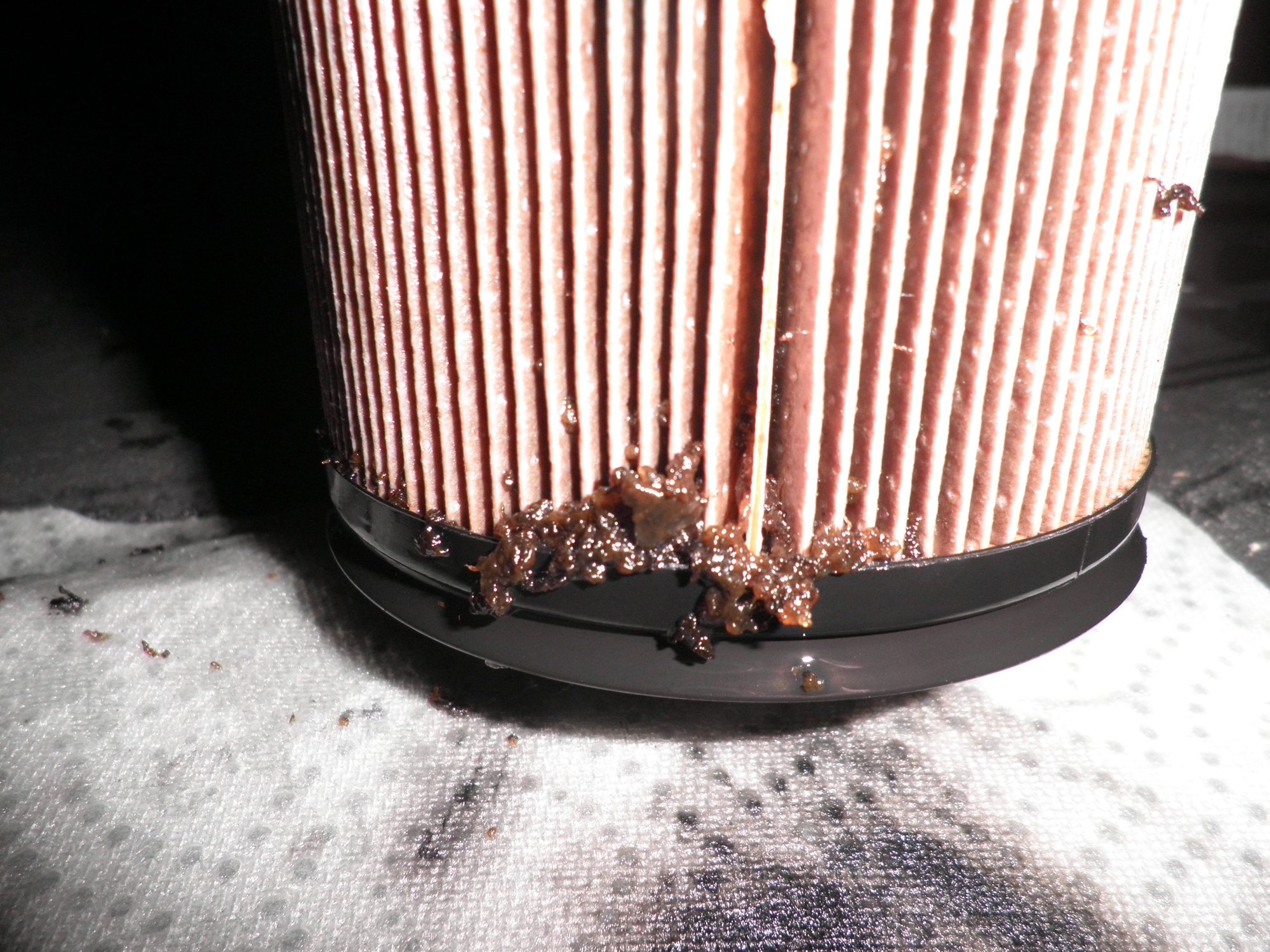

The attached PDF is my source of the 15k interval but this document is old and was issued near the beginning of KTP building the 2011 job 1 trucks. I chose to follow special duty for fuel, likely based on recommendations on FTE.
Also attached is fuel trash example which is why your results may vary and make within spec decisions you feel is best for your vehicle.

What is in that filter? I think I am going to just stick with the 10k filter changes. Makes it easy for me. I change my oil every 10k and my oil filter every 5k.
Some sort of algae was my assumption but I eventually narrowed it to a specific Shell station I was using a lot years ago so I avoid that station (problem went away completely). That station has good turn over but their tanks are full of crap and use mesh fencing for pump filters I guess.
