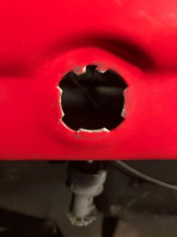

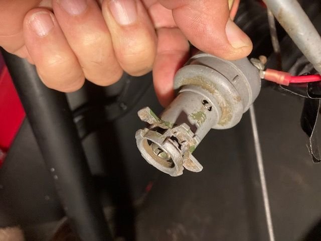

I think the reason my ignition lock fits loosely in the dash hole is because it's missing some kind of "wavey washer" . DC shows a picture of a new lock with a wavey looking washer. He gets $65 for these. Does anybody know if I can buy just the wavey washer and add it to my lock? Anybody know of a backyard fix for this? I think my bezel is ok.
Thanks,
Jim

Most hardware stores sell the wave washers in various sizes. One is bound to work.
